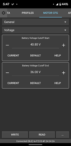

Do these cutoffs look right for 12s:

They’re perfectly fine cutoff values, that’s exactly how i set mine up.

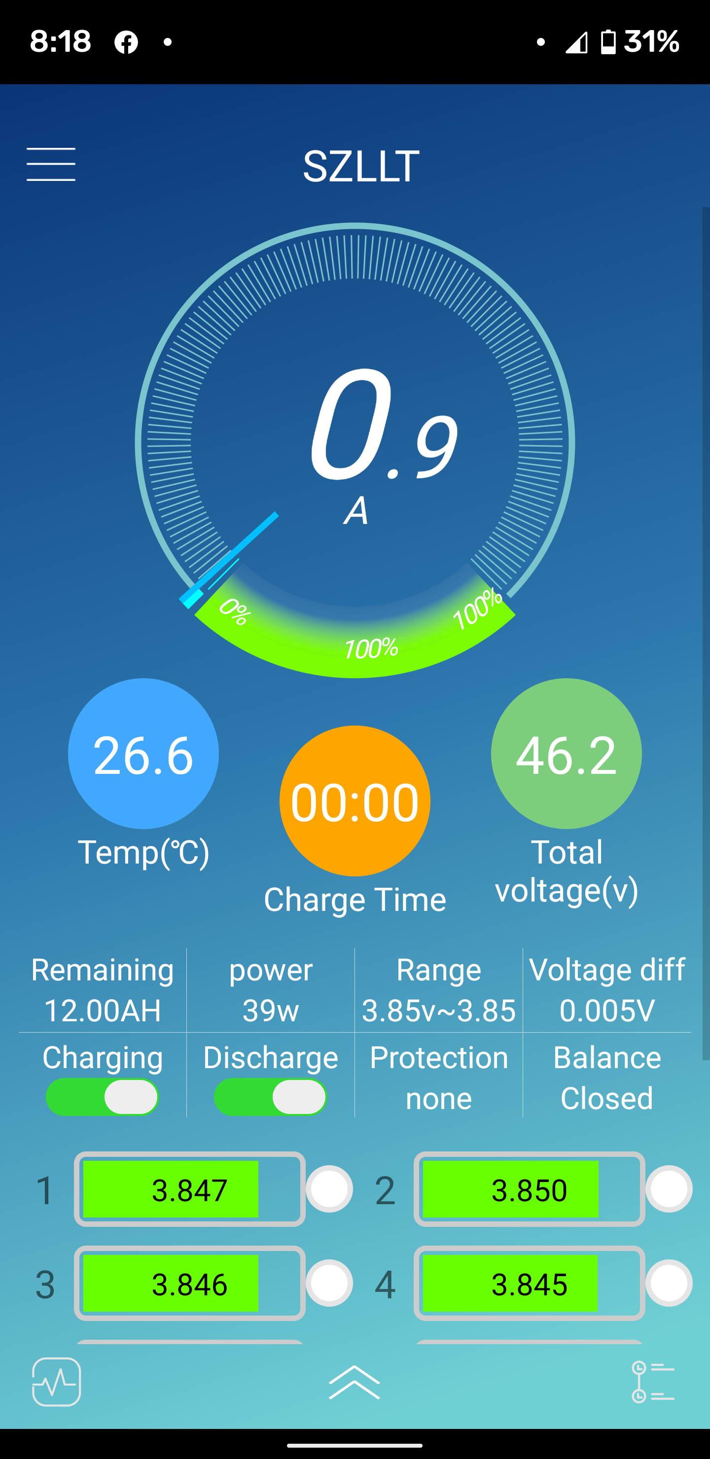

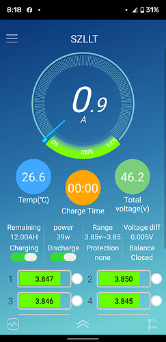

I have a BMS but I’m not sure how smart it is. It almost always says 100%12AH remaining no matter what the voltage is:
But maybe that’s normal for a BMS with bypassed discharge.

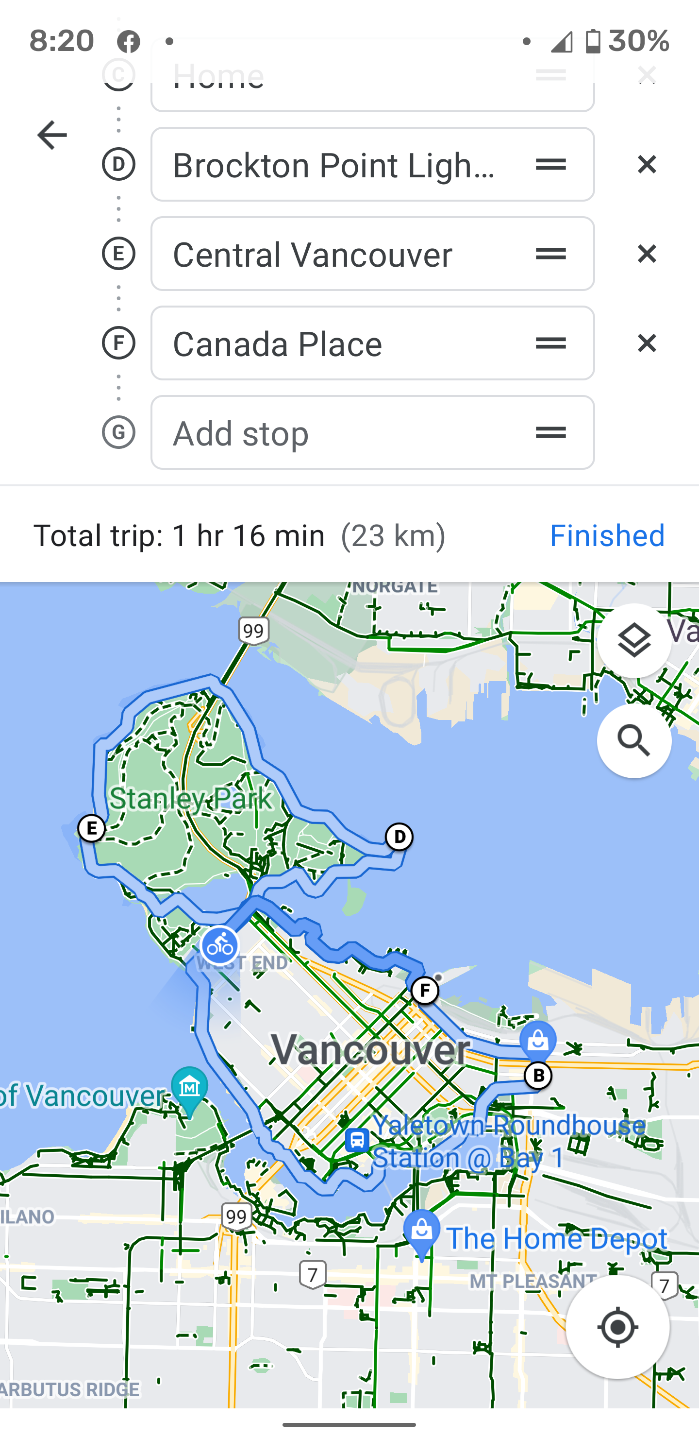

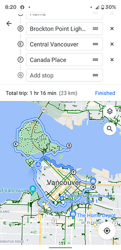

This is the 23km ride I did yesterday that flattened my battery
I feel like I could have gone twice as far four months ago when the board was new.
Some of that would be because I was riding grandma style when it was new and the DKPs were scaring me. This time I was on RKP and going flat out uphill at times.
Well yeah since the discharge is bypassed there’s no way for it to tell hour much current has traveled through it
It’s the same on mine

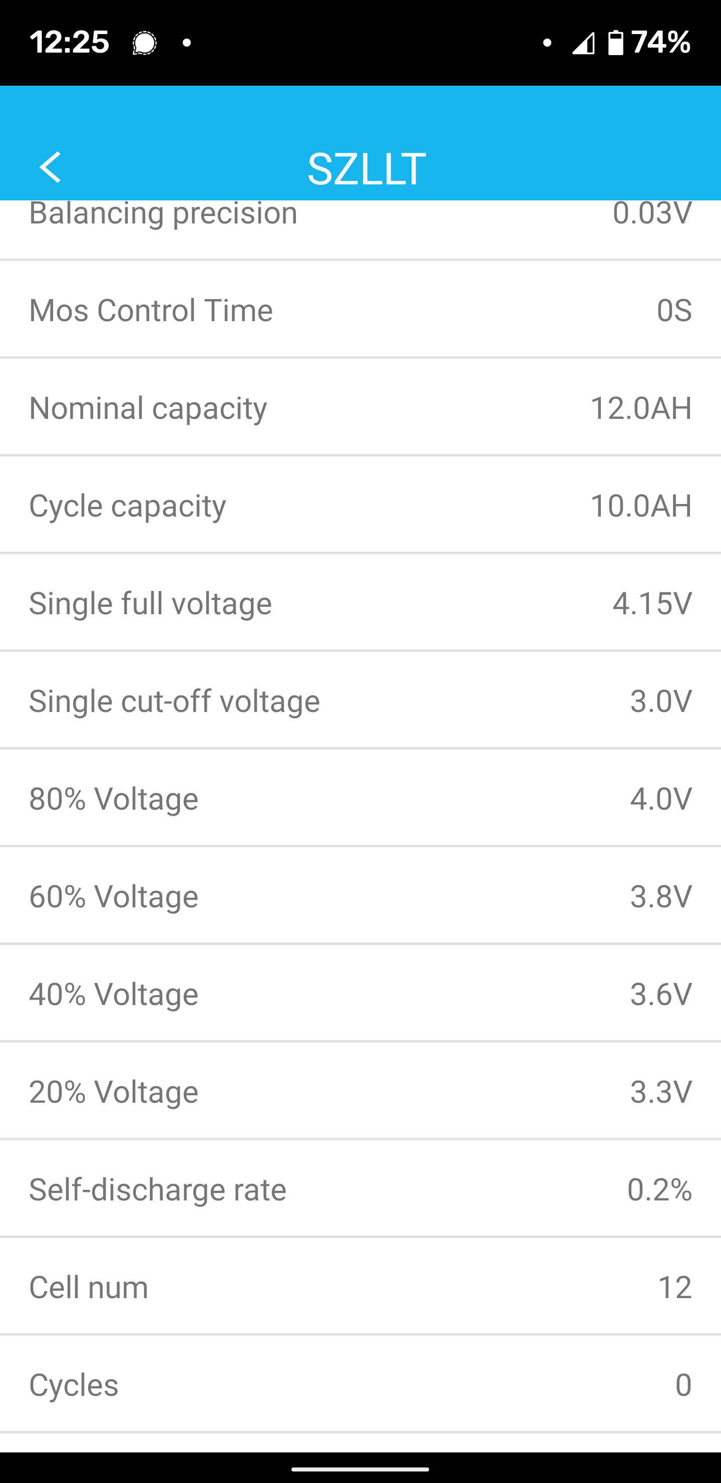

Is it a 12ah battery?
That bms allows you to program the expected capacity of the battery so you can tune the readings to accurately represent your remaining capacity. I would say that you might not have it set correctly.
Riding harder would definitely take a toll. From what i can see in that screen shot, your battery is well balanced, so there’s probably not a great deal to be concerned about there.

It’s a “12s3p 40T Battery” so I believe it is 12AH yes.
This is where I set it to 12AH in the BMS settings:

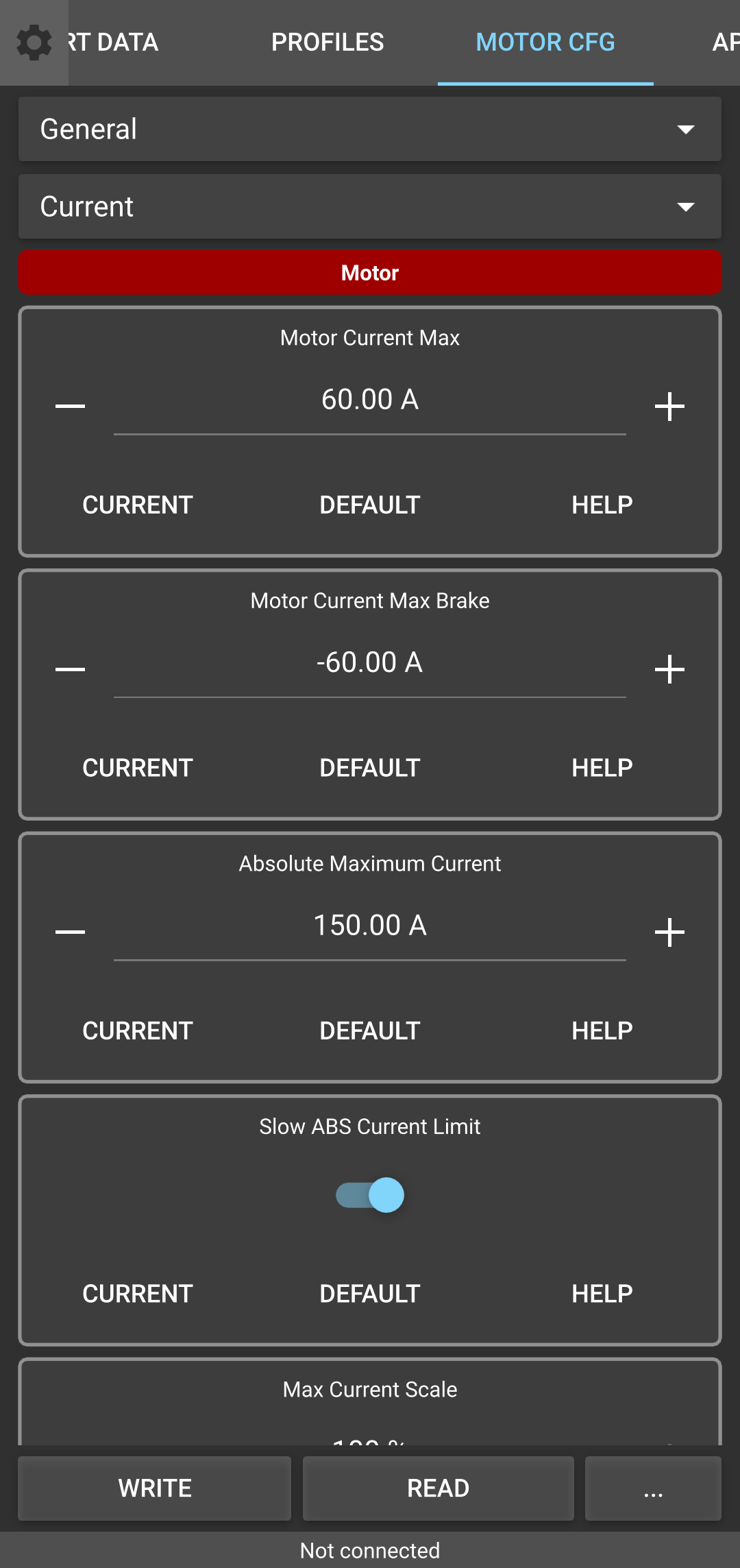

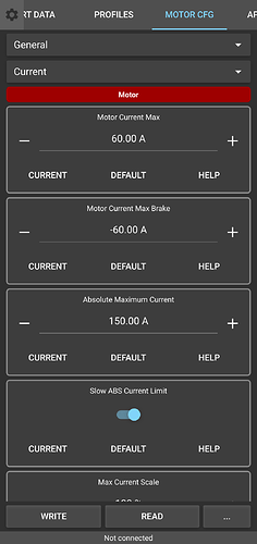

I have seen this as well (not using unity though). If i remember correctly the issue disappeared for me when I lowered the duty cycle max to 90% or below.
I’ll try that,though for now it’s working ok after having reflashed the fw. Thanks for chipping in :+1:
oh, also realised I changed the duty cycle to 85% following the VESC guide tat Trampa made, so it’s highly possible that fixed it too
Duty Cycle Maximum is NOT the same thing as Duty Cycle Current Limit Start
ahh ok, well i havent done that then. I’ll try setting the duty cycle max to 90% then too. thanks for pointing out that they’re not the same
