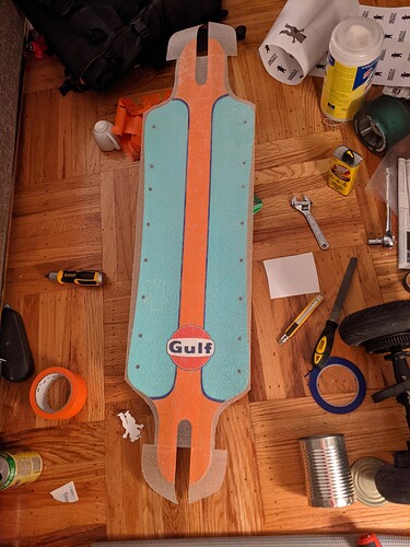

I need everybody to look at my Gulf GT40 livery but I don’t have my own thread so I’m posting it here.
The frosted grip tape hides my paint crimes nicely.
Need to buy a sharp blade for my knife before I trim it tomorrow.

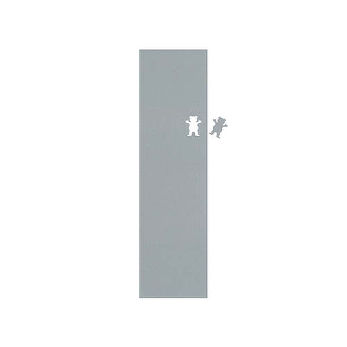

What kind of frosted grip is it?
I tried one kind and it was the shittiest shit on the planet, then I tried MOB clear grip and it was so much better then whatever I used the first time, that I just continued to buy MOB, scared of getting anything like whatever the first kind was.
Don’t know if it’s any good it’s just just what the local skate shop had.

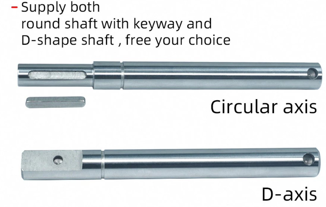

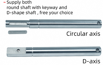

Do I want an 8mm round shaft or a 10mm D shaft on flipsky motors?
There are many more pulleys available for shafts with keyways, and most gear drives demand an 8mm shaft. So go with the 8mm round one :+1:
