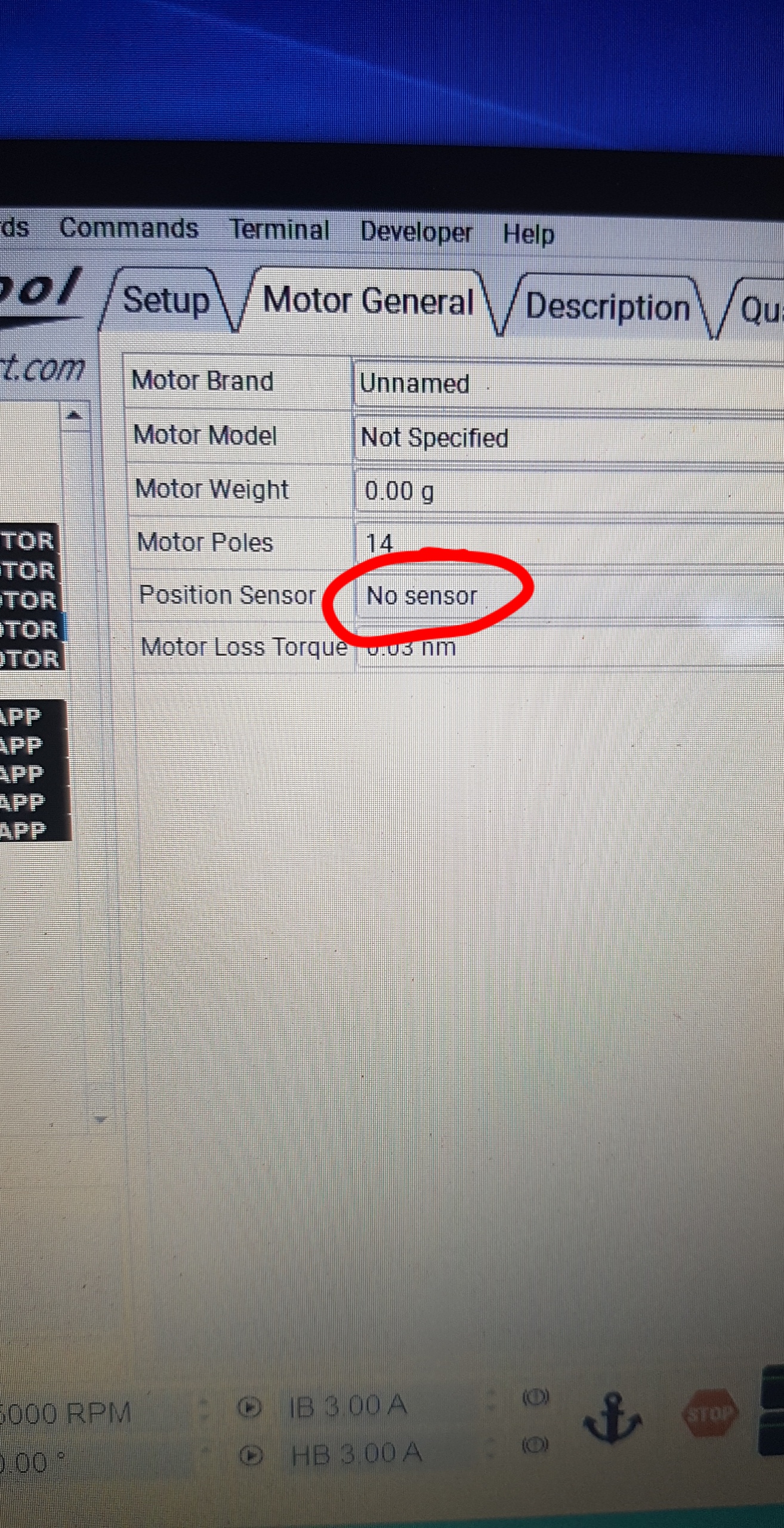

should i change this? it was like this by default and i use sensors
Do the motor detection and pick “sensored”
ye i just did it but the result back still says “sensorless”
both motors or just 1?
Rerun detection
just 1
swap em around and redo detection. See if the same motor comes up again as sensorless.
