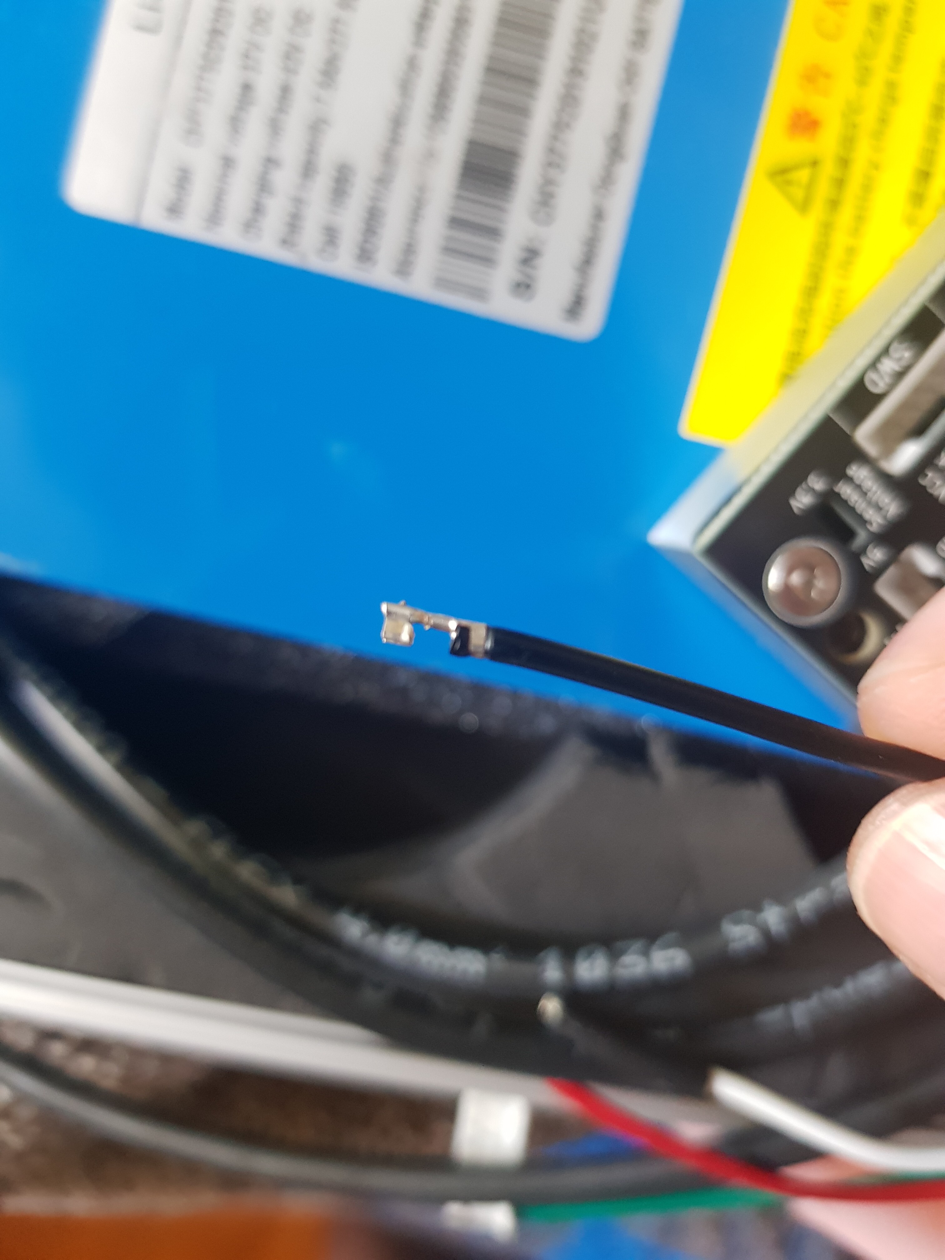

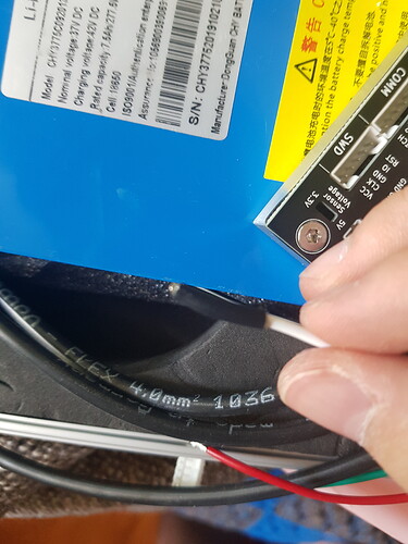

how do you deck mount a battery?
it came with these tiny connectors so i put heatshrink around them, also where does the white and red cable from power switch go?
Those are for slotting into the jst ph connector
i dont have any jst connectors and it didnt say anywhere that you need to buy them separately tho
Buy them
Trampa won’t know what u r buying it for, why would they include that if it might be redundant to do so?
ok but anyway where does the white cable go? i assume its for second vesc?
Check the label on the switch and follow the diagram
