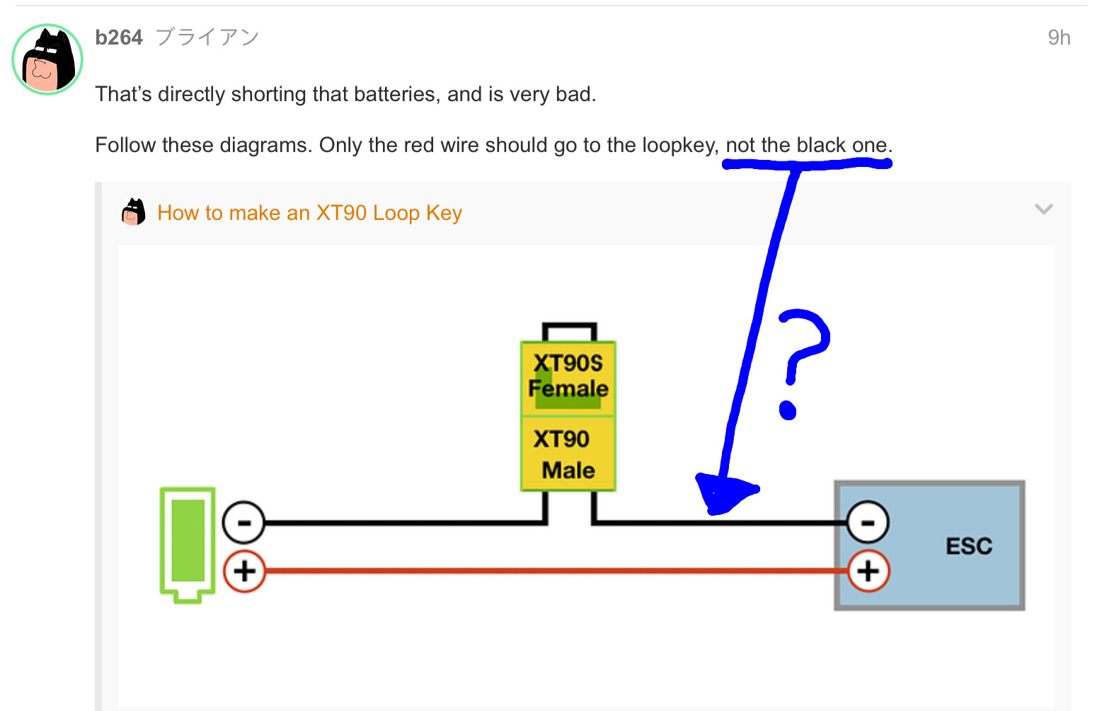

Out of curiosity, do you need/have to put it on positive? If so, I would like to know why, so I can see if I made that mistake of putting it on negative.
Edit: mine is on positive. Still would like to know though.
You don’t need to. It works either way. After deciding to add lights later using the BMS in a discharge and bypass simultaneously, you can find that it must be on positive for that to work.
There are minor reasons to put it on red.
Nice to know. When I decide to add lights on the battery, I’ll definitely remember that. Thanks.

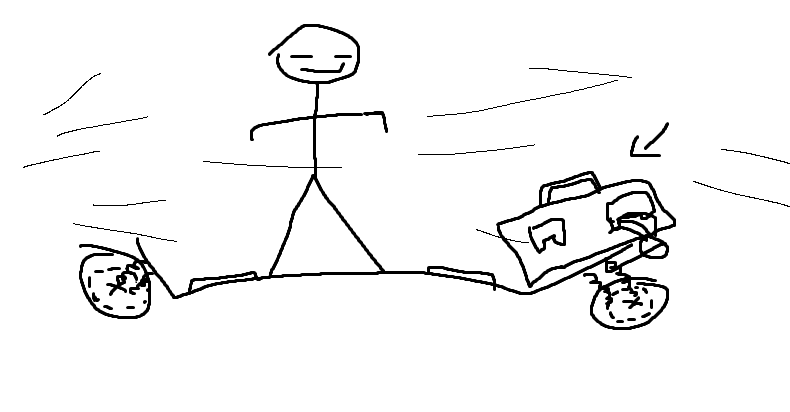

so you guys like behind the board enclosure boxes
  • yeaah
  • naah
  • not sure / don’t care
0 voters
You have a poll for a declarative statement? :thinking:
well you do have multiple choices if you dont like it

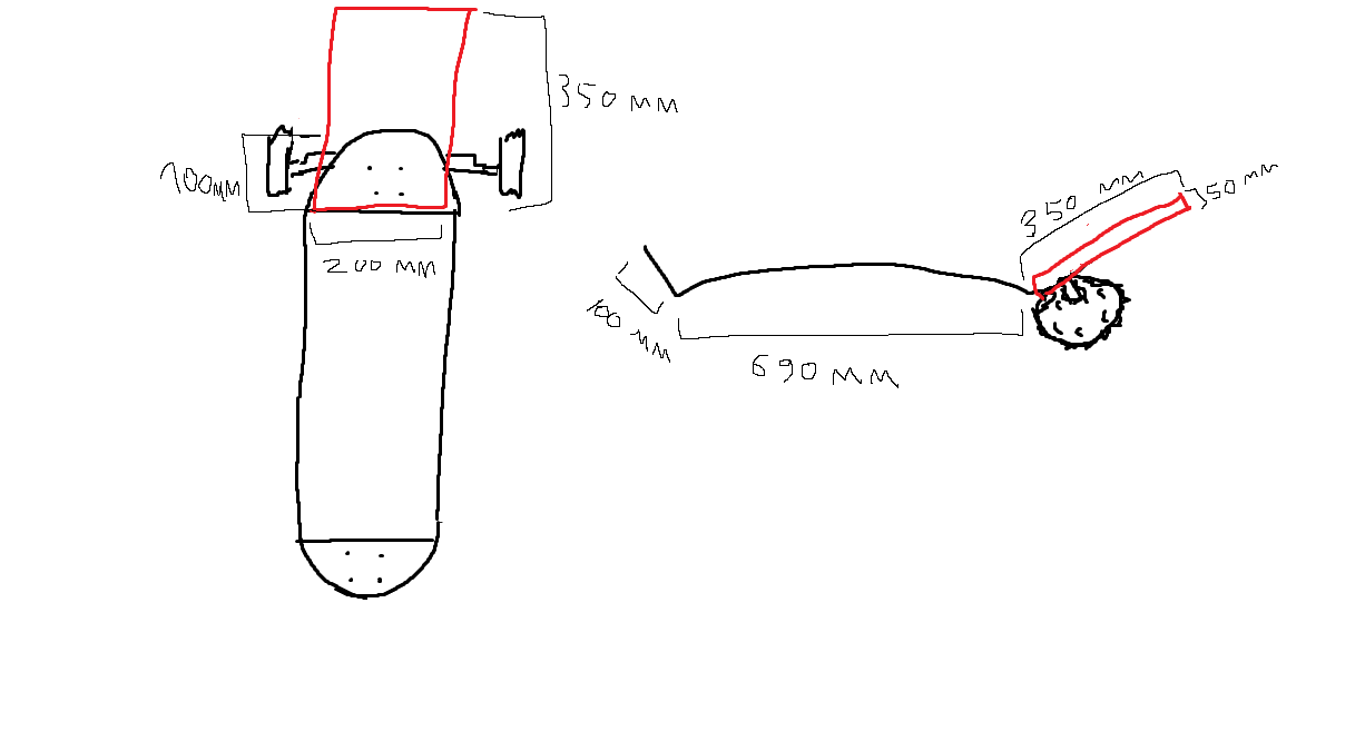

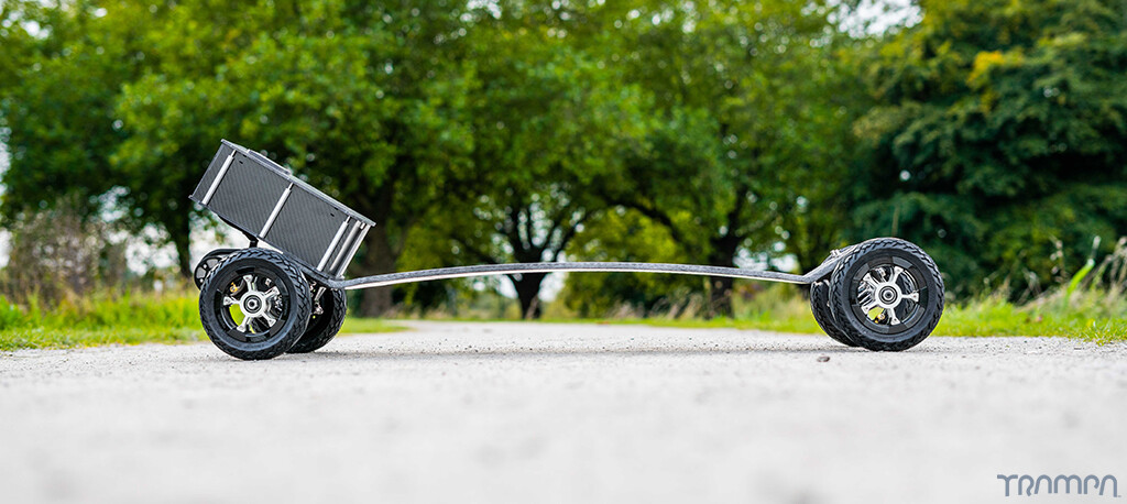

Uhh you may want to check your scaling on the box, can guarantee you it doesn’t look as well proportioned in person :smile:
For the record your battery is several inches longer than what’s on the board below.
gah dayoum thats some dump in the truck
after your feedback i have calculated that using a 50mm thick box would leave a more lowkey look to the board however the actual box itself is 3 times as long as they angled part of the deck meaning that it will stick out quite a bit, the other option would be to rotate it sideways but that could indeed also hit the pneumatic wheels
Lol these look absolutely absurd imo
I hate rear batt boxes
Also, surely it feels weird to ride? I get that you’d theoretically get more grip with the weight back there but I feel like steering would be weird.
