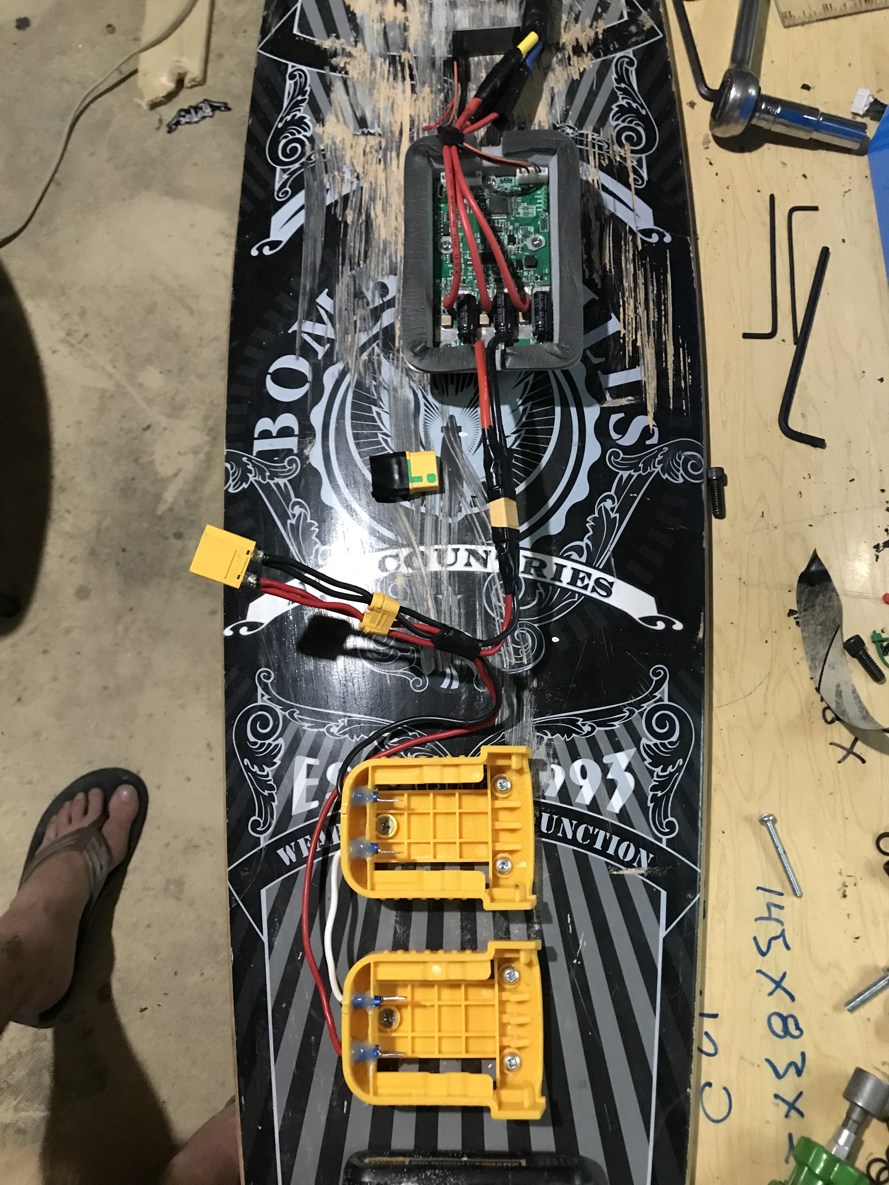

what more budget options are there for rear mounting 2 trampa vescs but making it look nice (roughly £100 max)
thanks
Got a 3d printer? Some people use those small pelican cases too (I’m assuming you’re planning on mounting them mtb style)
yep
in the end sent @trampa an email about switching the vesc6 to a vesc hd60 which should fit better

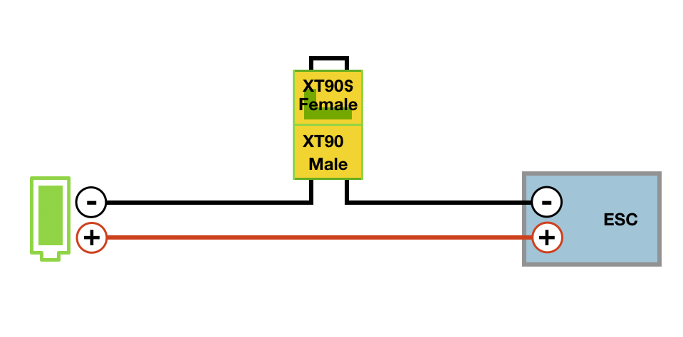

That’s directly shorting that batteries, and is very bad.
Follow these diagrams. Only the red wire should go to the loopkey, not the black one.
Thanks

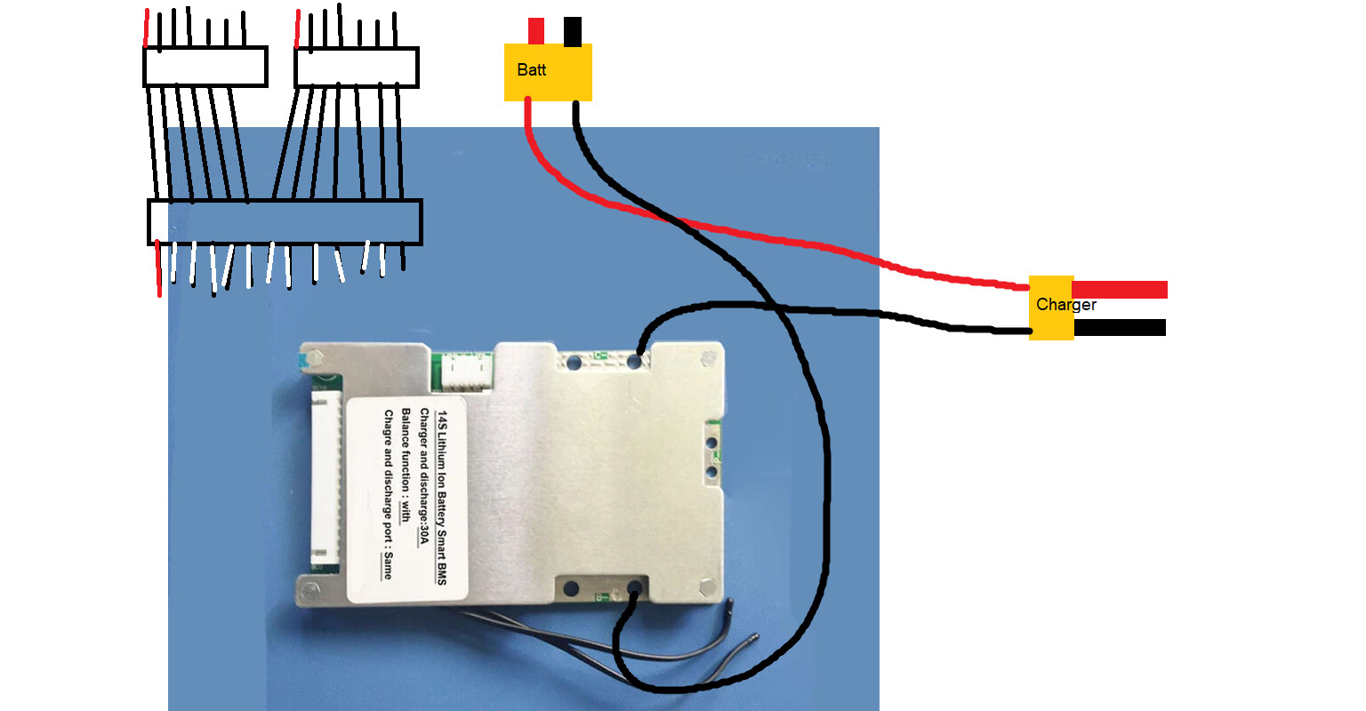

Is this wired correctly? External BMS charger for 2 6S batteries. Just want to double check before I get started soldering.
Yes, looks correct.
If those are temperature probes hanging off the BMS, tape them to the battery.

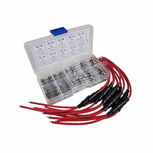

Bit of a followup question, has anyone tried this type of inline fuse? They’re much lower profile than the blade style ones, and seem to usually be 120V or 250V ones, vs. the blade ones which typically are for 12V systems unless you go specialized at digikey or somewhere. I would imagine the main downside is that they’re glass, but at the same time they’re well shrouded in the holder, so it shouldn’t be that easy to break. Seems like a good choice for a charge fuse, since most of the ones I see top out at 15A, while the blade style can go much higher.

i use those glass tube thingy in my board, they work and i haven’t have any blown, but they do get a bit warm when i was using a 5a fuse with a 4a charger, so maybe have a slightly bigger amp rating if u r going 5a+ charging, maybe 8a or 10a

I don’t trust those things. I feel like either the glass will crack from constant vibrations or that tiny wire will snap.

Also if you tape temperature probes to a battery, use polyimide (Kapton
) tape and make sure it’s not in a place where it’s going to get pinched while being under vibration.
The BMS is going to be attached to the charger, rather than the battery, so I’m not worried about vibrations or movement. Not too sure if it’s worth taping them on in this instance.
