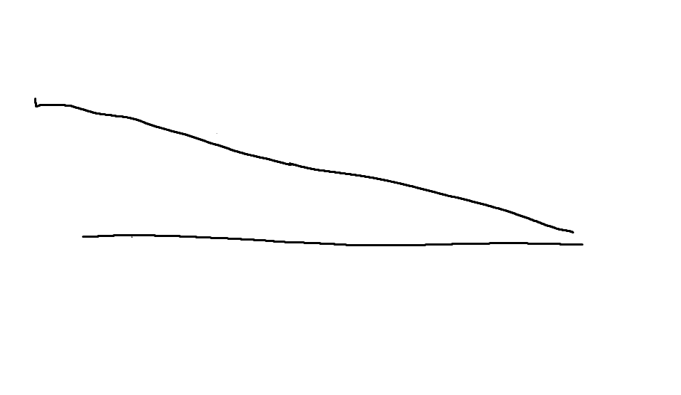

yeah but still it doesnt even get above ambient temperature i think the vesc is commiting fraud here
Hill grade? or you don’t know?
not sure but off the top of my head its about this
Looks about 15, 20% ish. Yeah it was gonna struggle a bit. But we’ll see if you decide to change the esc.
tbh it aint even struggling its straight up crawling, shocking stuff
