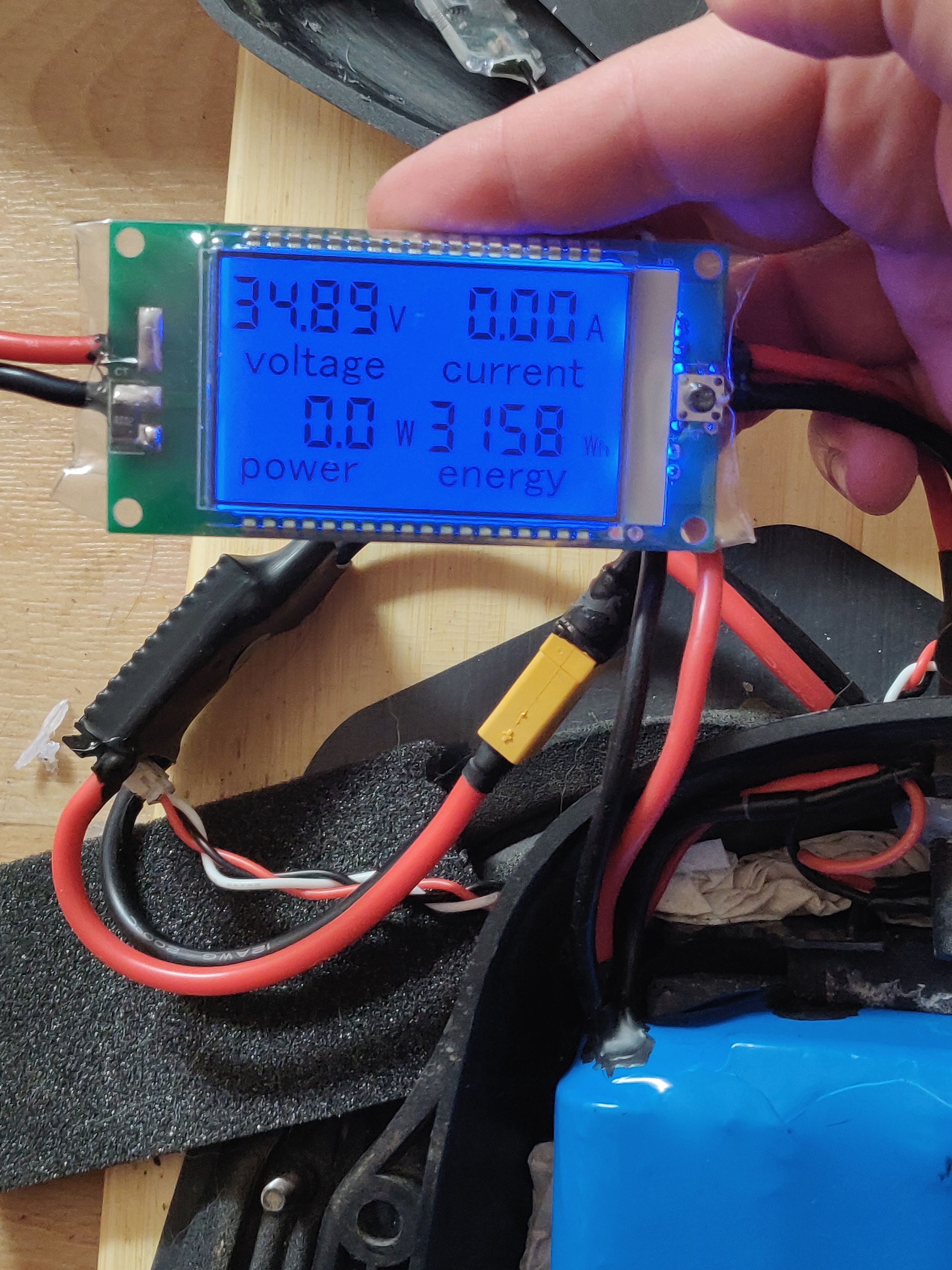

With only 3 cables (pwm) it just shows you the battery of the remote if you double tab the power button and not the board battery.
If you want to also see the battery of your board you need to solder that blue cable to the positive wire.

To get you moving. That’s the main purpose of a remote, not to tell you your rough battery status. For that we have telemetry devices or even dedicated battery meters.
I never bothered to hook the cable up. just wastes more energy lighting up the LEDS for something that isn’t super useful.

A battery level indication can be on the remote, on your 'droid, on a gauge on the board, or in your pocket.

No because as i said: for that we use telemtry devices or gauges.
