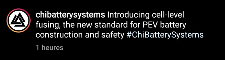

What is cell level fusing and why is it good?
Basically blows like a fuse and disconnects a cell if it pulls/pushes too much current. There is one on every individual cell, so the rest of the pack should still keep working (just quickly get out of balance)
There was a lot of hype about it long ago
https://electric-skateboard.builders/search?q=cell%20level%20fusing
I don’t think it’s used much outside of e-car, but I could be wrong.
Only tesla uses cell-level fusing as their pretty much the only ones with 18650/21700 and others use prismatic or pouch cells
