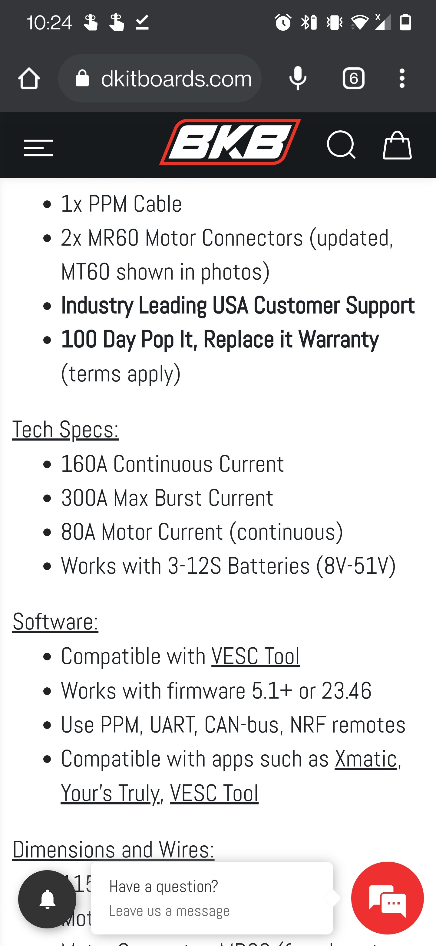

I’m kinda confused about the Xeniths specs; it had a max cts current of 160a, but it comes with 12awg wire and an xt60? I realize you’ll probably like never pull 160a, but could any one clarify how theses numbers work?

To be fair I think this means 160A combined motor current so it’s split between two sets of conductors and connectors for 80A each. That is going through MR60s, basically xt60s, so it’s still IMO not ideal but also not terrible and by my preference better than using 4/5.5mm bullets because of
I can’t seem to find claims for battery current, and for those I think you’re right that 12AWG and XT60 isn’t right. Especially XT60, because at least for the MRs you can’t get bigger combined 3-pin ones, whereas for the battery XT90 exists and is not a big ccost difference.
Maybe they’re relying on anyone who’s gonna really floor these things being willing to change connectors, but I would prefer 10AWG for at least some of the wires. Usual caveats: I haven’t done mountains of research for thie comment so pls correct me if I’m wrong

Max total in pairs is 160A, it means both can handle 80A each side. Which is why it says motor amp 80. Burst current is 150A each side, which is what the absolute max of the esc states (150A both side).
12awg can handle 80 amps just fine. MR60/XT60 can also handle those amps just fine as well (if you have a more powerful battery, I’m not 100% on that. It’s better to maybe make it 10awg and XT90). They’re not gonna make it if it’s over 120A since I believe that’s the limiting point (so I’ve heard. I believe it can do over 160A before melting).
Ahh I see, that clears things up; thanks guys :slight_smile:
