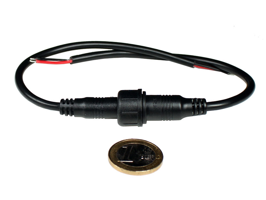

dc power jack has 3 pins on back 1 long and 2 short what is the purpose and should I wire
Send a photo of that
The one on the left in this image is likely positive. One of the other two is probably switched negative, and the other one probably unswitched negative. It’s likely you can connect those two together and to negative.
Don’t forget to fuse your charge port! On this one, I’d fuse the positive wire.

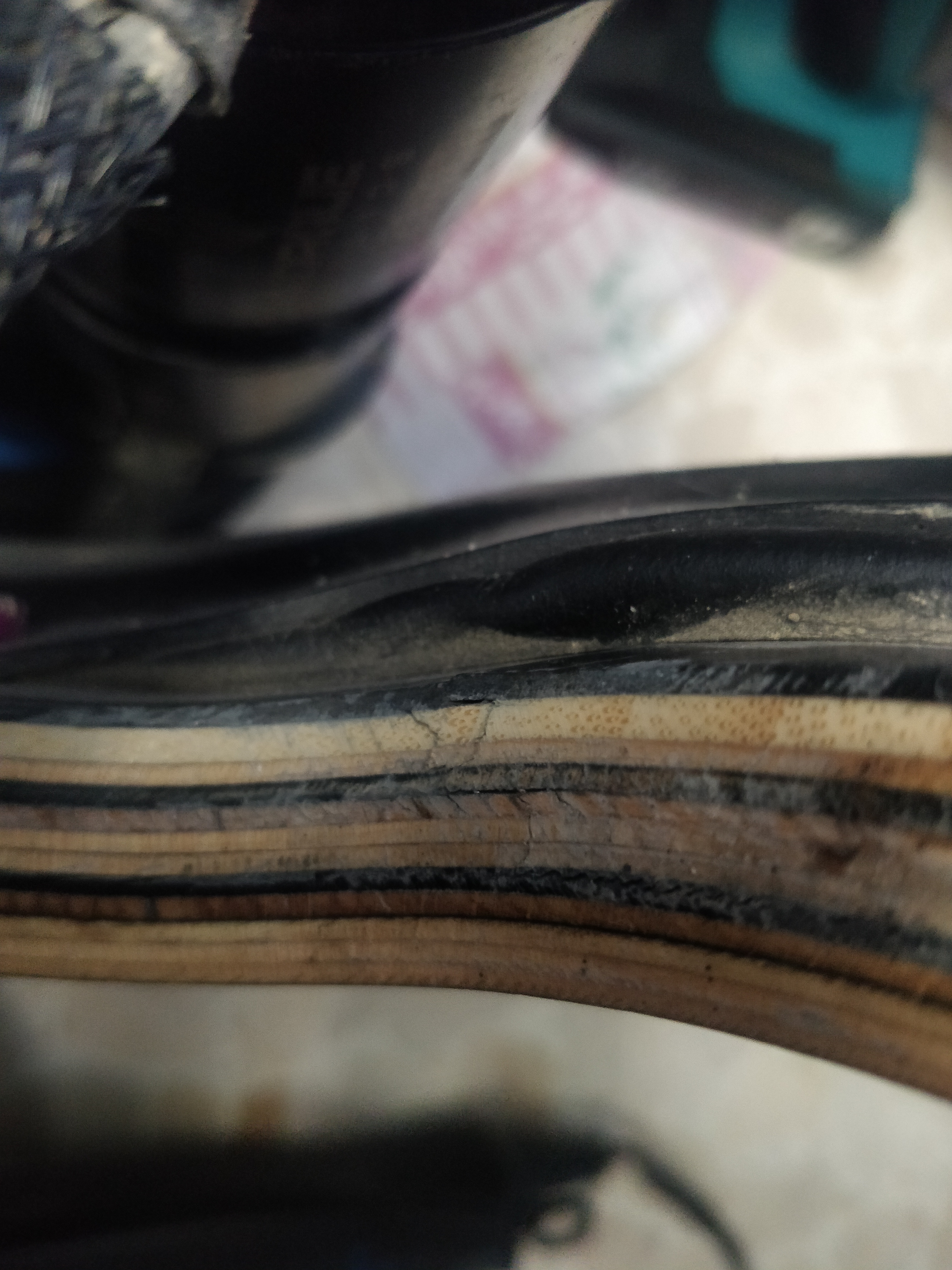

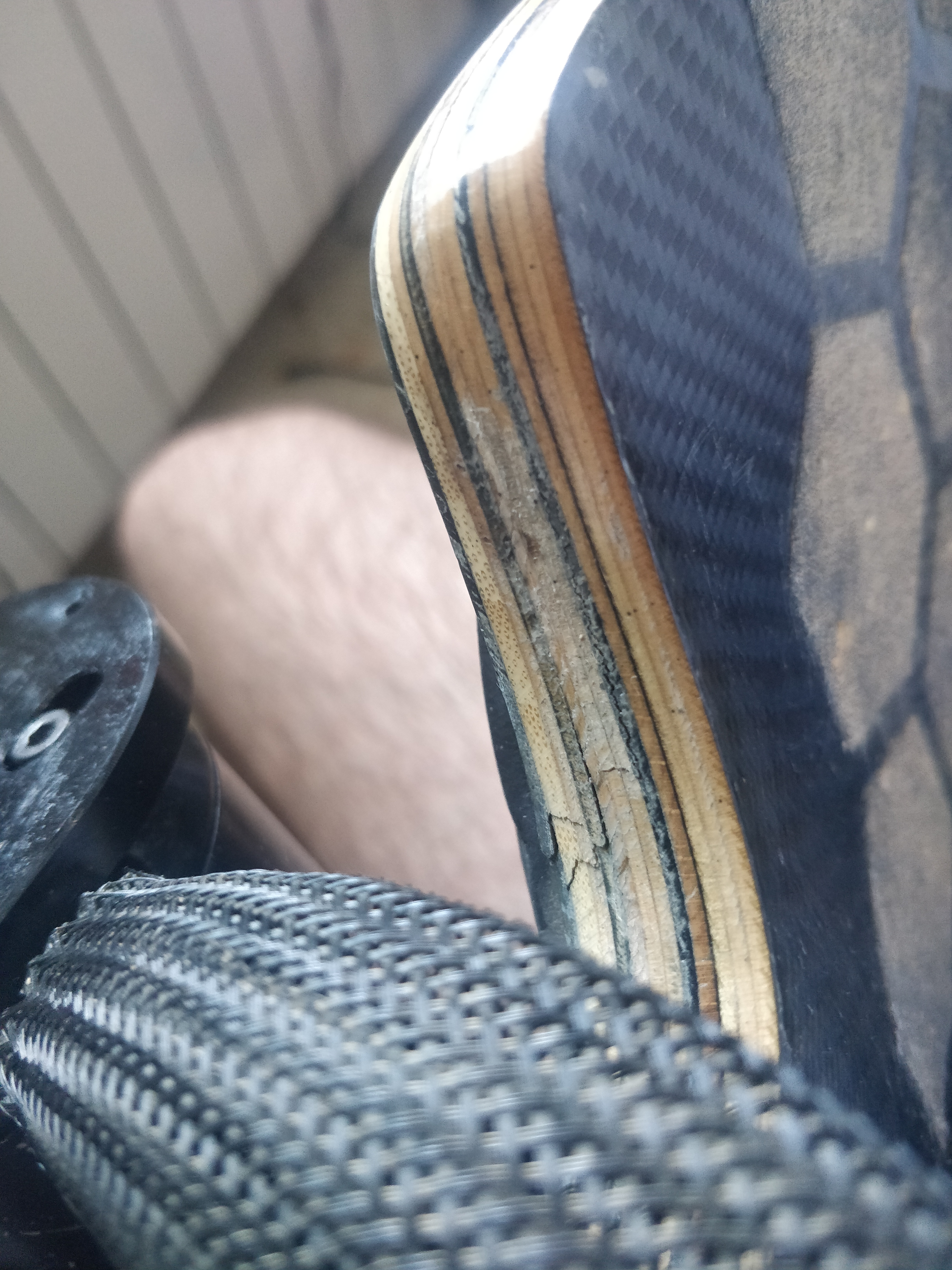

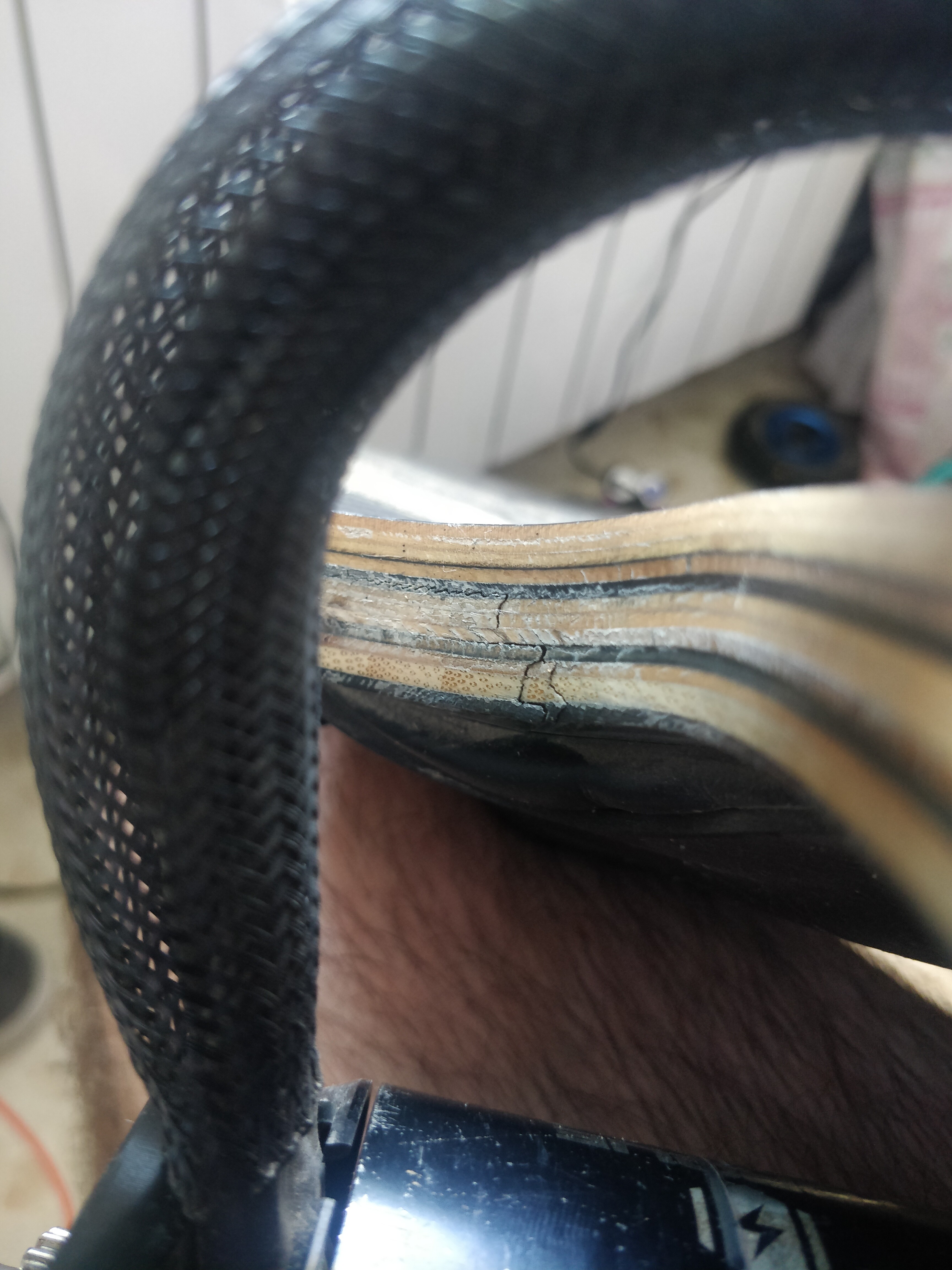

What do you guys think of these cracks??
They’re two cracks on symetrical side of the deck, back side.
I wouldn’t care for that personally. I don’t know how risky it is though, I’d guess “too much”.
If you have a multimeter and the opposite connector you can plug them in and see what connects to what with the continuity buzzer or resistance setting (0ish ohms means they’re connected, overload/OL/no reading means they’re not) but Brian has already said what they likely are. The benefit of plugging something in to check is you can ensure the whole connector (ie both ends plus whatever wires are already in place) is wired “right”, or at least the way you expect it to be
Edit: don’t plug a full and powered on charger in and then use the continuity setting sorry I should be careful. I meant something like this where you have either the bare connector or the connector with whatever wiring is already attached
