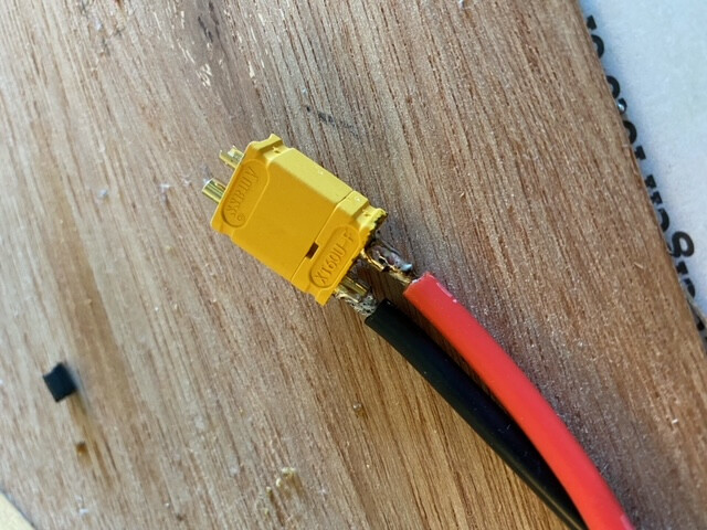

Is this OK? :innocent: image
I’d be a little uncomfortable pushing high amps through that. It looks a bit discolored. A nice shiny finish is optimal. Are the wires pushed all the way down in the plug too?
It’ll likely work. Much better than your last one.

You can see a bit of the rosin flux i guess. Is that a problem? I can push the wires just a little into the female connecter. The male connector has more space for it?
