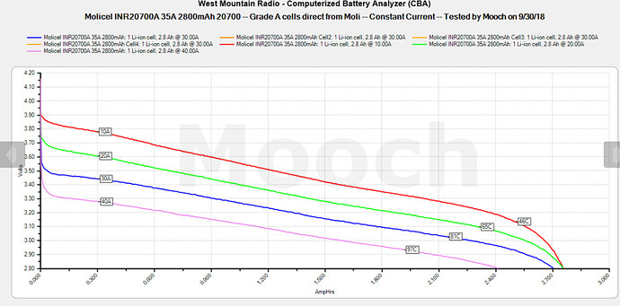

How do you guys think these cells would fair in a 12s4p battery? (on 100mm thane)
  • fare
Autocorrect :triumph::triumph:
The Mooch test shows they’re aight
Mooch
Looks like you’ll need to set the bottom cutoff around 3.2V
I’m not entirely sure on how to interpret these graphs, but compared to the Molicel 20700A:
–The Sanyo would be the better choice right? Since the Sanyo appears to have higher voltage (and AH) for each constant current tested (though marginally and only at a few points)?
Also why 3.2v as a cutoff specifically?
These are the only cells that seem to be in stock atm for a decent(?) price

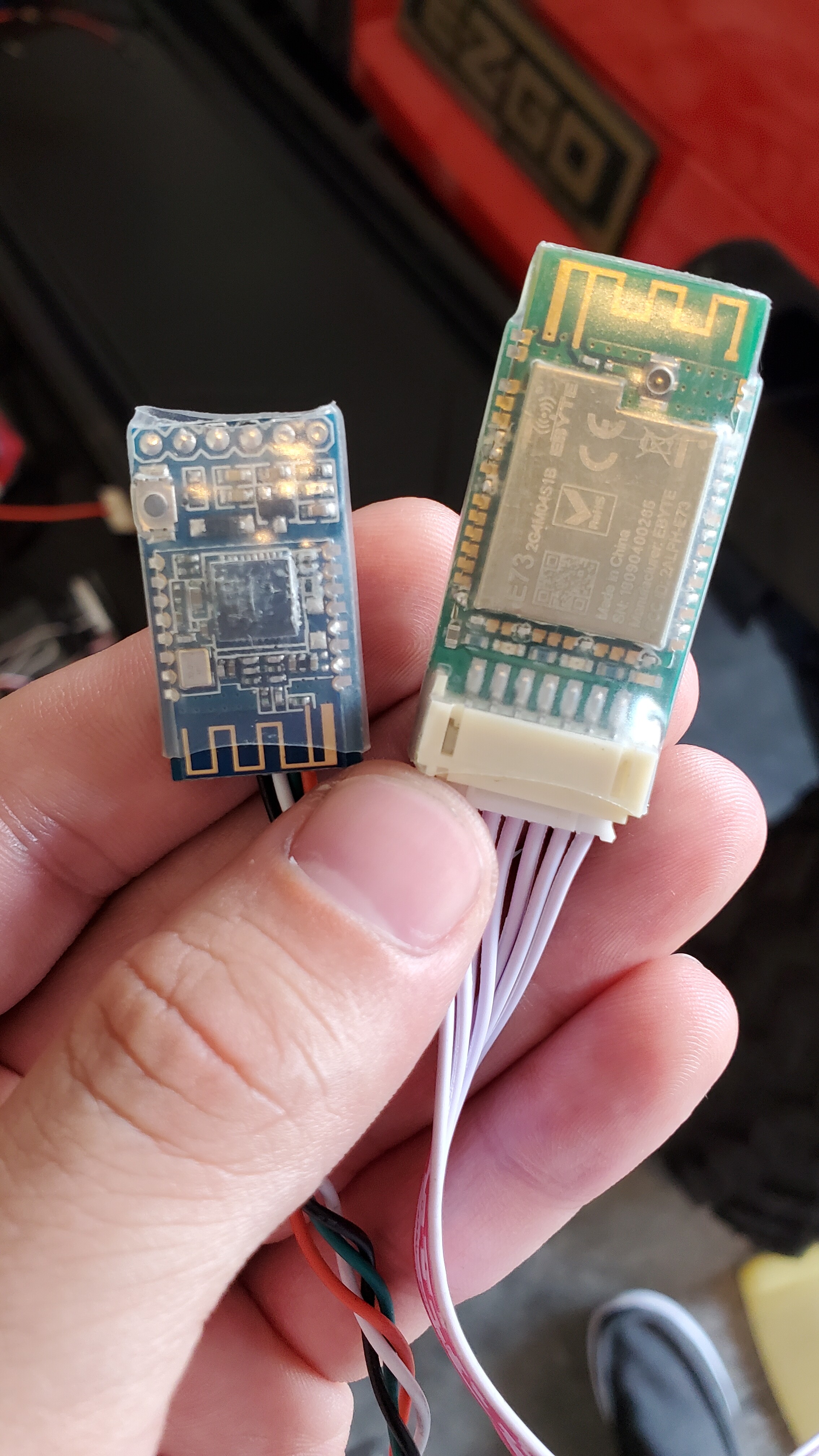

Got these 2 guys included with a purchase. The right one says metr and looks like a GPS logger, the left one doesn’t say anything but shows up as “metr 255” or some similar number on Bluetooth when plugged in to uart.
What is left boy for?
I heard I shouldnt combine a used battery pack with a new one because the weaker will draw power from the newer one
Both are Metr bluetooth modules. The left one is an old version with a different nrf tho and it won’t work with newer firmware versions.
