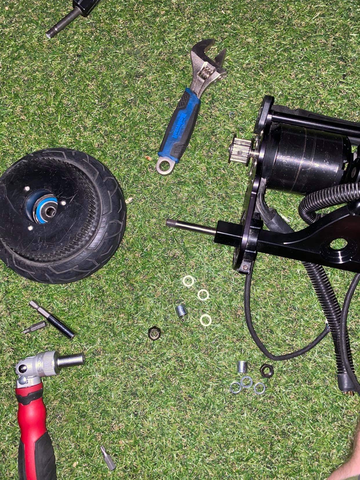

First time I touch these… Can someone enlighten me on order of hardware?
3 speed washers
1 spacer
Bergmeister wheel
Janux mounts
I think torque board clone truck
