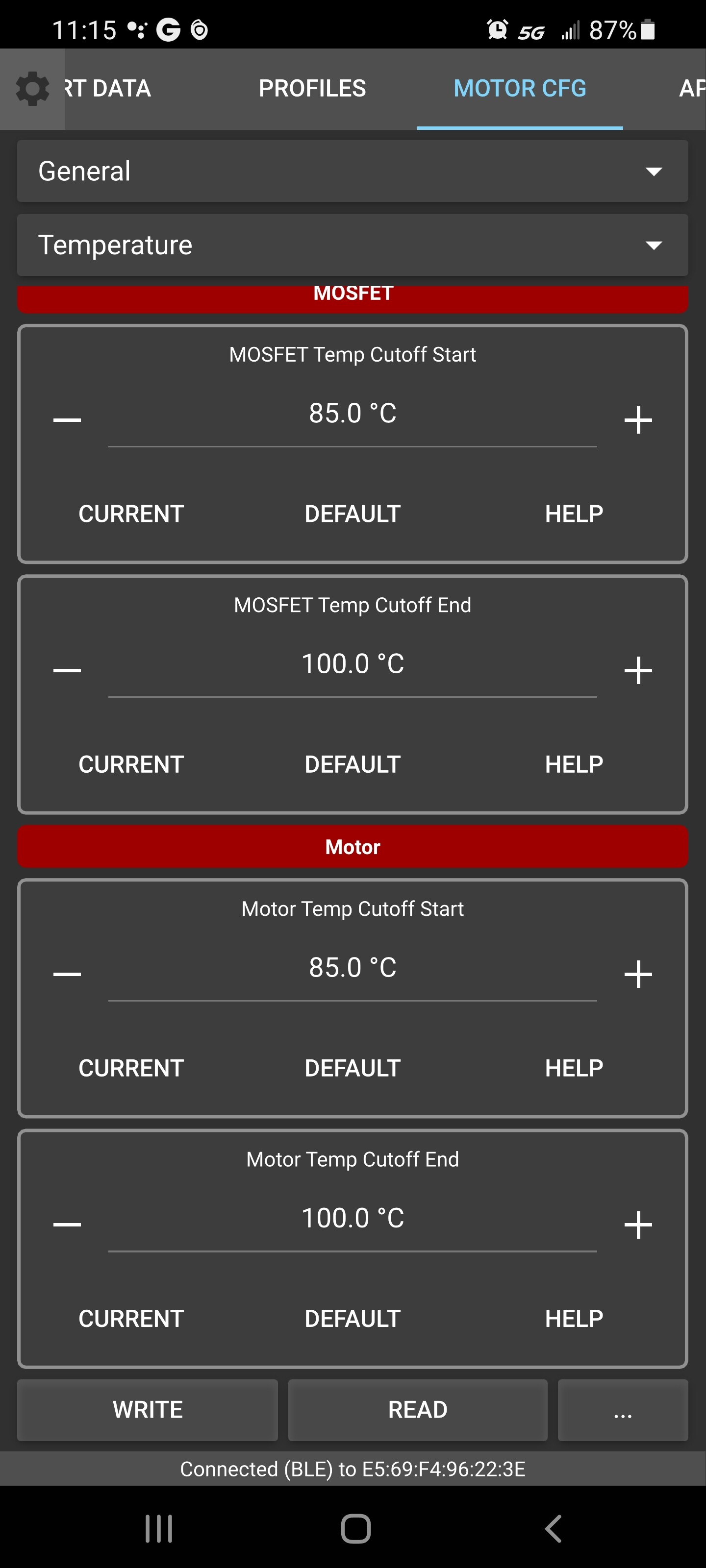

Should I leave these numbers as is or bump them up a bit, haven’t had any overheating issues just don’t want any.

In general you shouldn’t touch the temp settings unless you A) have a good reason and B) know what (and why) you’re doing. They’re set at a level that makes it very difficult for a user to damage anything. If you increase them, that safety goes away.
Awesome thx!
Good to know, A and B do not apply to me. I will leave them alone. Thank you!

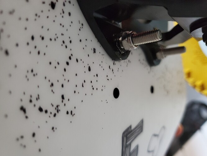

Mbs trucks have grooves so am I not meant to use locknuts on top?
Always use lock nutz, bro, always!
They were hard to get mine in, I took the axles off and it was a lot easier

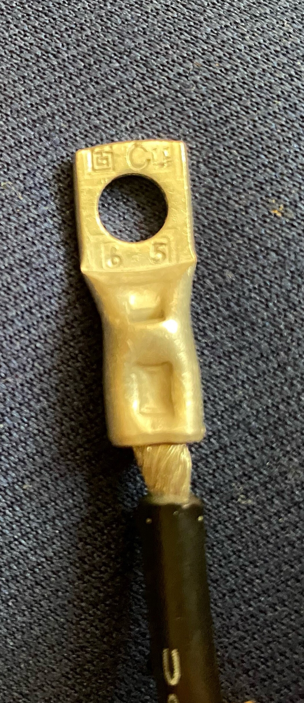

today I got my crimping tool. So I started crimping but I would like your advice about it.
I made this crimp and as you can see there is some uninsulated wire left (I would use heatshrink ofc) and I also couldnt see the wire made it upto the looking hole. Would it okey to use it or is it a really bad crimp?
I also ordered some 4mm2 terminals because they would fit (due to the seller) 12AWG. But this is a 6mm2 terminal and I found it a bit hard to fit in without hurting the small wire strenghts… Would 4mm2 not be too small?

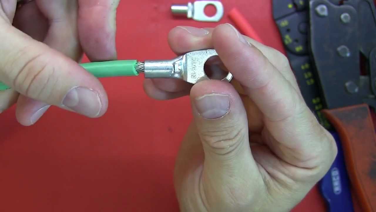

I followed this crimping tutorial:
I wouldn’t worry too much about the exposed portion because you can always add some heat-shrink or electrical tape around that, but not being able to see wires in the looking hole might mean that the wire slipped out as you were crimping :confused:
If you try to pull it out and it doesn’t budge, then it’s probably safe.
is crimping just using friction to hold the wires in the holder? i’ve always wonder why people would use that over just flooding the holder with solder and sticking the wire in to join them together
Apparently if you look under a microscope, crimping creates such a good mechanical bond that it can outperform solder. Allegedly
Personally I find it difficult to get a good crimp. I have one upcoming board that uses crimped connections for the battery, but honestly I would try to avoid it if possible :laughing:
