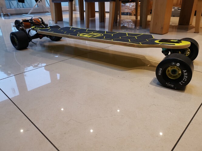

Any recommendations for real short motor mounts?
Evo 40 with boosted ss enclosure, seeing if I can fit motors under the board without putting this thing up on risers and changing angles. I’ve got some BKB and also TB V4? mounts and they hit the enclosure, does anyone make a really short motor mount?

the shortest i know is either the bkb mount or the OG enertion mount, they both use 265 belt iirc. for even shorter, u probably have to look at those chinese prebuilt board, i’ve seen some uses 255 belt, so they should be slightly shorter

cool, I’ll see if I can track something that uses a 255 belt, or less, thanks!

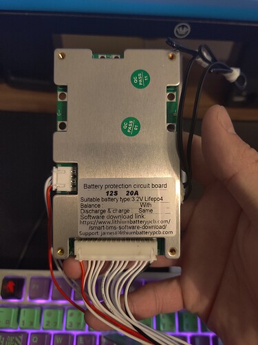

Is LLT good at resending BMSs? I ordered a Liion bms and got a lifepo4 one instead:
And I don’t believe these are compatible with liion

is it the bluetooth one ? if so you can change it in the app settings it shouldn’t damage the li-ion since LiFePo4 maximum voltage is lower than the Li-ion battaries
Yeahhh it’s the bluetooth one;
i emailed them and they replied really quickly telling me to do the same XD
Thanks
lol no worries man, it’s the info you don’t know on the first use
