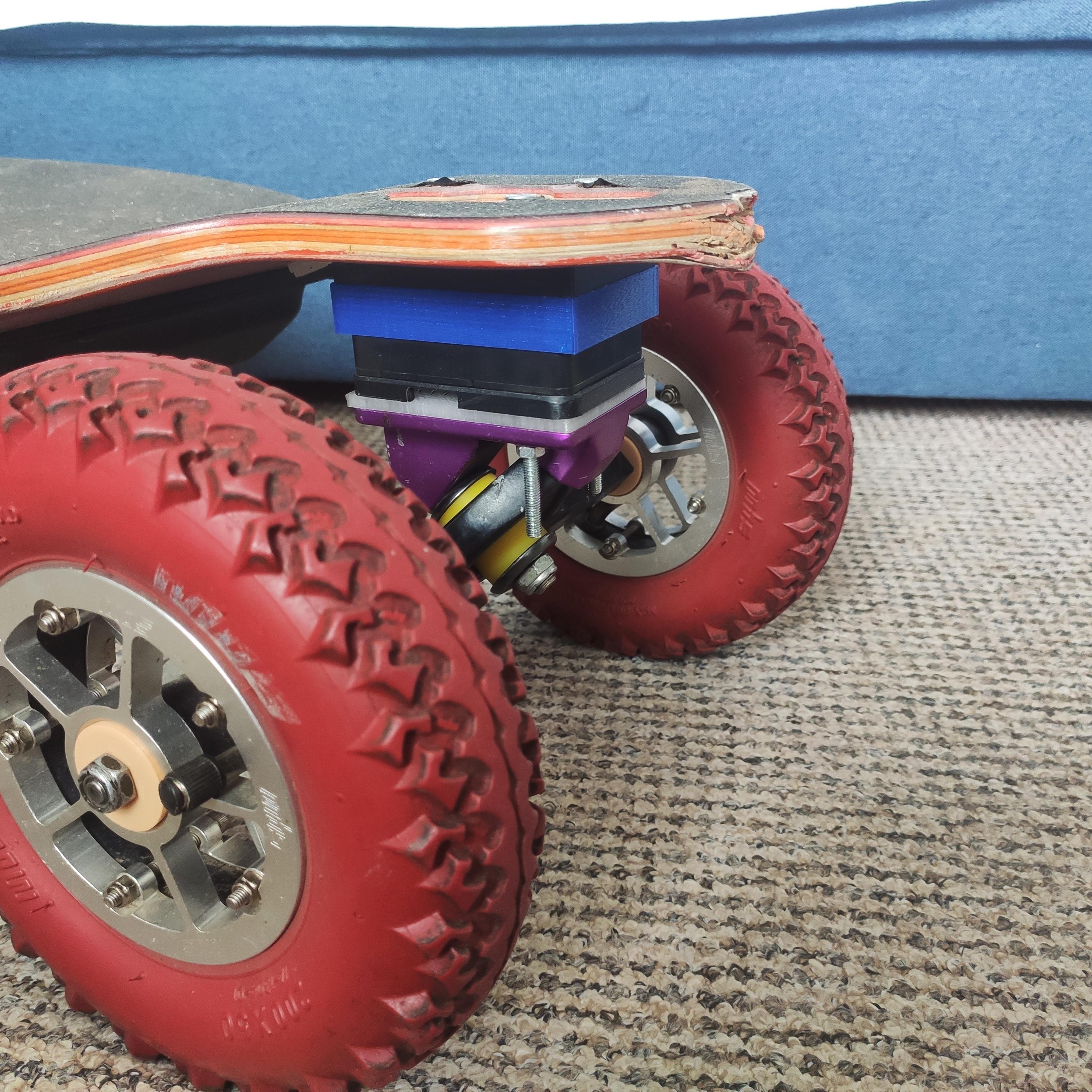

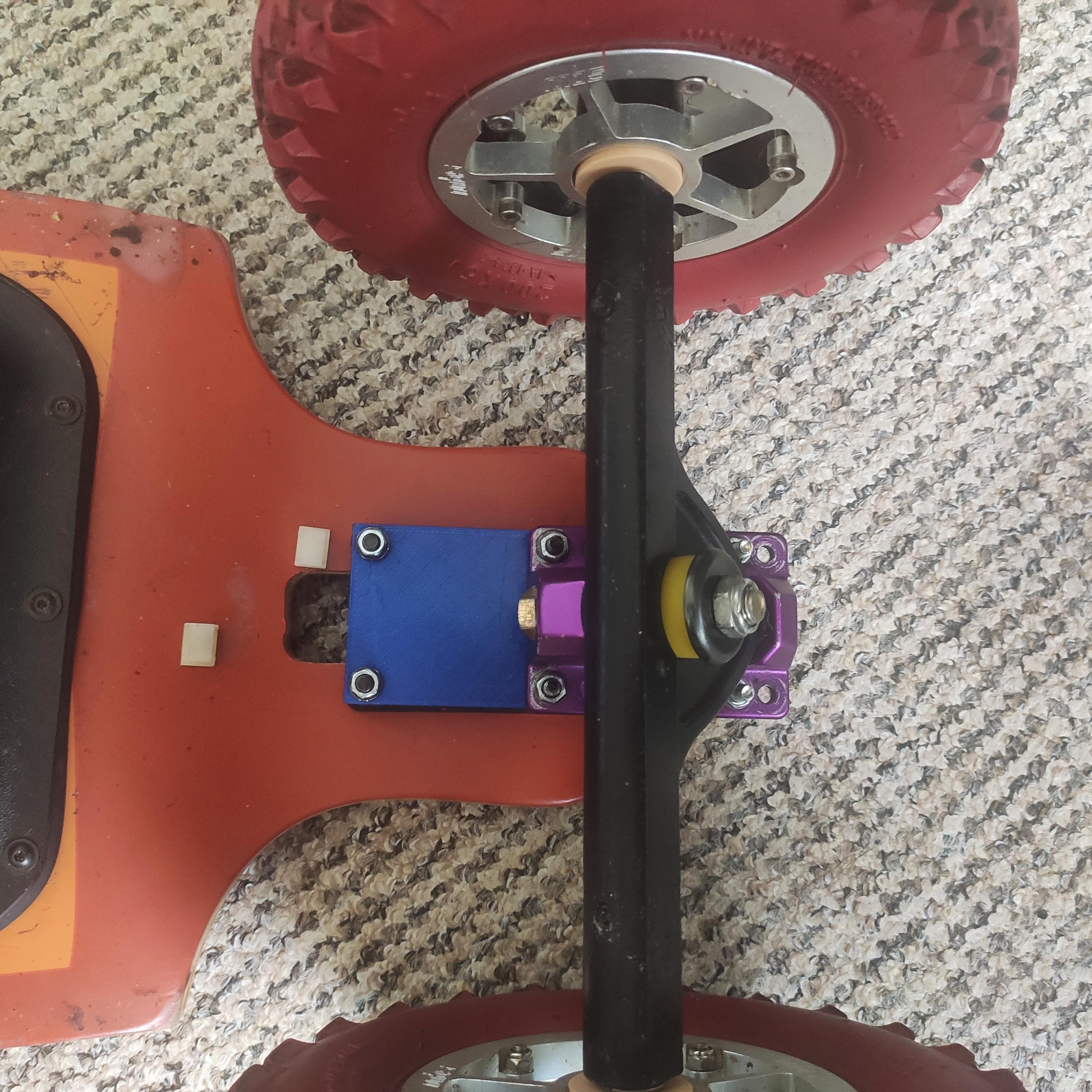

8 inch wheels on longboard deck, wheel clearance
I’m putting 8 inch wheel on a longboard deck, but that is introducing wheel bite obviously. Yesterday I was messing around with risers and with the stack of 50mm I was able to get it manageable. It seems rideable, but idk. Currently running TB218 trucks.
I see few options here:
  • Ride it as it is - cheapest and easiest option, but dangerous.
  • Cut the corners of deck and reduce risers to 35-40mm - could weaken the deck.
  • Make metal deck extension to move trucks away - sounds good, but again it could weaken the deck.
  • Upgrade to Flipsky 15.2 inch DKP trucks - would put wheels further apart, but I’m not sure if I want to ride DKP truck.
  • Upgrade to Boardnamics BN270 hangers - This would put wheels 30mm outwards and I’m not sure if it would solve the clearance issue. But I like these trucks the most.
What do you suggest?
EDIT: I have made 3d printed deck extension riser to test things out, it seem to be way to go. Wheel clearance is perfect. I’m just not sure if this won’t stress out the deck too much.

Maybe do that and put a layer of fiberglass on the bottom of the whole deck to strengthen it.

Thanks, for now I will got with the deck extension option, the BN270 would need big 30-40mm riser as well if I’m estimating it correctly. The extension feel solid even now with the 3D print, once it’s 5mm metal there, I’m sure it will hold well. I’m more concerned about the deck, but if it cracks, this is cheap deck anyway.
In this scenario Flipsky 15.2 DPK truck would fit the best. I’m just not big fan of DPK and also it costs almost as much as Boardnamics hangers. But for now I will try to make the deck extension just for the science so I can share my experience :smiley:
Good tip, didn’t think about this. I may do that since I’m getting fiberglass for the enclosure anyway.

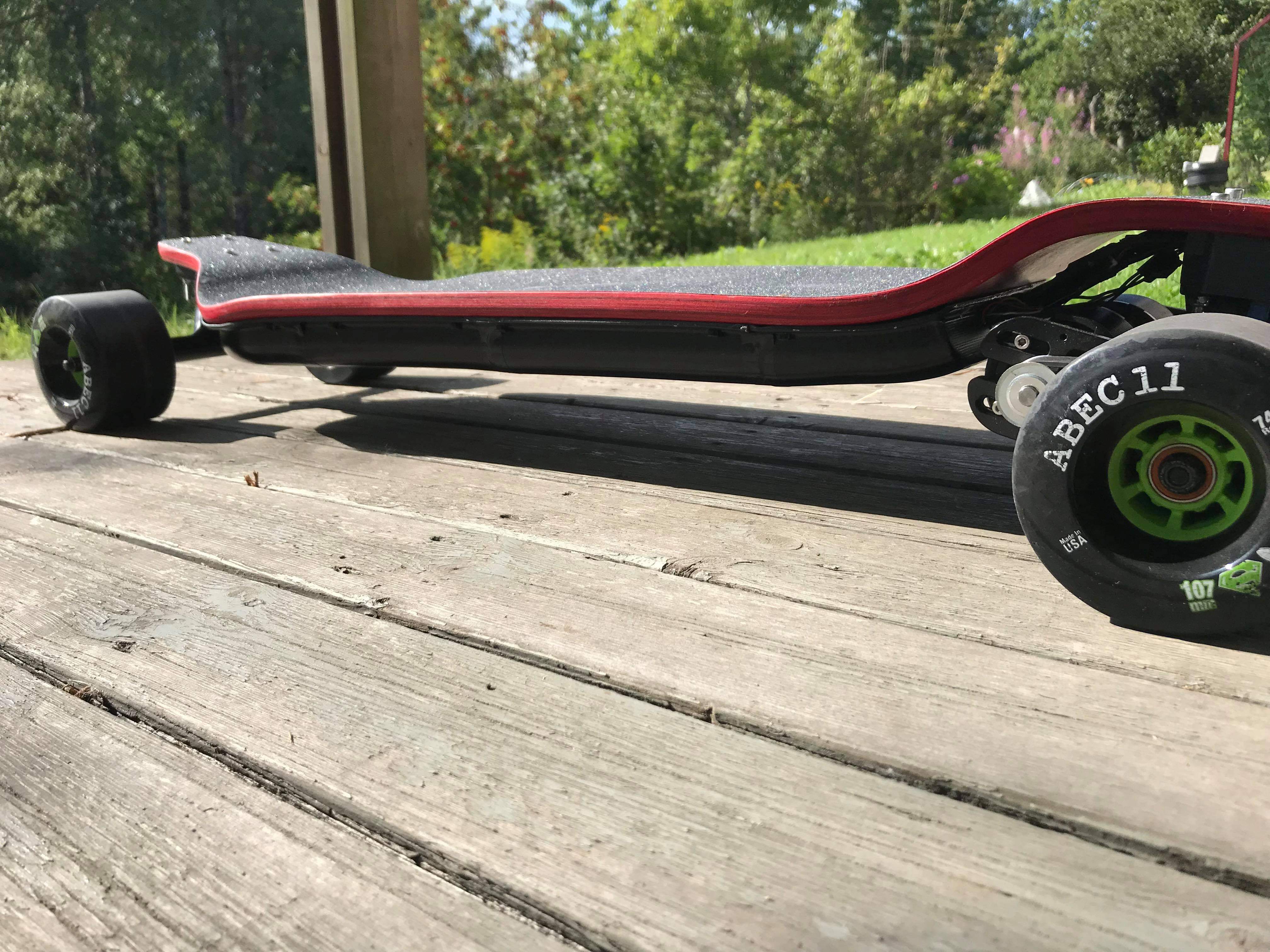

I see that we are having similar upgrade here. TB218 trucks. Abec 107s to AT wheels.
Have you decided what wheels or wheel size do you want?
TB218 trucks can fit mountainboard wheels (just see my reply above) you just need 638 bearings, but you will run into the same problems like me. I think that good option to consider for hubs are Trampa Superstars with offset spacer. However you will need different motor mounts for sure.
