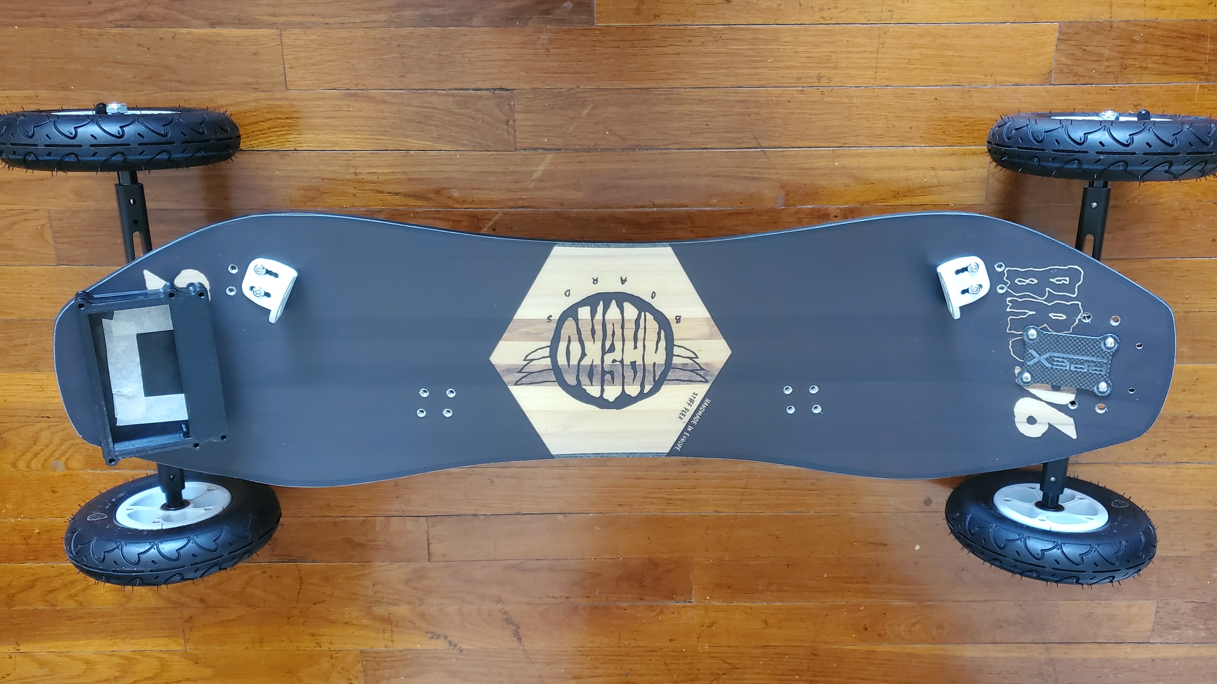

Is this the correct direction for the Kenda K909 tires?
looks good to me.
