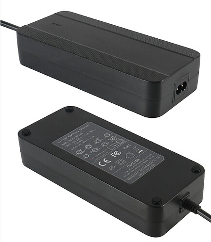

Any suggestions for buying a charger. What are the main things to take into account?
I’m searching for a 42V charger (36V battery) which charges 3 or 4 amps in EU. :smiley:
Thanks for your suggestion. Unfortunaly the 3amps charger is out of stock. The 4 amps charger is a bit too expensive for me.
Alternatively aliexpress has good options depending on what chargeport you need.
Yeah I saw someone suggest YZpower to someone else. Any experience with? Port doesn’t matter I can fit anything what isn’t too big into my enclosure.
How long can you leave cells connected in Parallel before making series connections; also is it ok to mix 3.53V cells with 3.52V cells in the same p group. All are new cells.
Yzpower or Wate are good options, I’d pick barrel jack or xt60 as a chargeport option.
Thank youu I will take a look!
