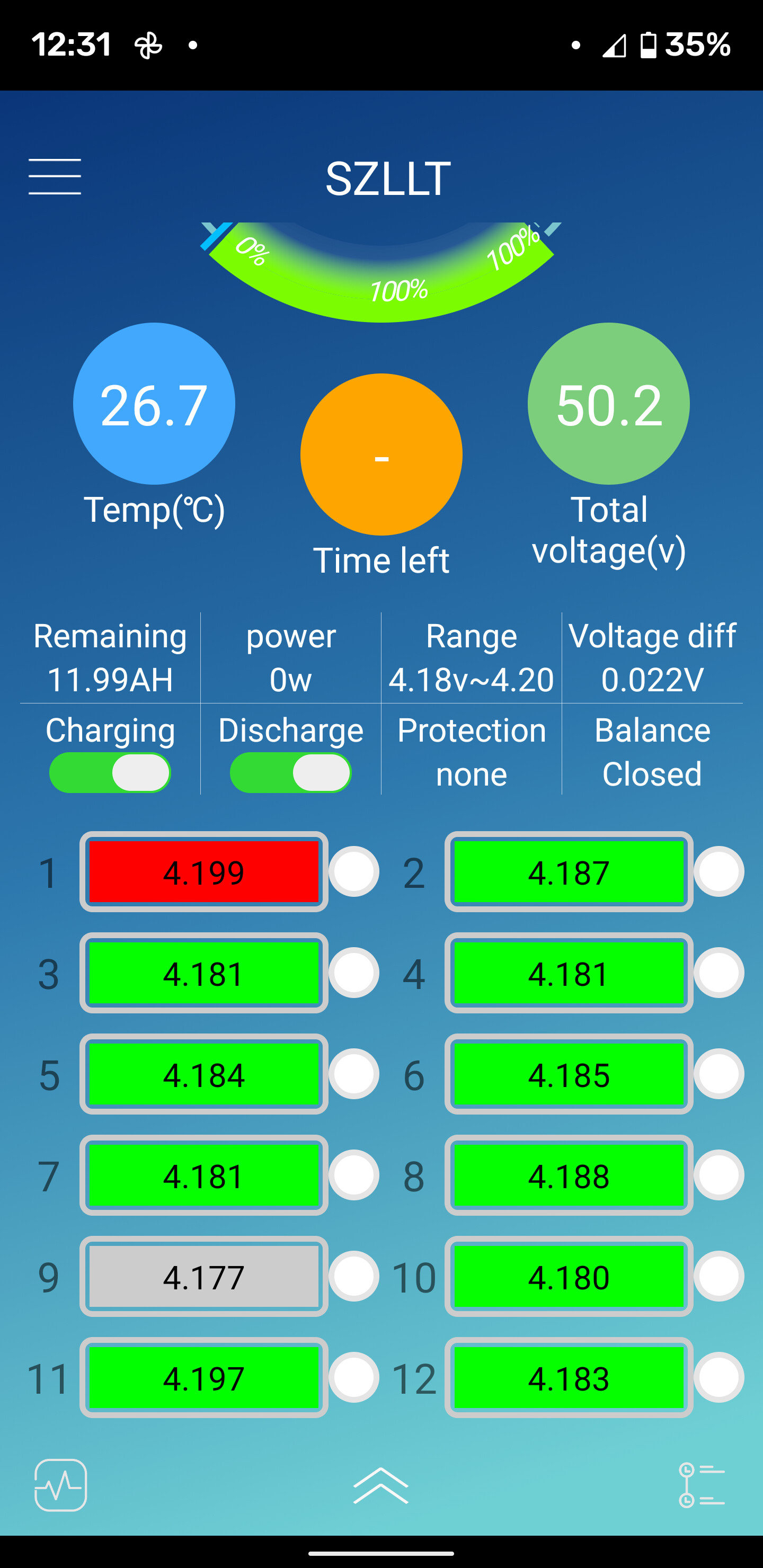

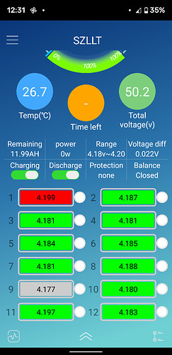

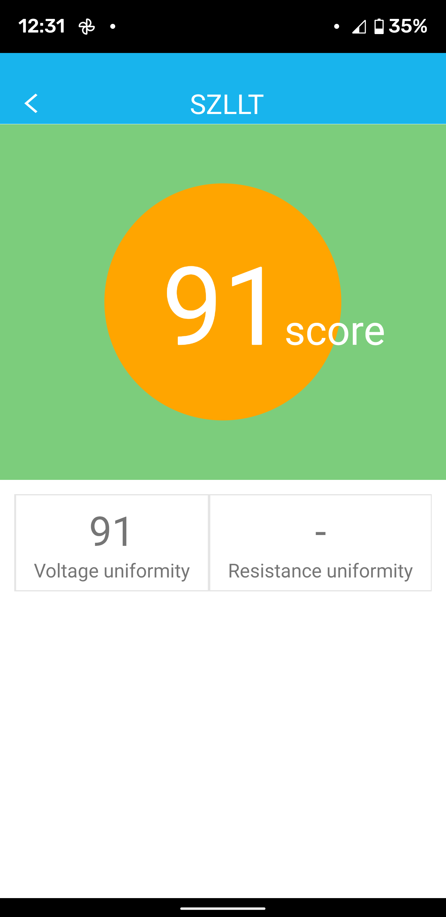

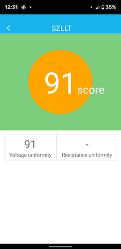

My BMS is showing one of the cells red overcharged:
Should this straighten out eventually if I leave it plugged in?

red doesnt mean overcharged. Red means the voltage of that cell is very different from the rest. Just let your pack balance.
