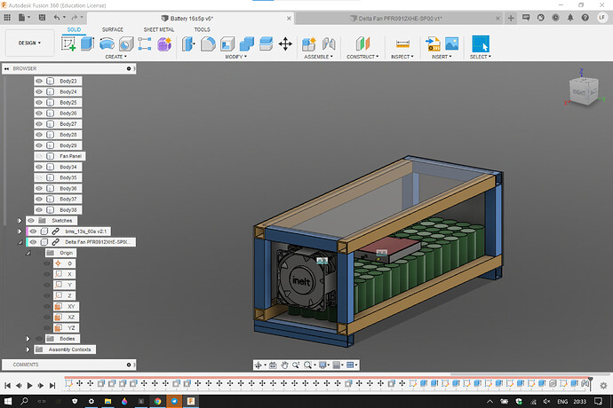

I need a lot of air flow, will be running A123 lithiumworks LiFePO4 cells at 50a each :sweat_smile:

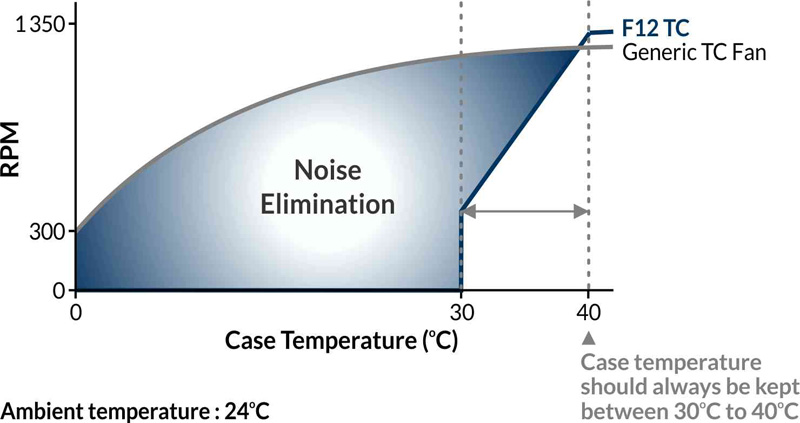

There are thermistor controlled case fans like this one:
You should be able to change the ramp by adding resistors.

btw here’s the setup,
Wind tunnel! Nice shit
If u can maximize the surface area of the battery pack, then it will be cooled more efficiently
i’m making sure the bottom of the pack will have contact with the steel plate below, the steel plate is flat, i will isolate with kapton, but nothing should short once i secure it into place :smile:
make it real, i want to see it in action :star_struck: its gonna be loud af but it will be worth it
