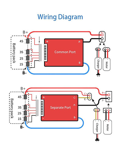

Any battery pack you buy on this forum will be bypassed as buying a high discharge BMS is expensive, it takes up space and is mostly pointless.
It’s pretty straightforward. The two main BMS layouts look like one of these:
All that really matters is that you’ve got the big blue wire coming from the battery, going into the B- port, then a bib black wire coming out from P- and going into the rest of the power system.
To bypass the BMS, you either need to bridge between P- and B- (with a comparably beefy wire), or just disconnect the wire from P- and connect that wire onto B- (so there are two wires going to B- and no wires going to P-).
Ok, thanks guys! You made this seem a little less scary now :sweat_smile:
So this means that as long as I buy a battery pack on this forum, I don’t really have to worry about it? I just have to make sure the battery builder is bypassing the BMS and adding a fuse/ fuseholder on the charge port?
I see some people put “lights” in their wiring diagram, what’s that for?
I’d assume for installing a buck/boost converter to allow for bling bling hardware. I have my front light connected directly to the battery
i don’t think any battery builder here would build a bms discharge pack by default unless the buyer request that specifically :joy: u r good on that part
It’s for lights or accessories on the board. You can just omit that if you’re not using them. Typically a buck converter would connect here, and it would drive the lights.

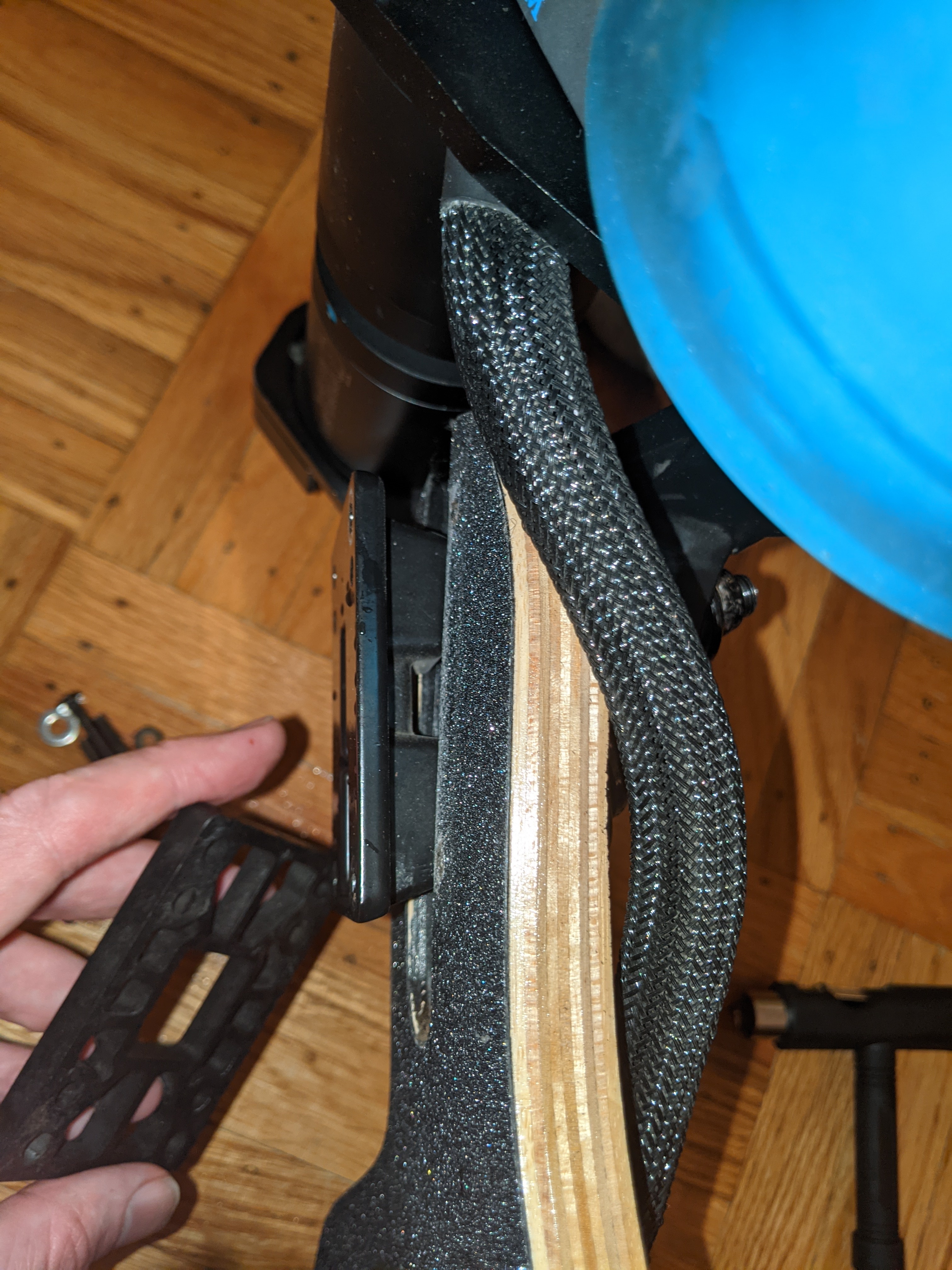

I’m thinking now I chop up this riser from off the front trucks on my boosted and use the pieces as a riser on the top side for the dkp dropthroughs at the back to even out the board height.
