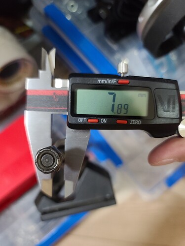

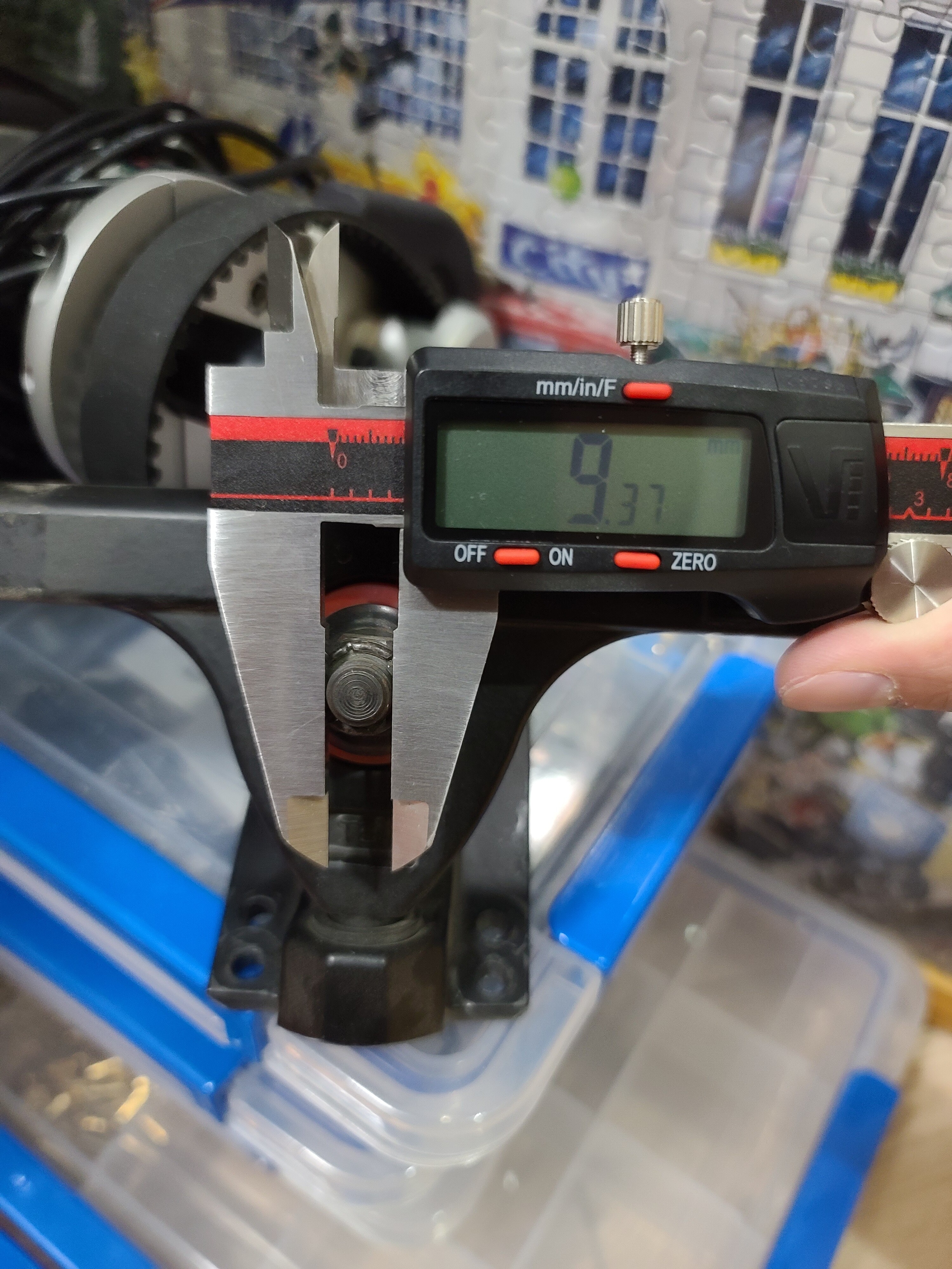

Hey guys, for some reason im finding very difficult to find what is the standart size of truck axle and kingpin nut (caliber 2 for example). I Believe that trucks are M8 and kingpin M10 but i may be very wrong so i want to make sure.
Neither of them are metric system tho
Mmmm… Then i dont know what hardware to buy :sweat_smile:. Thaks anyway for the fast response :grin:
according to google, caliber ii axle nut is 5⁄16 and kingpin nut is 3⁄8

I feel dumb as shit when working with alternative metric systems :sweat_smile: Thanks!!
