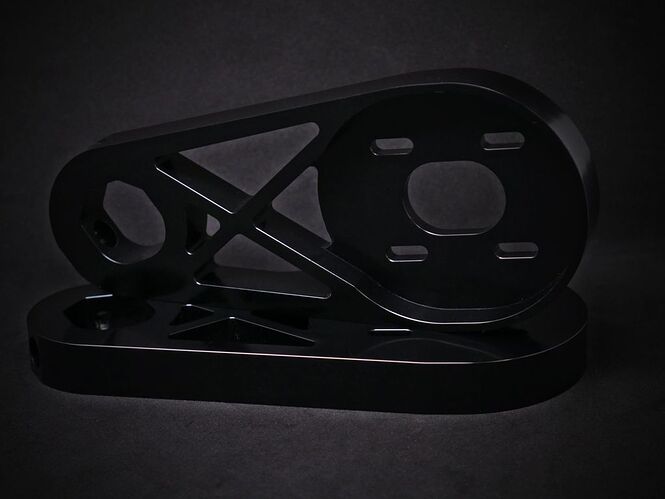

Building my first board, am now well acquainted with having all the cool parts be out of stock :joy: . What’s the best belt-drive motor mount for 8in wheels that fits on MBS matrix II trucks that I can order today?
CA7D815D-6BF4-401D-8E64-6B89189AC422
Haha welcome friend :rofl:
Ive heard really good things about these mounts. Though as with all things LaCroix, they are pricey. Check out @Boardnamics mounts. Cheap and high quality :metal:

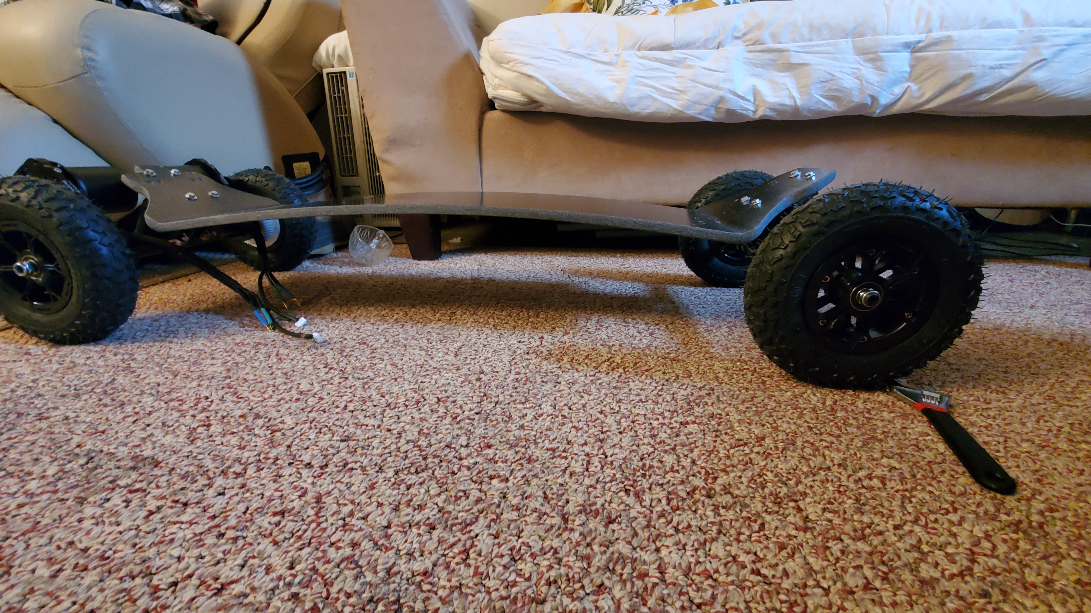

Anyone know a good enclosure for this guy? I had to slightly move the trucks lower for a better clearance without losing the angle needed to turn. It should be able to fit a 12s8p flat battery. If not, I’ll probably do another fiber glass enclosure.
Thanks! Do you know when the next batch of @Boardnamics mounts might ship?

I believe that Kevin has a shipment coming in this month.
should be arriving end of this week, so probably shipping start next week…i think
Good enough for me! Covid supply chain has been a real drag…
