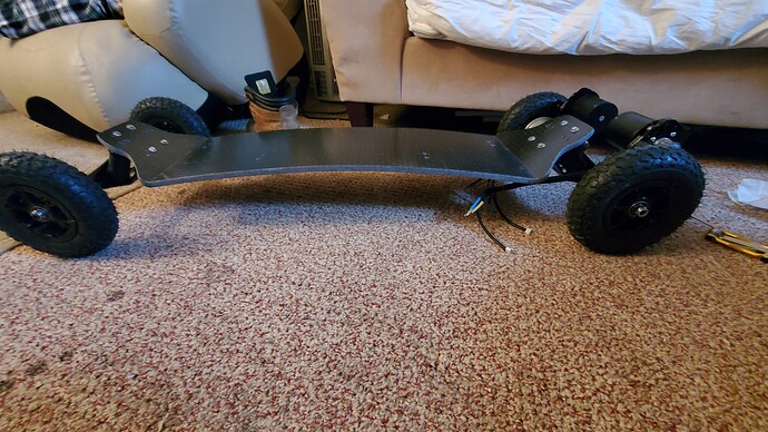

is 2 inches of risers to much? gonna be made out of 1 and a half inches of wood and half inch of standard rubber ones (to ease vibrations)
I wouldn’t use soft risers. I don’t think that’s too much under the right circumstances but it depends on the circumstances. I have almost that much on Bigfoot.
need motors to clear the enclosure more
can use hard rubber ones also
what circumstances would this change by?

is this steel strong enough to be used for such long bolts?
may get 70mm long but somehwere around that length
https://www.amazon.co.uk/dp/B08KHJKSDT/ref=twister_B08KHHPRMQ?_encoding=UTF8&psc=1
I would advise against stainless steel bolts.
12.9 grade alloy steel is what you want, and 10.9 grade alloy steel will work fine.
Stainless is weak and can gall. But it looks nice.
The apple of bolts
cheers thanks
will search around for both the ones you mentioned

Well, after getting the deck necessary for the mountain board trucks, I’ve noticed I have very little clearance to put the battery under the deck…
Will I unfortunately have to put the battery pack on top of the deck or is there an enclosure for this?
ewww :rofl:
I hate it too…
Edit: hmm, what if make the enclosure in the middle of the deck and sandwich it with another deck on top… maybe that will look better.
I’ll send a photo when it’s completed.
