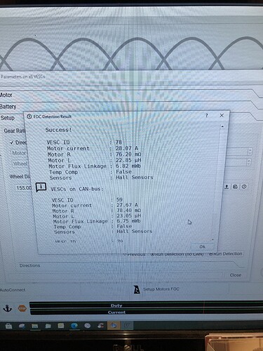

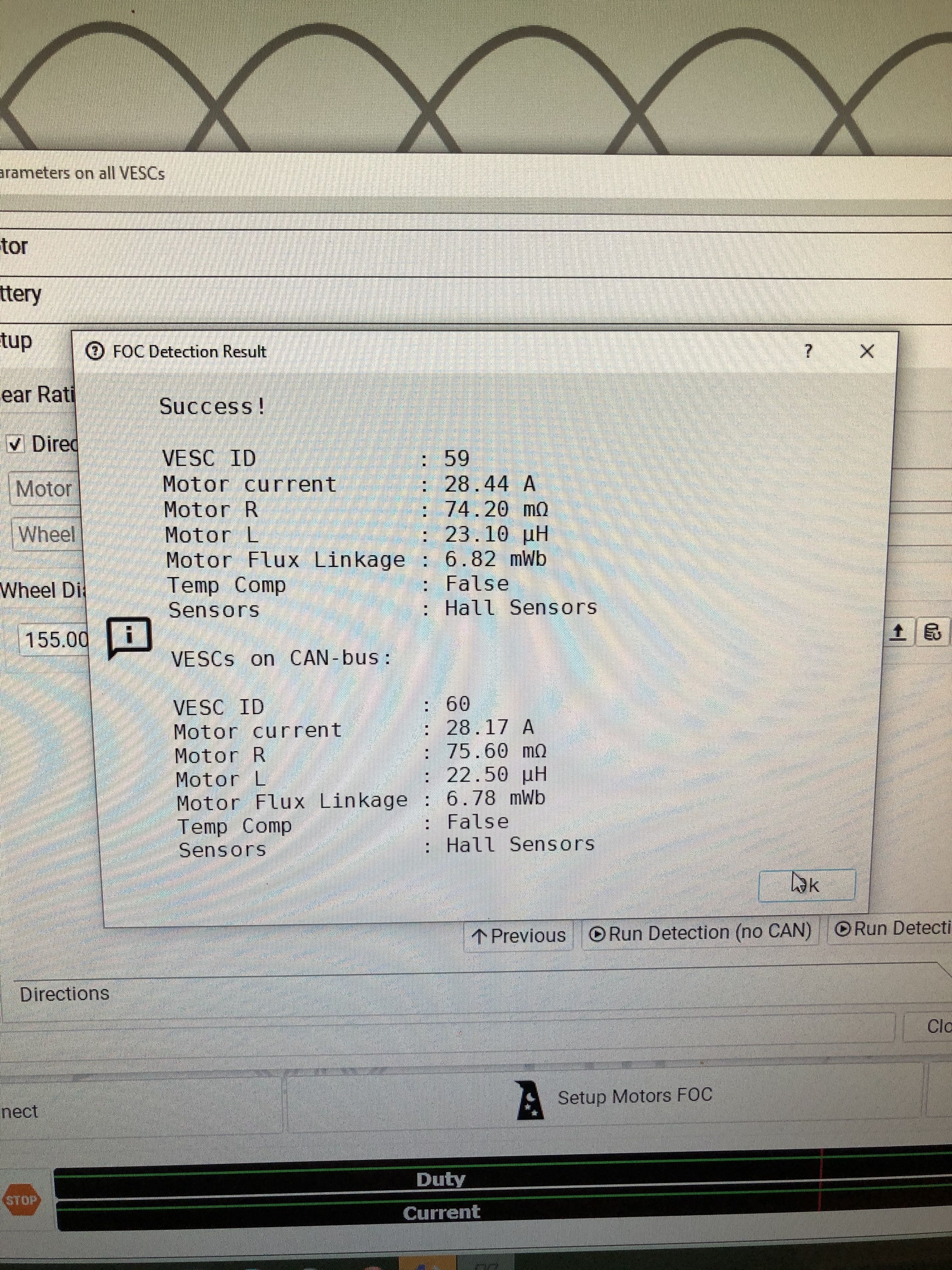

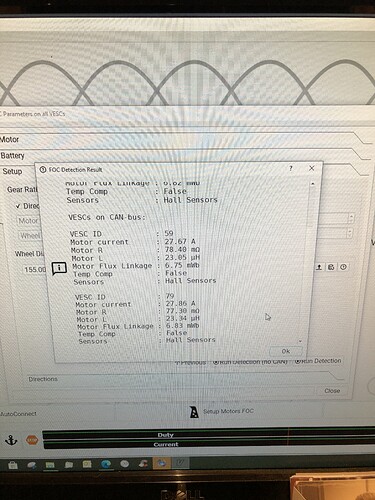

Can anyone help me as to why for 4WD my board only seems to show 3x motors when setting up ?
Dumb question but did you make sure that the puck is in “fast” mode? For me in slow mode the input wizard barely registers anything
Yeah I did. Cheers though. I think it’s stuffed

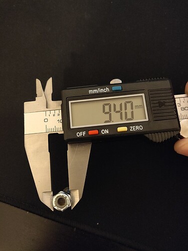

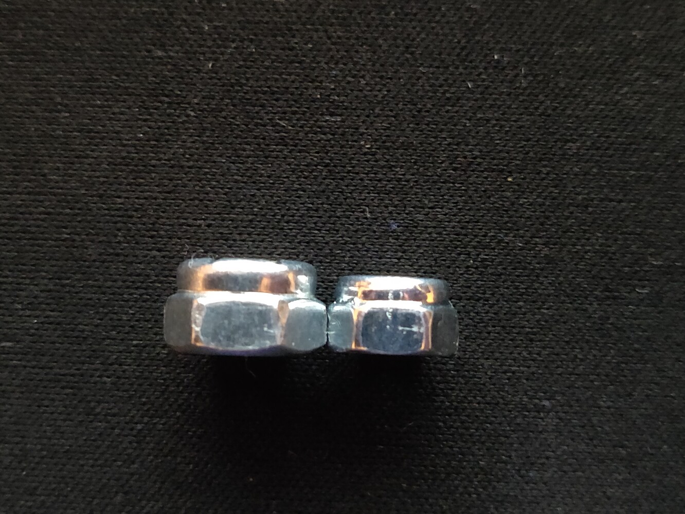

I still haven’t found a solution to my locking nut problem.
both are M5. The left one fits with my T-tool, the right one doesn’t. The size of the left one always came with skatehardware but everywhere else i can only find the small right one.
M5 according to the Standards are max 8mm but the one i always used is 9.4mm
are both nylock?
Yes
and they are both metric
no imperial voodoo
As far as i can tell, yes.
I do have imperial screws and nuts but they have the same size nut i think.
That appears to be some sort of Metric+Imperial bastard child nut that you’ve found, probably ONLY useful on skate hardware and nowhere else
I have no idea how to find another nut with FUB exterior and Metric interior.
I’d suggest abandoning the search LoL.zzz
that’s what i was thinking it could be.
I’ll measure the imperial nuts when I’m back home.
the metric nuts are so small thooo and i would need to buy another t-tool. I want some beefy nuts (that’s what she said)
Looks like a 3/8 inch outside hex and an M5 internal thread based on your descriptions
Are you like 100.000% sure the inside thread is M5, and not just some FUB thread that happens to fit?
I think this is the problem holding you back. Find out which FUB thread fits M5
@MysticalDork do you know?

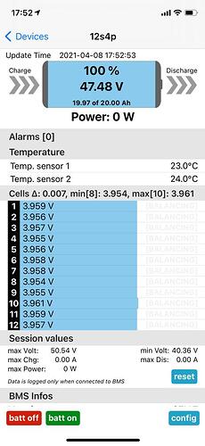

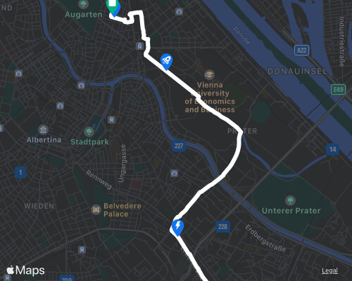

guys, can you help me troubleshoot my p42a nese 12s4p pack ?
i started getting immense voltage sag and the pack is basicly new…
on my testride today, i went from basicly fully charged to about 42V momentarily when accelerating, this behaviour definetly wasn’t there from the start.
what i did so far is check that all the connections of the modules and wires is solid, which seemingly is, so the problem is a bad cell ?
when watching the smart bms output while accelerating groups 3 and 4 seem to sag more than all the others, but atleast on the graph it does’t look THAT drastic…
how can i proceed from here to find the issue ?
bad p group?
