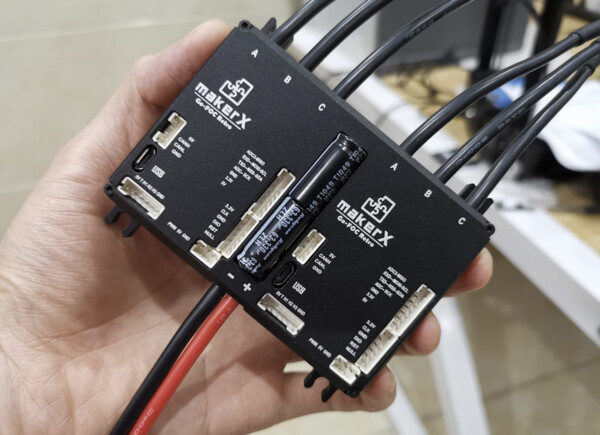

so you are keeping with the original one you bought and are just modifying? changing the motors was a good choice, the esc will make a huge difference too. totally recommend getting a Go-Foc Retro. it’s perfect for you as it’s not expensive and has the benefit of being a dual esc making setup easier. also comes with a chunky heatsink.

Everyone seems to like Maker-X so it’s either DV6 or, as you recommended, the Retro. My only hesitation is that this is my first vesc-based esc - and I dread all of posts I see about FW/SW upgrades, motor detection weirdness, limit settings, etc. I just don’t want to fry the damn thing. I’d pay extra to have it shipped with the latest FW/SW if I could. According to the motor specs the FlipSky 6355 / 10mm can draw 65 amps?!? I think that will choke the shit out of my battery (and I’ll never accelerate like that - combined with the fact that there is no such thing as “uphill” here) so I will want to set it up properly so it doesn’t try to draw more than the battery can supply. Whatever it draws right now through the cheapo-esc is more than enough, I couldn’t punch it today and survive.

I was just about to pull the trigger on a DV4 or a Retro - but now I’m having second thoughts…get the 6 and don’t look back? Better to be over-spec’d and have the headroom? Also, I need a loop key and a remote.
I was disappointed with the amp capability of the retro, with no external facing heatsink I would only expect to be capable of 30-40a on urethane wheels.
Pneumatic probably less. So far the dv6 has performed great with pneummies and 50a x2 so I would recommend just getting the DV6 to start. It is very thick though make sure to check on dimensions

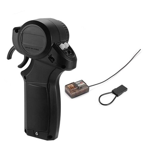

Here is the remote style I like…nice and simple
US $20.83 15% Off | New Mini 2.4Ghz Electric Scooter Remote Control Electric Skateboard 4-Channel Receiver
