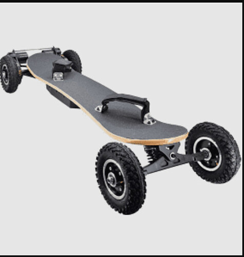

So after reading, you say you got that cheapo Chinese board?
if this is what you got, i don’t care how unintense you ride it, it’a a death trap. You can barely reuse anything on it. You have more chance of falling because the cheapo Chinese ‘‘aluminum’’ breaks under load.
I don’t know what your budget is, but you can build something from scratch that looks good and costs the same since your requirements are very low.
Tell me your budget and I’ll cook something up for you :grin:
