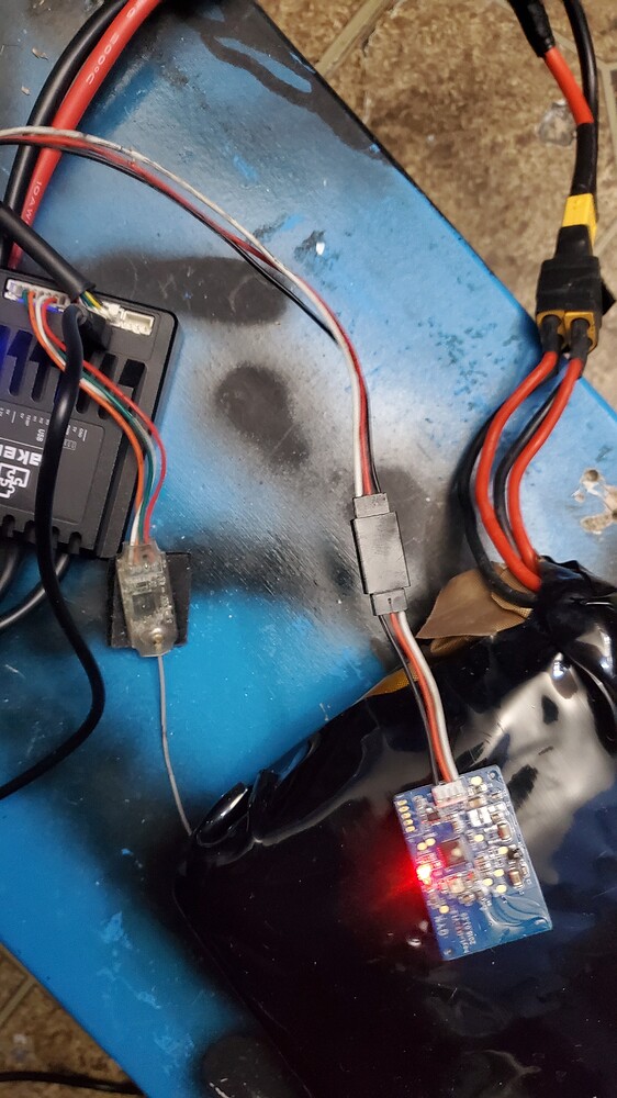

    The reason I an upgrading now is because I have (what all empirical evidence suggests) a buggy motor. I suspect the internal position sensors. There are no external sensor wires as stock, but one motor will just quit randomly after I get moving. The other motor can keep me going, but there is a tangible loss of torque. If I come to a complete stop and take off again - it works - always- but for a random duration of time (maybe the rest of the ride, maybe 10 seconds). I first suspected the cheap single-unit ESC so to test I swapped motor wires (making sure there were no connection issues before or after the swap - connections were tight, it initially really felt like a power delivery problem but I have no evidence for that after inspection) to see if the problem would follow to the other motor or not and what do you know, different ESC channel, same problem on the same motor. I’ve been able to reproduce a few times with the cover off and tried pulling on and manipulating the power wires to make sure it was absolutely not a phase wire connection issue and it is not. So, despite being highly dubious of the ESC and expecting it to the be the problem…my troubleshooting points to the motor.
I recently purchased a pair of Flipsky "battle-hardened 6355 140kv outrunners (10mm shaft) that are on their way. Pretty sure the existing motors are 200kv - so I opted for torque over speed, though I will never reach the limits of either on any motor I use.
I still half-expect this to not solve the problem and suspect I will end up replacing the ESC (and if not now, then eventually for sure) - so I am wavering back-and-forth between Maker-X and FlipSky FSESC. Also not sure about 4.x/6 - I plan to run in sensored BLDC mode (the motors I bought have sensor wires) I suspect that my minimum needs means that just about anything I get will work - I’ll never approach the limits of any of this hardware and if that is the case then I just need a reason to choose one over the other. If there is a stand-out choice for an application like mine then I haven’t seen that documented (even as opinion) yet on these forums (that I have read). I will also need a remote (I really like the trigger ones) and I know those are out there for around $30 with a ppm receiver. There are also limitations on the stock battery which I am fine with - it delivers more power than I need.
Is a boutique ESC like the Maker-X a good idea for me (I prefer as little tinkering as possible, but I have done this before) - and is 4.x more reliable for low-power applications, or does it make more sense for the difference in price to install something with ver 6? The price diff is less important to me than having something that will run for another 4-5 years.

Yeah, that’s basically it. My wires were backwards on my DV6. Also the motors should be plugged in to the DV6 to test it. The Maker x mini doesn’t have the power to test that motor, so it will bug out since that goes over the limit in erpm.
Maker x is a decent esc to use, especially for low powered boards. You’ll probably just need a DV4. But a DV6 is better if you ever decide to go with a much bigger motor.

I had the puck remote working on the Mini FOC plus before it went kaput. Can’t get it to work on the DV6 but possibly will try swapping some wires.
Yeah the DV6 is awesome. I’ve loaned one from my 4wd board to get my short board working. Need a good single ESC to replace the DV6 now. Only running 1 motor on my short board so DV6 is wasted in there! Not much out there as far as single ESCs now.
It probably might work again. And I had mine on the Maker x retro. It didn’t work until I flipped the connectors. Red seems to still be the same.
