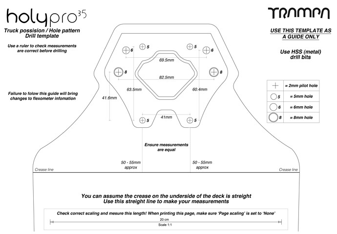

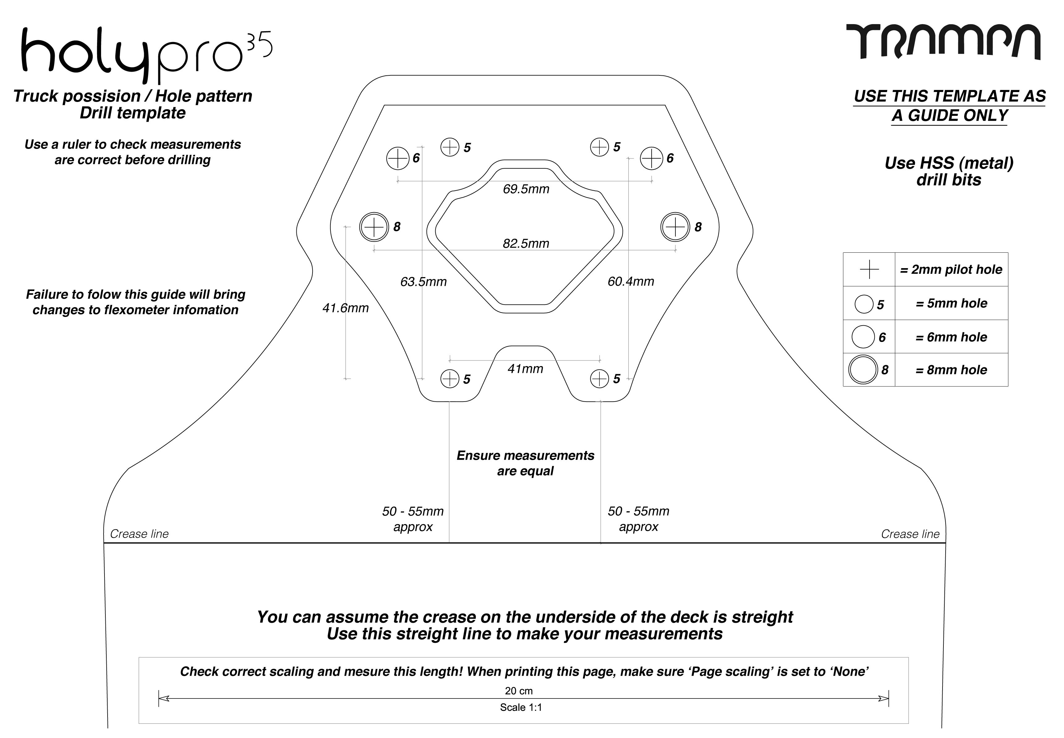

Is the Kaly bolt pattern the same as Trampa? @Kaly ?
(I’m designing an adapter for my DAVEGA since there’s a fair amount of inquiries from Kaly riders.)
