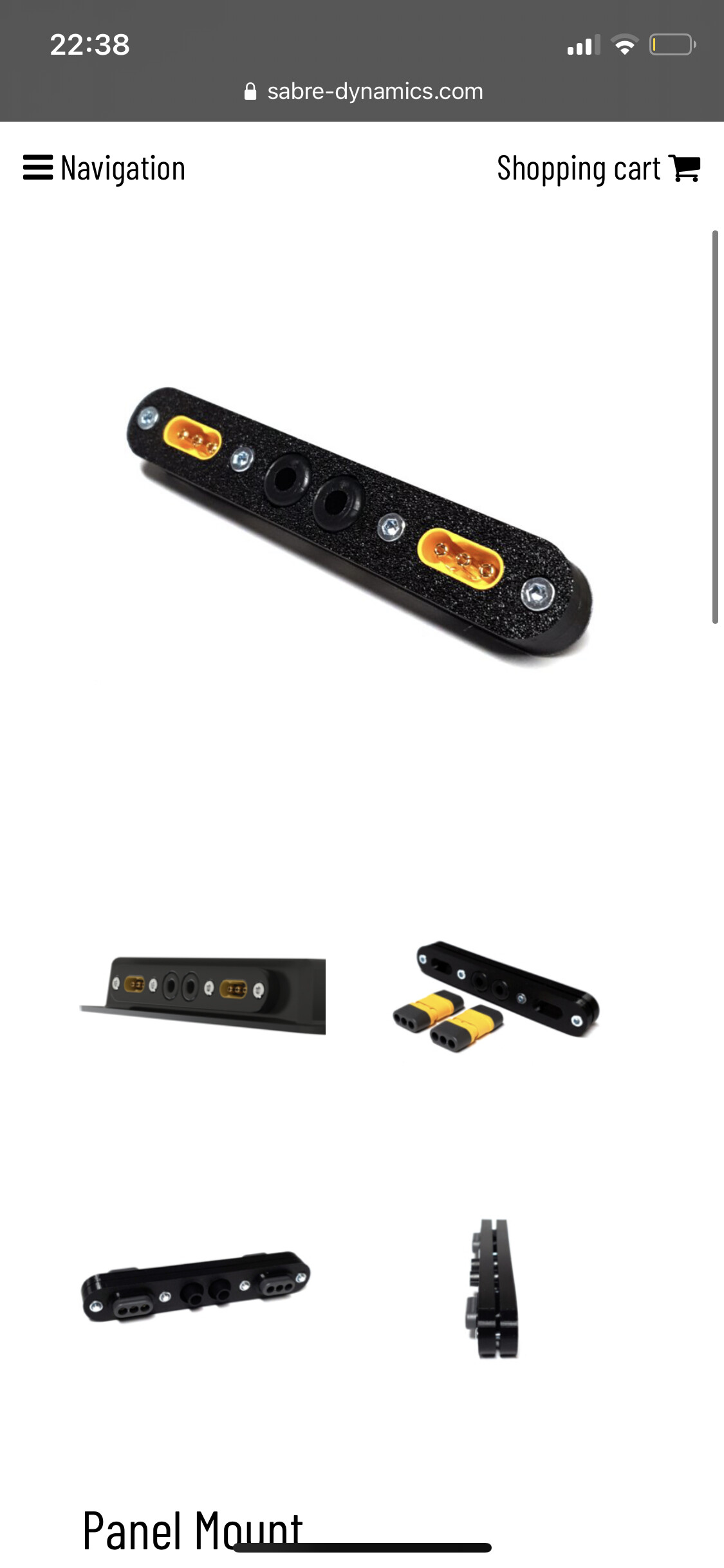

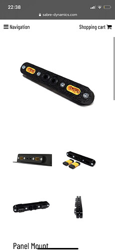

Anyone know where to get this or something similar sabre dynamics are sold out.
Briiiiaaaaaan
If he can’t help you, thingiverse might be an option (if you have a printer)
@SabreDynamics @Creavenger
