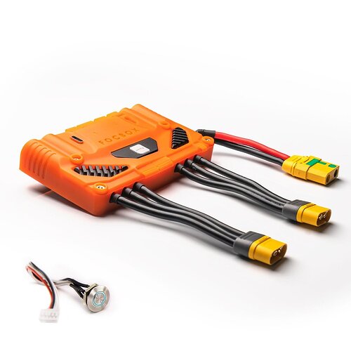

Which focbox are we talking about? 1.6 and 1.7 is near identical, just with the canbus chip fixed, the unity is discontinued, but it is still loved by a lot of people, u can get the BKB xenith, they are exactly the same just sold by better brand and u get the right connector on it.
here’s a link to the one I was referring to:

that’s the “unity+”, sold by a scammer named Jason Potter, and being resell on propulsion boards with a mark up. if u have to get one, here is the link for a better version: BKB Xenith - VESC Based Motor Controller (High Power) – Build Kit Boards
looks like its sold out atm, if u look into the used parts market, u might be able to snipe one before someone else does.

Which FOCBOX?
Version 1.3, also called VESC-X is alright. Not really recommended.
FOCBOX 1.6 & 1.7 are singles and are very, very good.
FOCBOX Unity, bkb Xenith, FOCBOX Tenka, LaCroix Stormcore 60D, and Stormcore 100D are dual-motor, single-MCU ESCs and can be run in a super single mode if needed (driving one motor with both sides). Of these, the Stormcore are physically larger.
The only thing I’d be worried about breaking on a Unity/Tenka/Xenith (collectively, “Unity”) are the antispark switches, but the ESC will still work without that, as long as you used a loopkey
