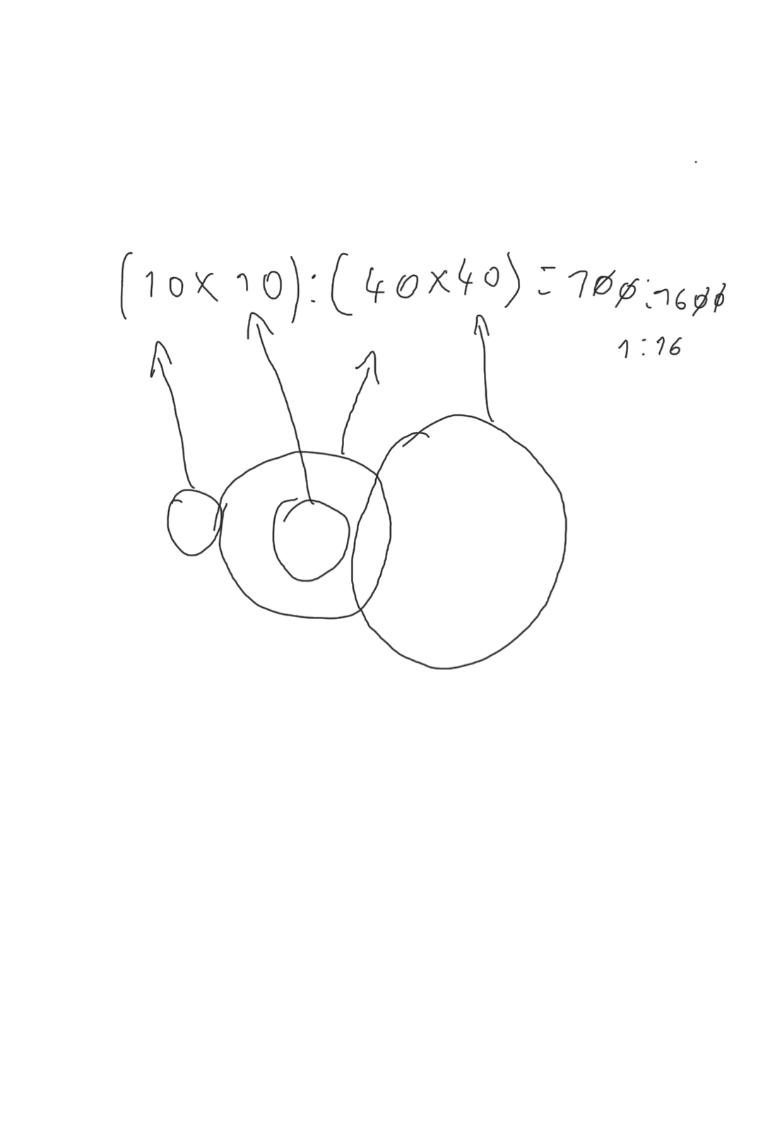

How do you calculate the gear ratio of a 3 gear drive to find out estimated top speed?

(small gear 1 times small gear 2) split by (big gear 1 times big gear 2)= final gear reduction. Simplifly till it can’t be divided anymore
Like this?

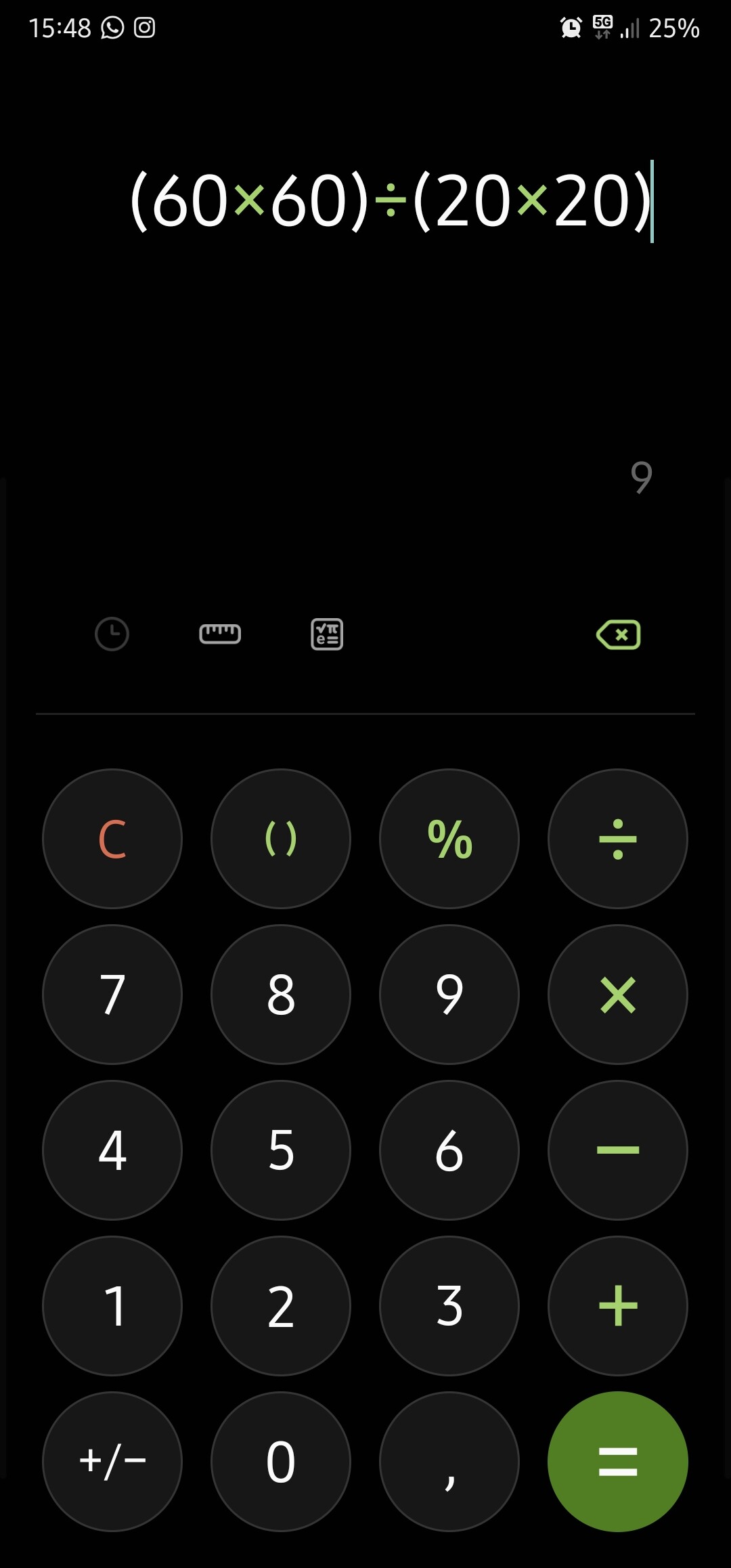

Here’s a 2 stage 20:60 (1:3) each gear ratio
Both together give 9, well, 1:9, but calculator gives me 0.(1) so he can fuck off.
If you use a calculator that gives fractions give it small/big.
If you use one that gives 0.36252936 numbers give it big/small and add 1: to it

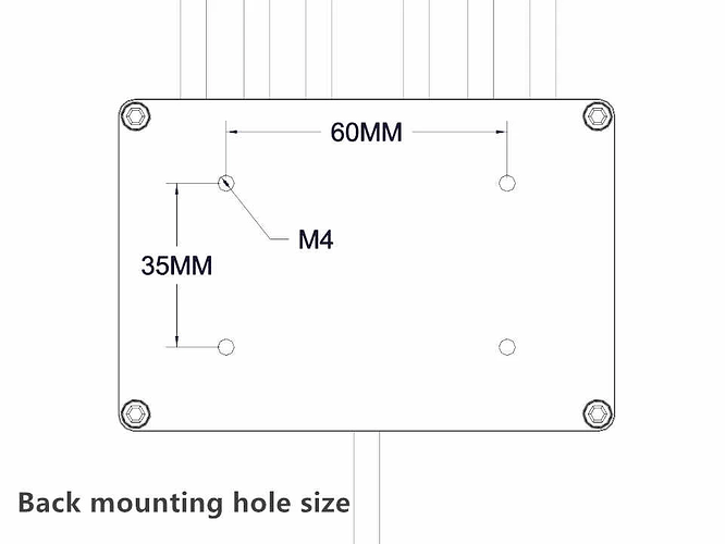

does the dv6 allow for a bottom mounted heatsink ?
yes, here is the mounting holes pattern

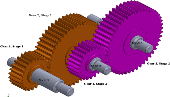

40430_2020_2557_Fig1_HTML
If you are somehow trying to determine the gear ratio of a 3 gear, as in 3 sets of teeth meshing in line, it’s just the first divided by the last. There is no further reduction happening because of the middle gear. The middle gear is either completely useless or is there to bridge a gap
I was going to run it like this
The only reason you would have the middle gear is to get the motor out from under the deck to solve clearance issues.
If gear 1 needs to move one full turn to turn last gear for a quarter (1:4), if you remove the middle gear and connect the remaining together, you get the exact same 1:4 gear ratio
The middle gear would only reduce by being 2 stage. Let’s say 40 teeth outside and 10 teeth inside. Just by connecting it in the right way you get another 1:4 reduction to the previous example for a total reduction of 1:16
Ohhh alright that makes sense, and then for a two stage it’s like this

Sorry but i’m too tired to keep track of what’s going on there. I drew this for you
(Small gear times small gear) split by (big gear times big gear) = small gears total split by big gears total. Simplify and it’s the total gear ratio right there
