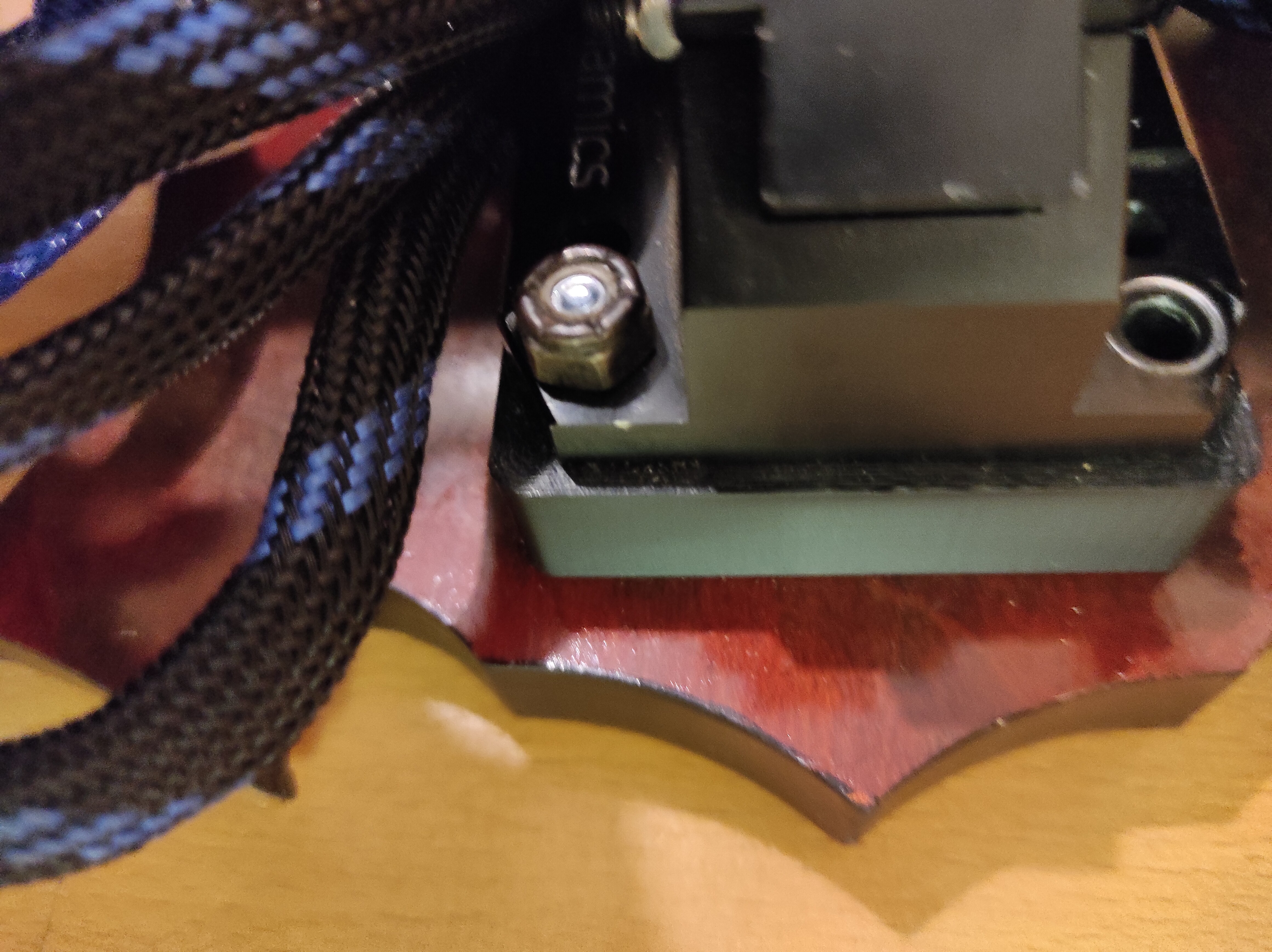

how far in does a nut have to be threaded before it is safe to use? mine are just hitting the top of the nut after the nylock
pic? but i’d say as long as the axle is through, then its fine
might be able to go a teeny bit further in
i would suggest at least it be flush with the nut
yeah ok
they can go a teeny bit further as they arent tightened to the max. also what loctite should i use on those bolts? 243?
Oh that’s normal. Parameters doesn’t really need to be messed with if it was my choice. But I would recommend speaking with someone who has theirs set up in BLDC since I’m using FOC due to having sensored motors.
I would leave them until I have more knowledge about it.
Edit: if you are using BLDC, make sure you can’t reverse your motors.
You should make that more flushed. The screw should be a bit ahead of the nylon itself for a better lock. You don’t really need loctite if you can get it flushed.
I don’t use loctite on nyloc nut, maybe I should, but i just dont. They haven’t vibrate loose, not even once as long as screw is through

i heard from people to basically loctite everything as to stop it from ever having any issues
