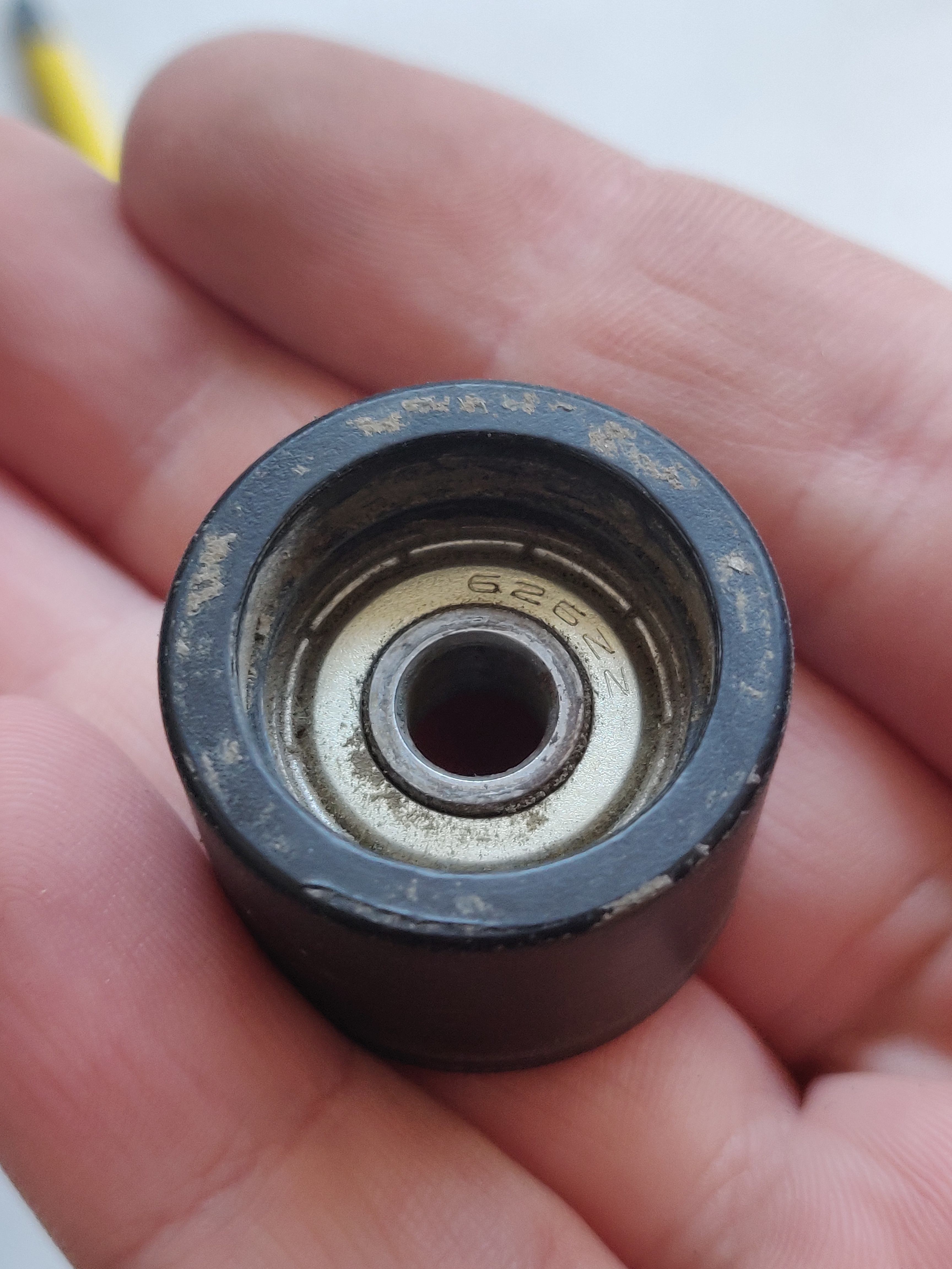

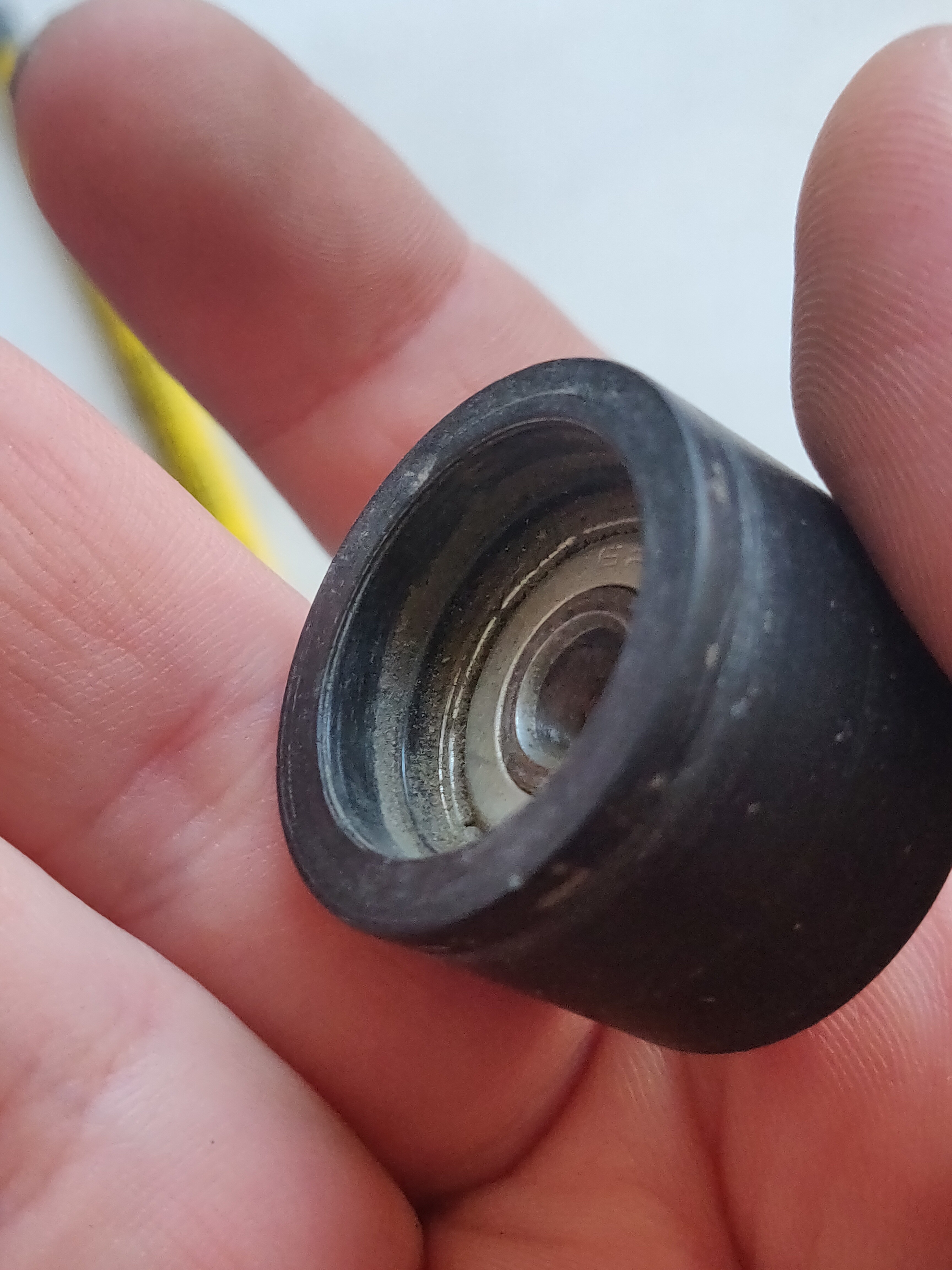

Has anyone taken the idler from @IDEA apart to service the bearing? Can’t figure out how to remove it.

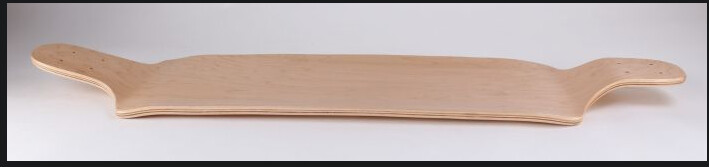

On a deck like this, the left side is the front, right?
correct
