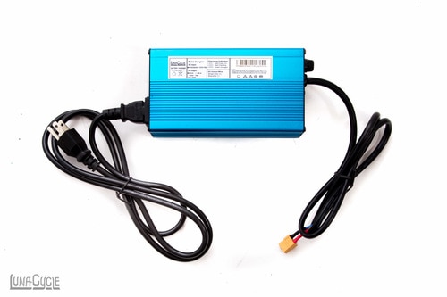

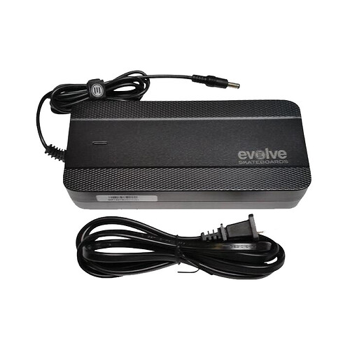

Looking for 10s charger recommendations… Looked at a few previous posts, but outside of these any solid gems I’m missing? It’s for a 10s4p.

Yeah I kind of thought so as well except for the luna cycle. Anything you would recommend that’s a bit for affordable?
Yzpower or wate on aliexpress
Gopher if you want to spend more but for an adjustable power supply
this pretty much. The Metroboard and evolve ones seem to be the same. The luna one is also your ordinary aliexpress charger from the looks.
You can get a 4A charger for about 25-35usd
