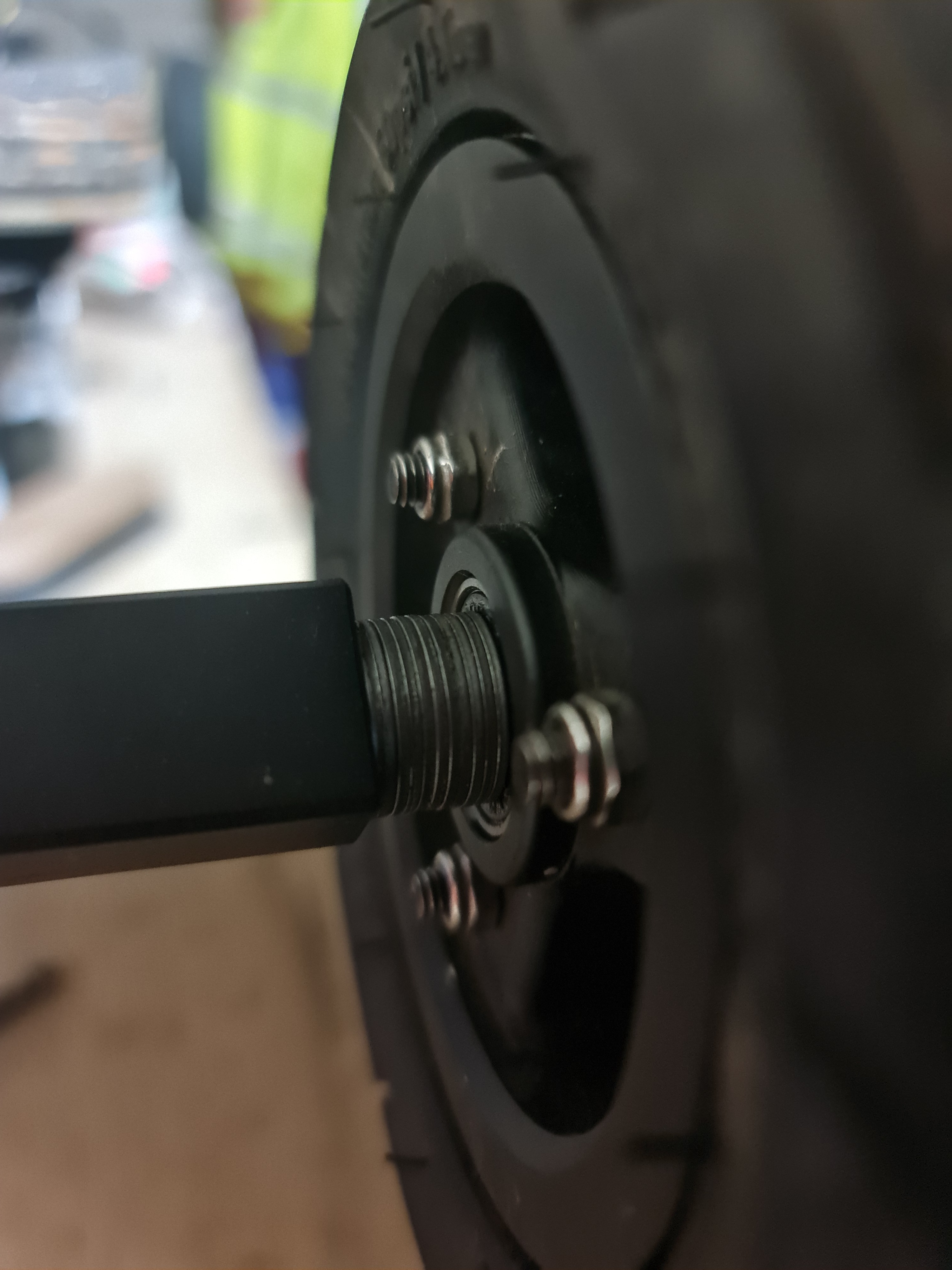

For context I have a 10-8 stepped axels. The pulley sits on the 10mm part with a 10mm bearing. Currently the pulley sits to close to the motor mount so I need to get it fixed further out.
I figure a bearing spacer would work the best.
I assume steel is the best option so that when I tighten down the wheel which will tighten the pulley that it doesn’t crush?
Yep, you tighten it down and nothing bad happens. Aluminium shims are too soft and are generally a lot harder to cut nicely, while those steel ones almost look laser cut
Keep in mind not to crush the bearings between each other when you add shims because it will mess up the bearings before you set foot on the board. Try the 0.2 shims and find just the right distance

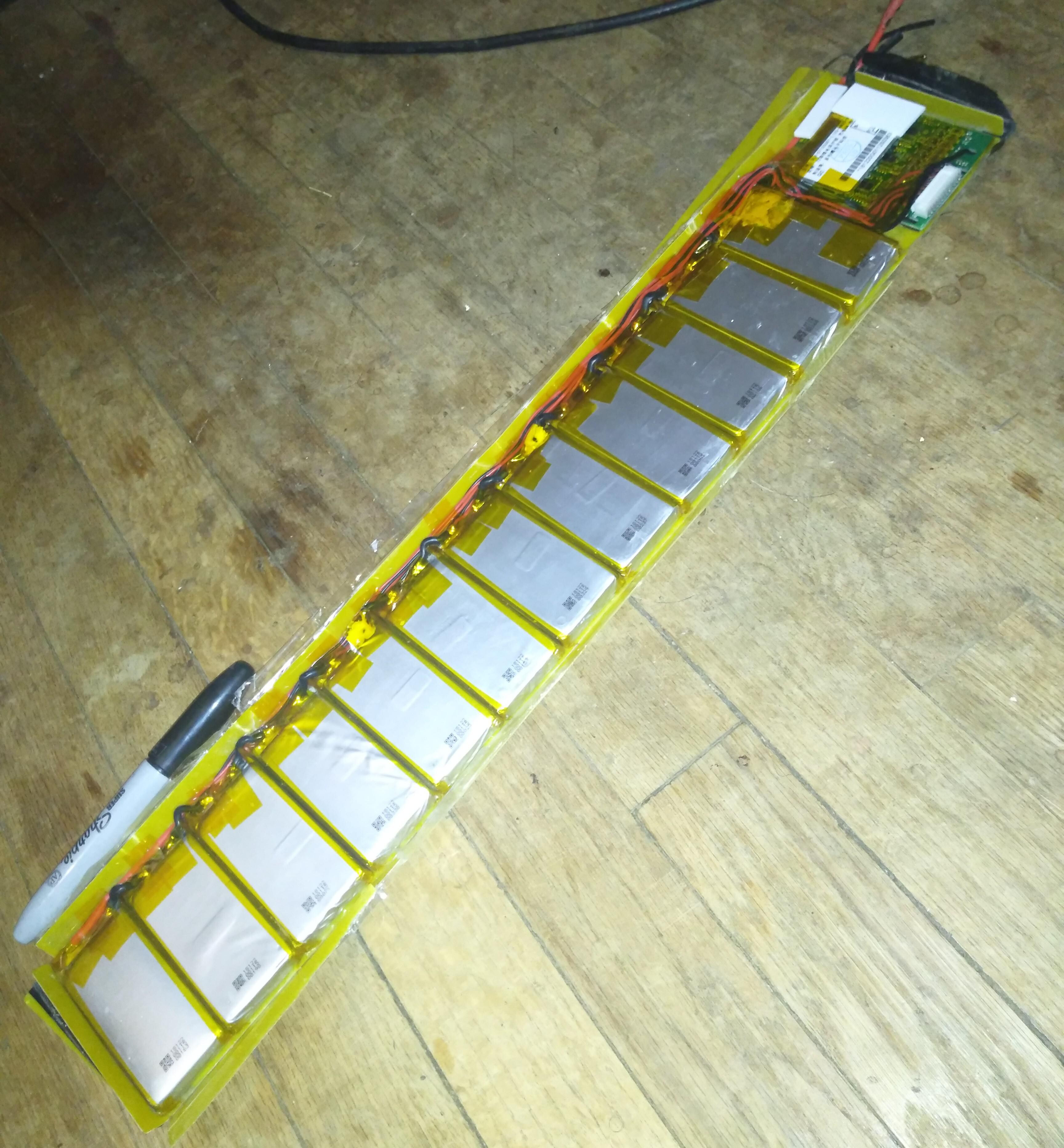

Someone in my area is selling an Exway X1 with probably a shot battery for 200 euros. He says the board sometimes won’t turn on, guessing it is the battery and/or bms.
You guys think it’s worth it to buy and replace the battery on it? Or since the exway x1 is now old, and not easily upgradeable, to not do it lol?
exway does not officially sell the x1 / x1pro battery pack tho
Sir, this is a DIY forum.
Please calm down. We will find a solution.

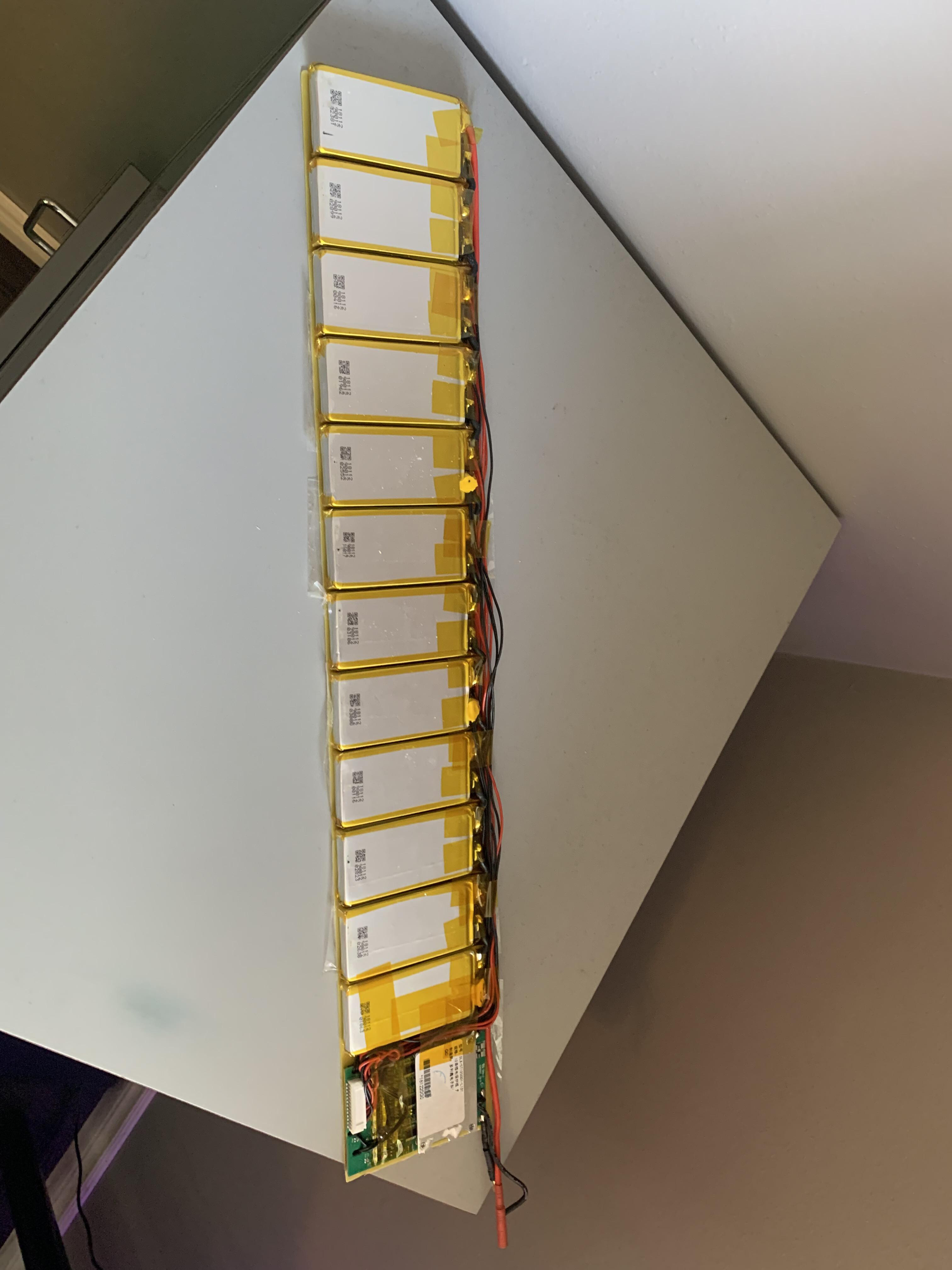

im not sure if the cutout in the X1 deck even allow 18650 cells, since the X1 and X1 pro both used super thin 12s lipo pouch packs, like this:
someone tried to mod the x1 deck to fit 21700 cells, but that reddit OP never get back with any update, i fear it may have ended badly :slightly_frowning_face:
route it or use lipos yourself?
how thick are they?
thinner than a sharpie it seems.
not sure, i can tear down mine and have a look when i have time since my x1pro is dead anyway
thin af

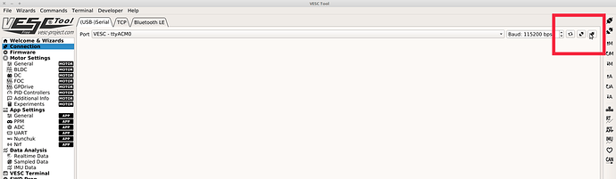

got 4 focboxes which i connected via a cable to a pc and every one of them came back saying are you sure this port belongs to a vesc
changed cable same issue. anyone know what it could be
Go into the connection tab, on the right is a refresh button, click it and the COM port should change, then use the connect button next to the refresh, instead if the sidebar.
will try
was using the variesc but changing to vesctool now
