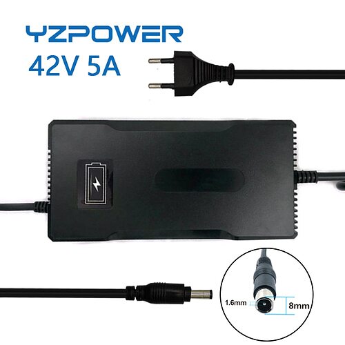

If you can wait, get one from AliExpress from a known seller like YZ Power. Super cheap, great quality. That’s what most of us have, and it what most of the chargers actually are, they are just rebranded.
€ 22,19 32%OFF | YZPOWER DC 10S 42V 5A 36V Lithium Ion Battery Charger for Li-ion Lipo Battery Desktop type fast Power Supply EU/US/AU/UK AC DC

The Metroboard and evolve chargers are the same, and they are A+. If you can afford it, i would go with those.

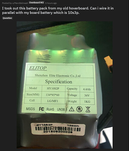

Lol he wants to wire it in parallel with his ownboard w2 battery.
Sounds like abomination and disaster

10s2p and a 10s3p with the possibility of it being a different type of battery and amp/voltage differences…
What could possibly go wrong :slight_smile:
