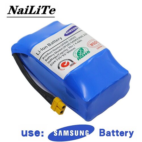

Is there a chance this is real? It’s like $40 after shipping and fees, but considering how cheap these cells are, could it be? I was gonna use something like this for an ebike for my father. It seems too good to be true, but the reviews look good… Also I don’t know how I would charge this.
US $24.75 55%OFF | Genuine 36V battery pack 4400mAh 4.4ah rechargeable lithium ion battery for electric self balancing scooter HoverBoard unicycle

They say that all the time… I would just buy a battery from trusted vendors instead of Ali tbh.
The entire motor and esc kit is like $160. Buying something from someone reputable will double the price

Those are exactly THE batteries that got all the lithium batteries banned from all flights. Exactly that same model, capacity, bms on the side. They are a massive fire hazard at best. Please do not get that thing anywhere near a plane flying towards you
ask @tinp123 to build a 10s1p p42a it wont cost much and has mroe capacity and amperage
or even a 10s2p and that has over double the capacity of that

I understand money is an important factor and I would buy cheap stuff if I know the pricey stuff don’t offer any advantages. But in case of batteries, I would be cautious. I bought packs on Ali and, they told me the cells would be one brand and installed another, the Amp rating was shit and they used nickel plated steel. Never been able to use those packs because they were rated like 20a or something.

Also, most of those cells are Panasonic cells. And not the good Panasonic either.
I dont know if they have bad intentions or just don’t think we need packs that are 60-100amp or more.
