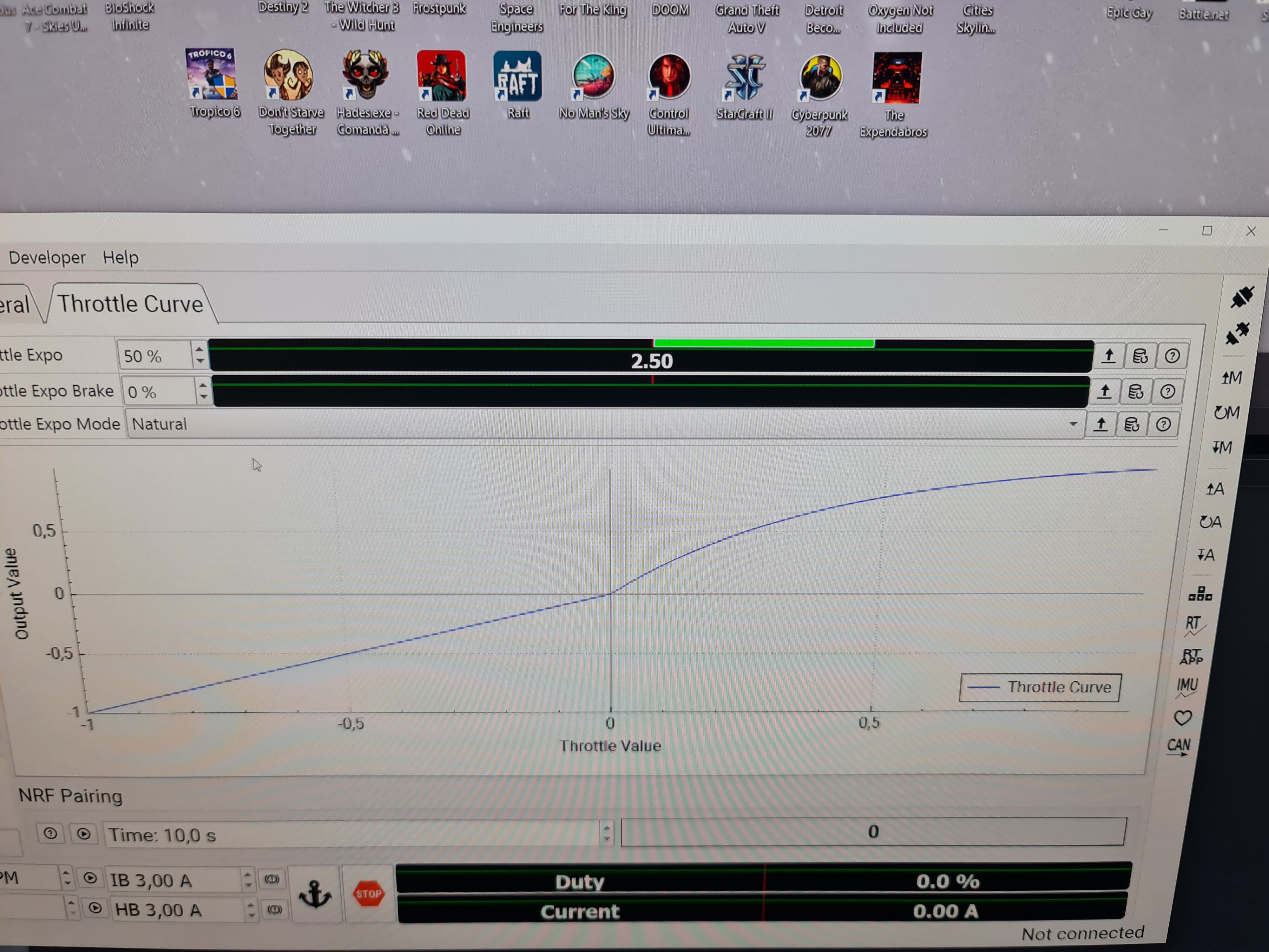

Left the motor amps at 30 and adjusted the throttle curve to +50% and the positive ramping time to 0.2.
Was on a test ride and this feels so much better now, still not perfect but much better. I will crank up the throttle curve up +75% and will try again.

+50% has 2/3 of the available power moved into the first half of the throttle range
Ok. If you say so :sweat_smile:
schlimm?
You have to know my battery packs are old and they can get me just up to i would say 30 to 35 kmh AND the motors are pretty weak. Meepo or other hubs are much stronger than the motors i use for now.
I mean, you still have the exact same power available, just press the throttle further. Also i recomment the natural throttle curve as it’s more gentle on the first milimeter of the throttle range.
If you are actually, truly getting more power out of them this way you probably have a uncalibrated remote
No not more power, but I hate to push the throttle and have to wait 2 hours the delivery happens. I want it very responsive. Works good for me.
Remote is calibrated :relaxed:

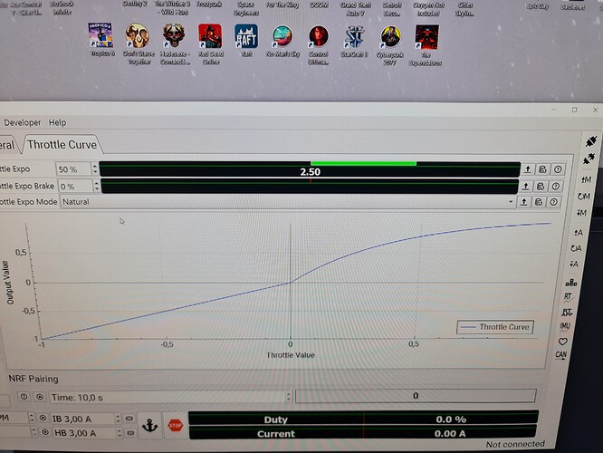

Here, i got home finally, there’s your throttle curve
You get 75% of the power at 50% throttle, which kiiinda make sense? 50%, half of the power in the upper half (25% total) gets moved in the lower half and translated into a polynomial curve.

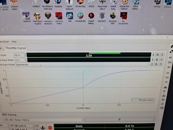

Here’s the other modes just in case you’re curious
Expo will be murder lol
