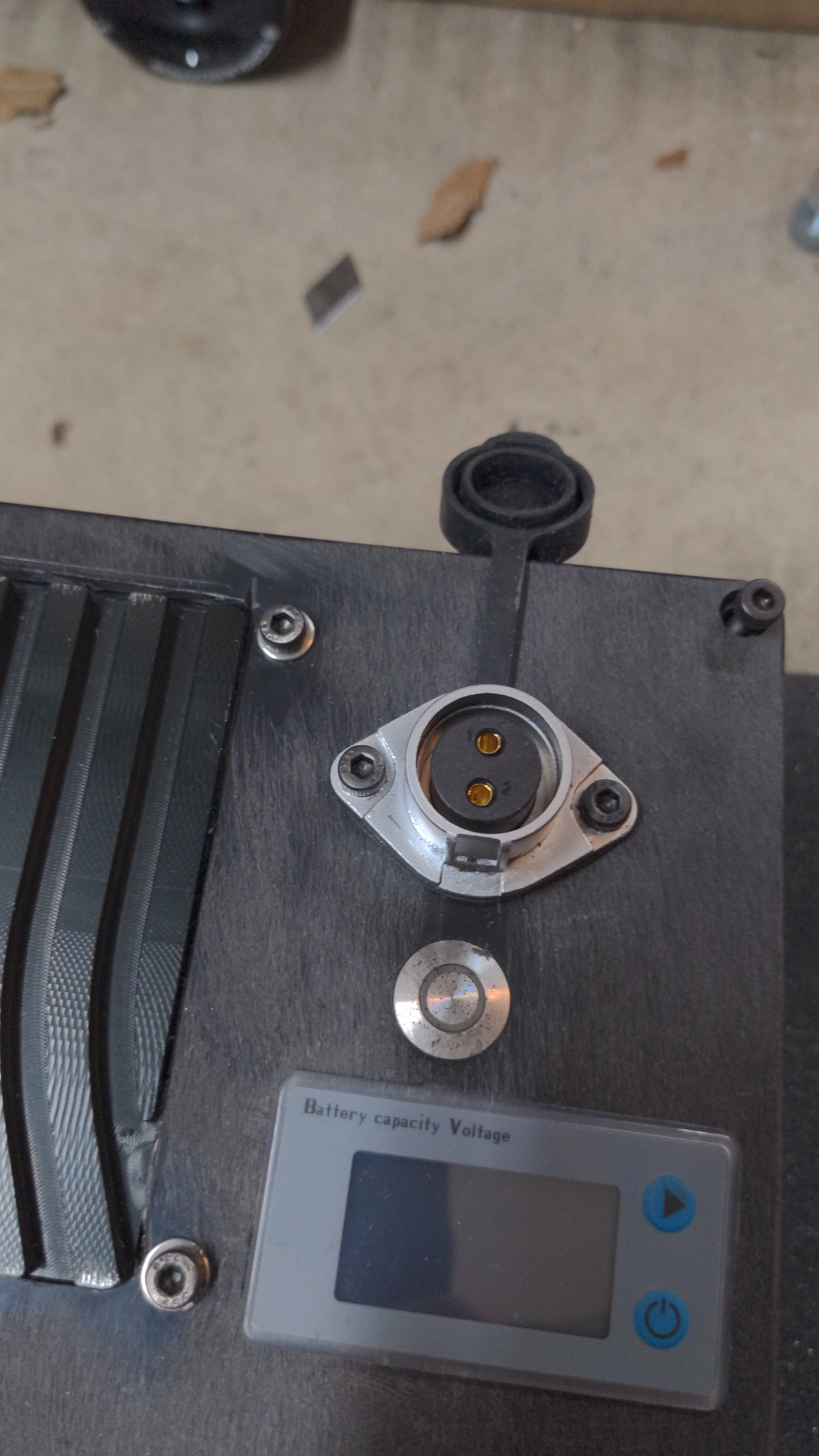

No Holes > More Holes for WR. Why give water a potential place for ingress when you can have no way for it to ingress! Plus it’s got a hinged and lockable gasketed lid, might as well use it.

I keep the balance and main charge seperate, that way i can still use a brick charger as well
Also, this way i’m not limited in charging ampacity. I think even the good ones of those balance ports are only rated to like 2a

I guess my point was you don’t need to waterproof anything if there isn’t a hole to begin with. That’s why I only have a single hole in my enclosure - so there’s only one way water can possibly go in to begin with. Sure I could drill more holes and have more outputs, but each one of them would be a potential point of failure.

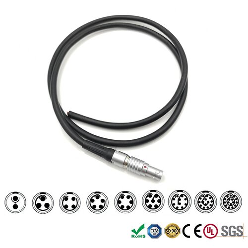

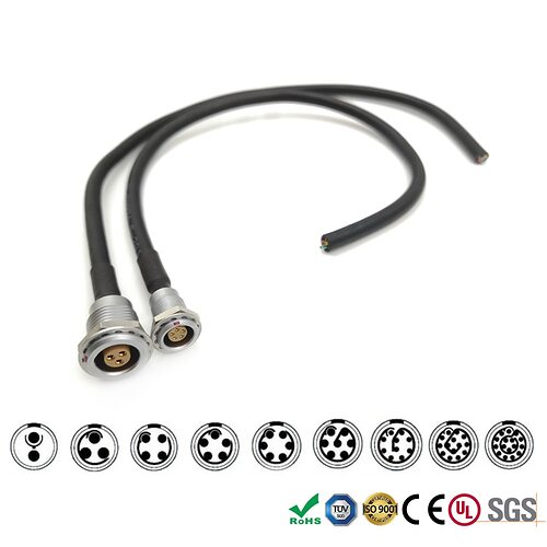

What connector is that on the left?
Egg 1B 12mm balance -
Male plug link
NZ$ 15.27 37% Off | FGG 0B 1B 2 3 4 5 6 7 8 9 10 14 16 Pin Male Plug Connector Welding Cable for Camera Power Flying Leads Cable
Thanks!
