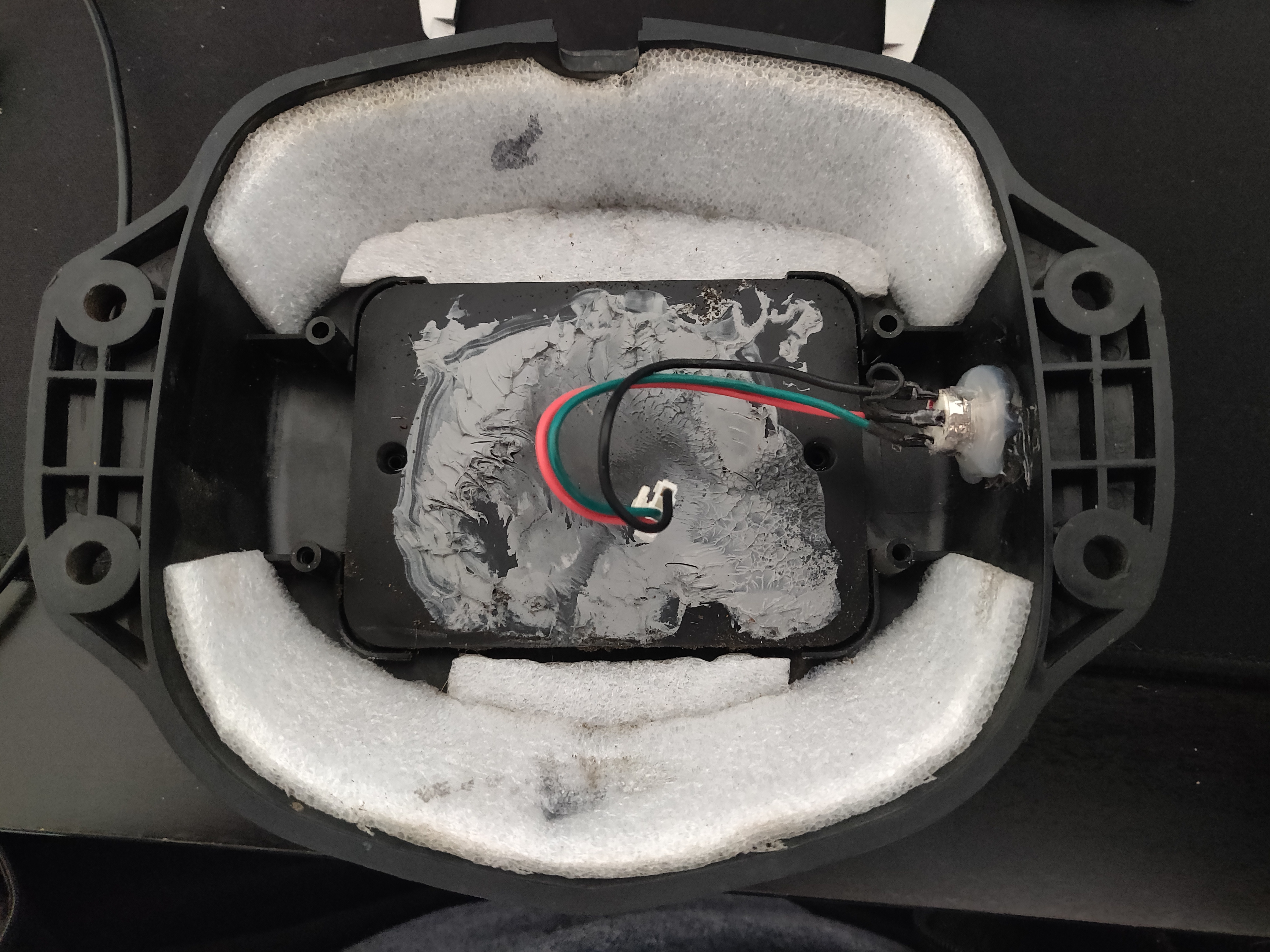

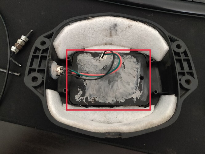

Heastsink dimensions 95x70mm
probably maker-X?
(red is the heatsink)

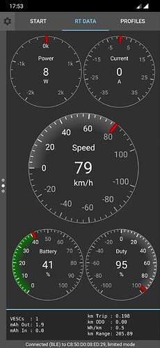

Man is the speed difference between 10s and 12s really that big?
10s i can only reach 42km/h, 12s does 55km/h (metr)
also, why does the vesc tool say top speed is 79km/h?
20 poles and DD (hub)
What app is that?
vesc tool for android
Well you’re increasing voltage by ~20%, so in theory motor RPM and therefore speed should also increase by ~20%. There’s various factors that make it more or less than that, but that should be the ballpark increase.
cool that means i didn’t even need to buy new motors since I’ll be using them in 10s anyway.
