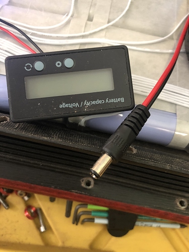

Are you sure you aren’t just seeing the exact correct behavior for a float charger? I think you are expecting the outcome of using a trickle charger but actually have a float charger, which is usually better.
If you plug a fuel gauge into the charger (without an esk8 plugged in) and it jumps from OFF to 50.4V to OFF to 50.4V to OFF to 50.4V endlessly then you have a float charger. If it goes to 50.4V and stays there, then you have a trickle charger. So find this out first.

Amazon 1.5A and diy 4A both would not charge it yesterday. Actual voltage was 48.9. Today charged up and I removed it. Just checked metr and down to 50.3. Plugged in and 4A kicked on immediately.
I guess I’d need a female 2.1 to female 2.1 to test the charger. Or maybe I don’t understand.
4A just turned off at metr indicated 50.5 and “fuel gauge” at 50.3.
It doesn’t sound like anything is wrong
Maybe not. Lol. But wouldn’t you expect either charger to work when the voltage is down over 1V?
And then it magically works today when only down .1V?

Nah sometimes they don’t kick on until it goes down a few volts

These are super-handy to have
It’s easy to make with a battery gauge, some JB Weld, a female 5.5x2.1, and a male 5.5x2.1

My gauge.
