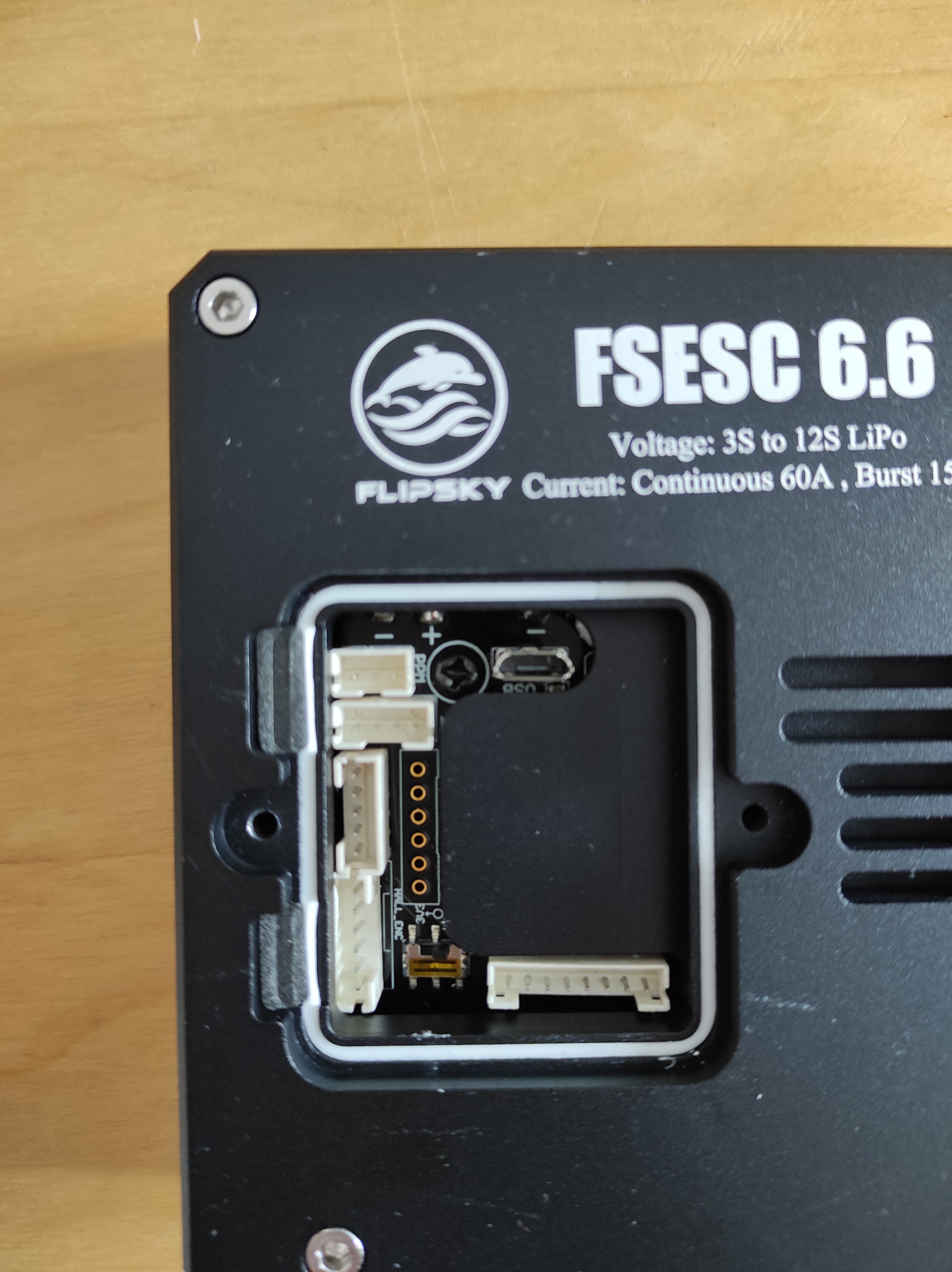

So the sensor cable and the extension have both 6 pins but the sensor cable is to small and the extension is to big to fit into the ESC.
