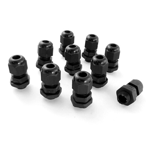

Pelicase Question: is it necessary to drill in them to use them as a monster box type thing? Presuming yes (and so also concerned about liquid getting i)
