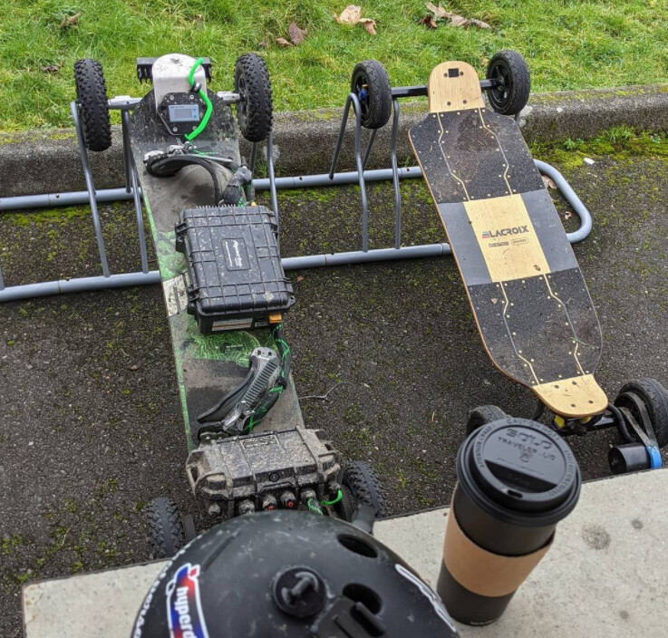

ok good, these look like a perfect solution.which pelicase are you using? (and how big a battery can fit it?)
I have a Harbor Freight Apache 1800 with 2x 6s 12A graphene lipos in it on this board:
This is the apache cases, they cheap:

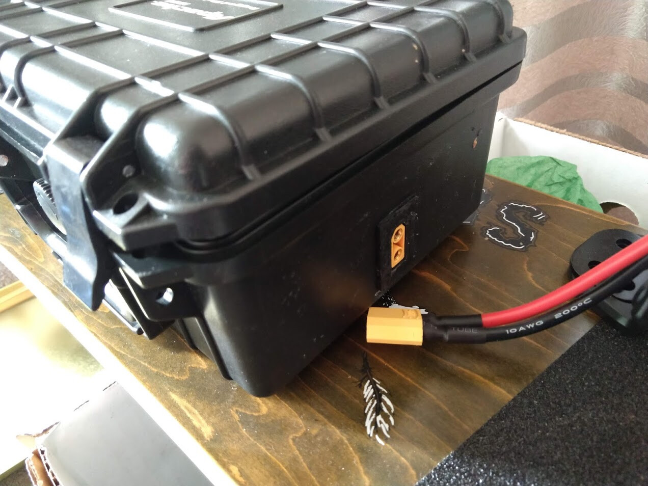

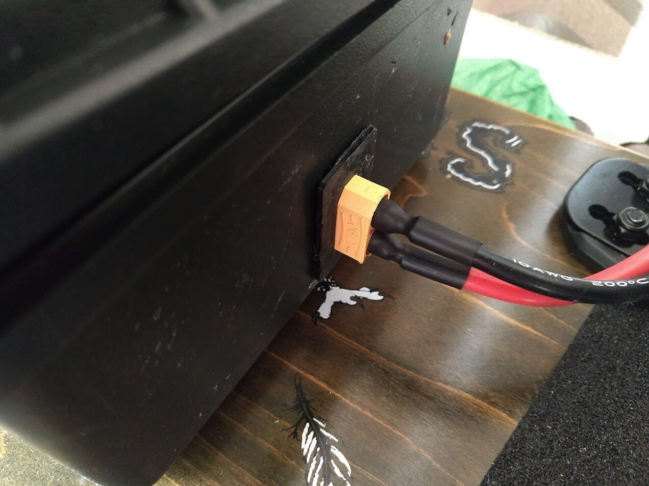

+1 on the Apache case. Got 2 14Ah Tattus in it and it’s a perfect fit. For connectors, I went with a 3D printed panel mount that was siliconed over. The male XT90 slides in, completing the seal.

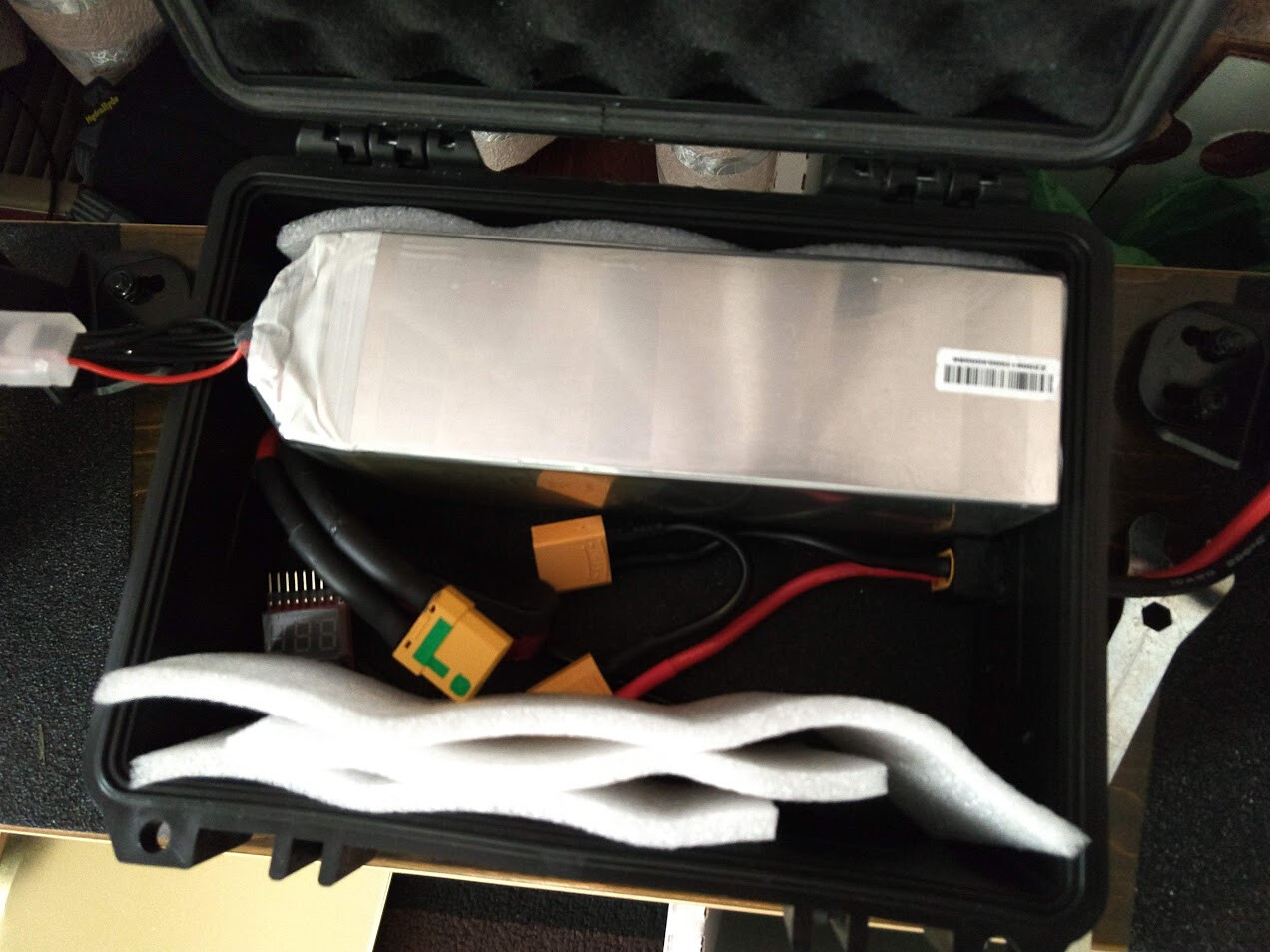

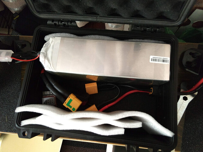

you have a pic of the inside?
Also looking for a battery case
One of the battery’s currently charging, and I use it for storage while batteries are out, but here it is with one of the batteries in place. Wires go through the center, and just imagine the other battery is on the other side with all the foam and lights and allen keys.
