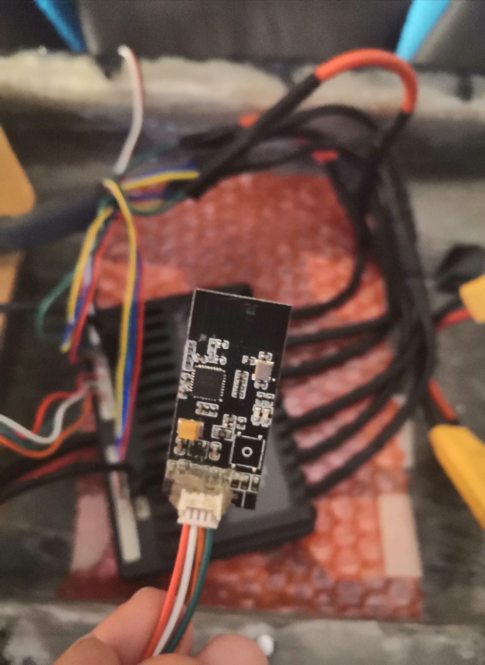

Any clue about how to set this Bluetooth module up? Baud is at 115200, vesc is set to PPM and UART, RX goes to RX and TX to TX, it is flashing exactly like a VX1 receiver if it isn’t connected to the remote. However VESC tool mobile cannot see it’s signal. Swapping TX and RX doesn’t help either.
hm thats weird
i tested before i sent and my phone connected
other then tx and rx is everything else in the right position?
if it still doesnt work send your paypal (in a pm if you want and i will refund) sorry about it not working man
Yep, 5V and GND are in the right spot too. Np, I send a PM.
