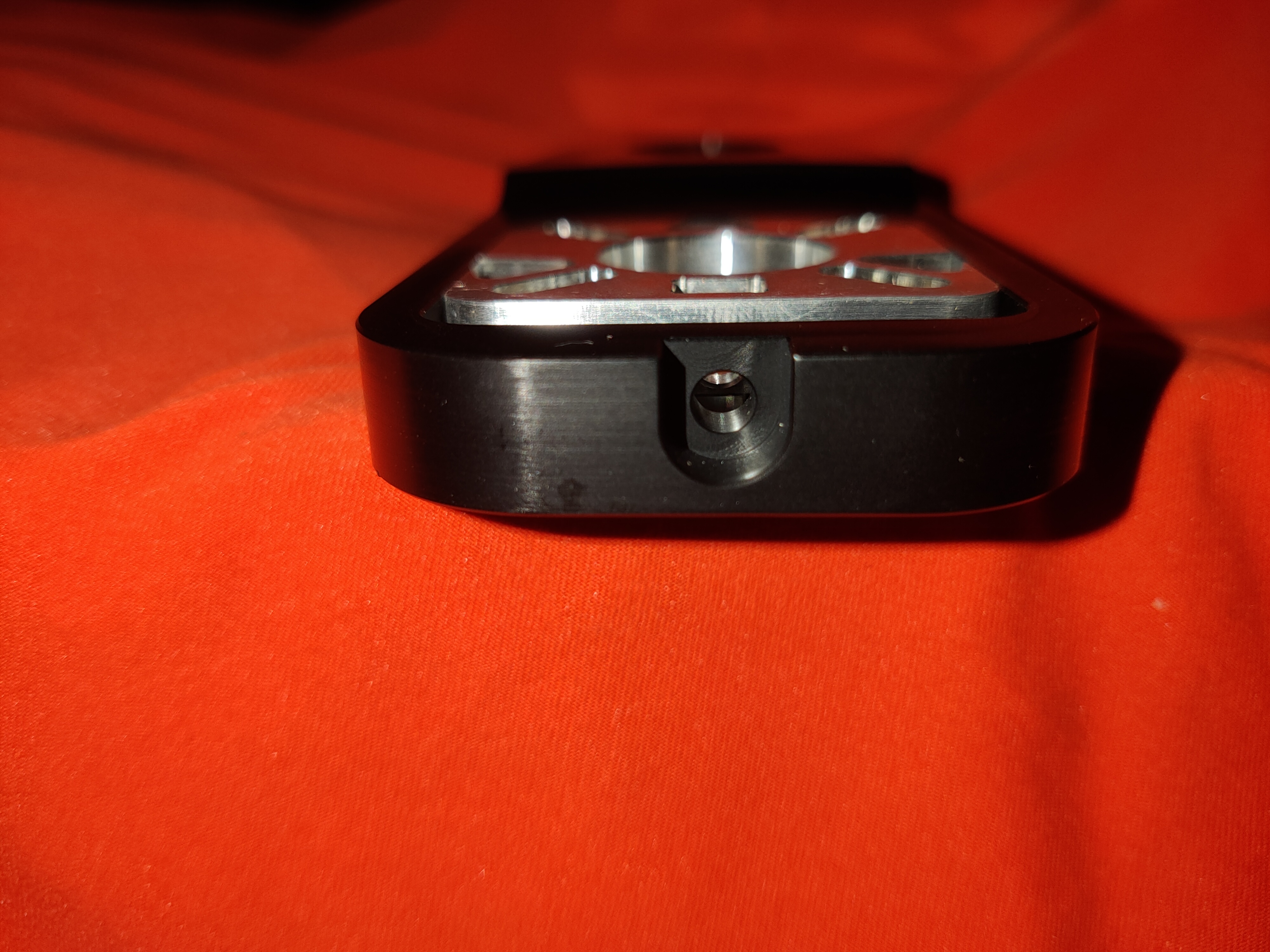

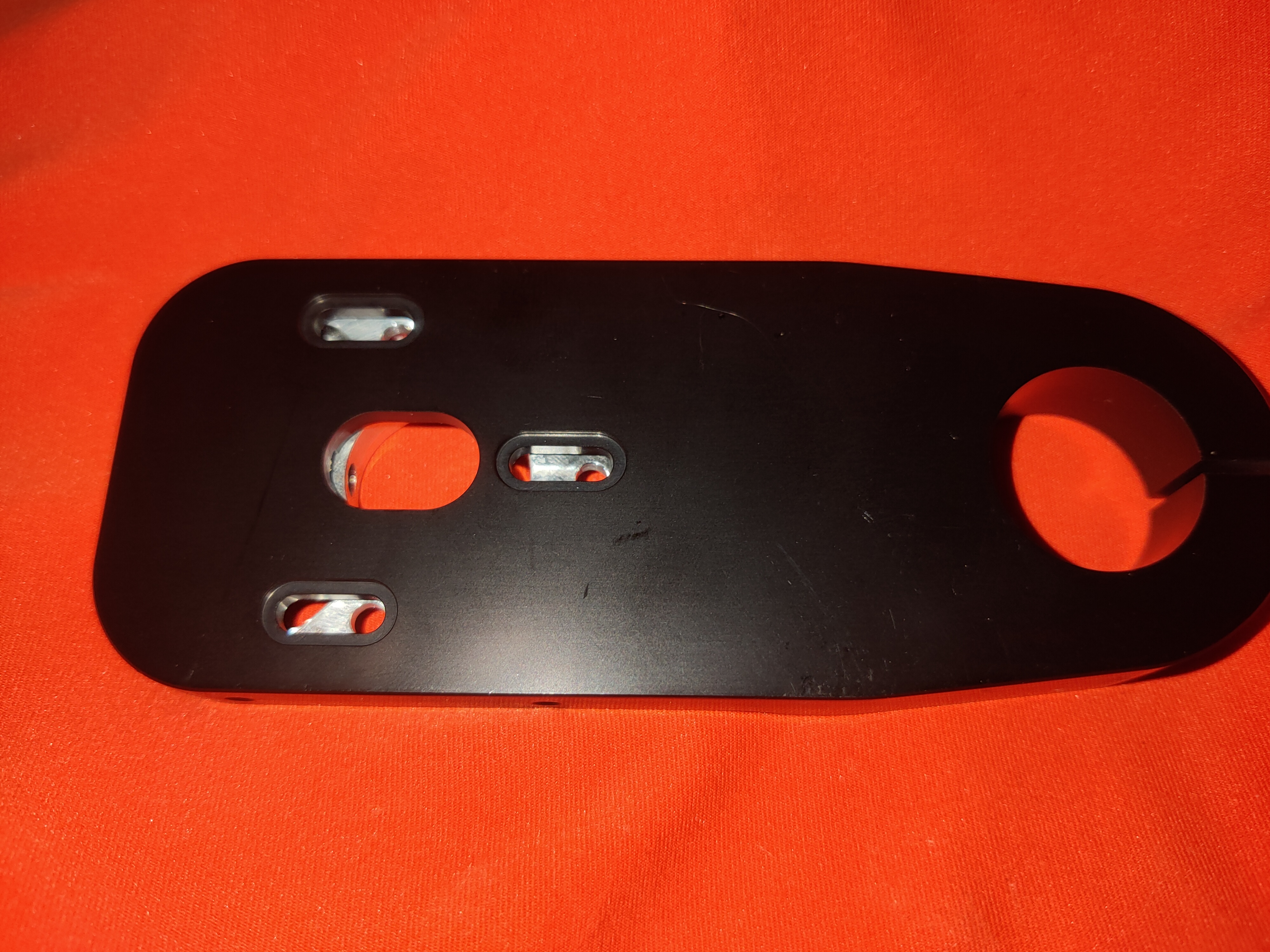

It is, but there’s a bolt that you can turn that brings it in and out. So with just snug motor bolts, you can turn this adjusting bolt, see the belt tensioning, and make fine adjustments.
It’s a huge help.

Can you take a picture of it? I think I know what you mean but I’m not sure
Hang on.
I backed it out so you can see better. The motor is attached to a plate, which can be moved in either direction by the bolt.
So tightening the bolt by the phase wires moves the motor directly? Damn that’s awesome!
Yup. Here it is on all sides:
Bonus photo:
Damn that’s cool, how does the mount not rotate though?
