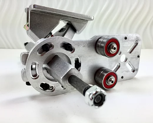

That’s why I’ve always loved the Haggy adjustment solution.
I’ll just go for mounts with idler in the future lol
Skipping on non-idler mounts. If I full throttled on my old board I could make the 14t skip teeth. 15t works great though, especially with idlers
I used them on everything until I got the Haggy drives. I own three sets now. :joy:
What are y’all talking about? I’m curious, let me see
The best belt drive solution in esk8 IMHO.
21c75f_f771b6da7ff74ab9b1dcc97c446abe80~mv2_d_3264_2448_s_4_2
↑ Motor Mount with dual Idler
I was a bit confused until i got to the hangers. That belt tensioning/adjustment is perfect

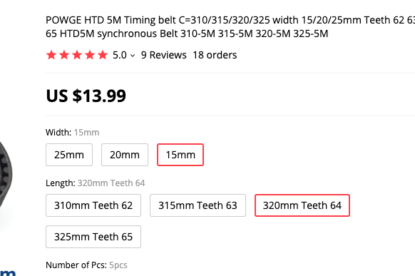

…just on some labyrinthine belt emporium…what belt length do people reckon i should use for 15T/40T that DOESNT have an idler (using DH street mounts)
Screenshot 2021-01-28 at 19.20.24
Can you measure the distance between the motor axle and the wheel axle for me?
Edit: assuming it’s in the 70-75mm range, you want 285~295mm belts
about 9cm
Best thing to do is mount the drivetrain, then take a measuring tape and wind it around the same way the belt goes. Then you just read off the length.
ah yeah, of course lol. thanks
No, i need exactly to the mm, centre to centre, and to know how far on those rails you got the motor too
