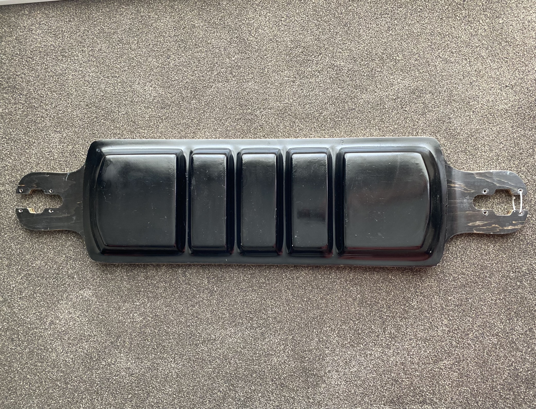

Hey me too, 12s6p p42a 4wd Hummie planned.
Not planning to route deck.
3p groups and escs in end compartments
2p groups in each central one :ok_hand:
